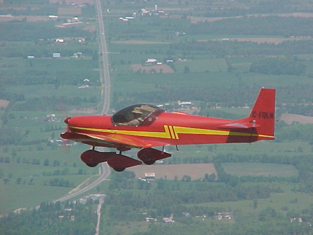

Posted: Sat Sep 04, 2010 5:44 am Post subject: 601XL fiberglass wingroot fairings |
Att. is a pic of my 601 with the fairings - not a closeup, but you can see them.
Dave Austin

naumuk(at)windstream.net Guest
Posted: Sat Sep 04, 2010 5:54 am Post subject: 601XL fiberglass wingroot fairings |
Dave-
Did you re-paint your plane?
Bill
| | - The Matronics Zenith601-List Email Forum - | | | Use the List Feature Navigator to browse the many List utilities available such as the Email Subscriptions page, Archive Search & Download, 7-Day Browse, Chat, FAQ, Photoshare, and much more:
http://www.matronics.com/Navigator?Zenith601-List |
| Back to top |
daveaustin2(at)primus.ca Guest
Posted: Sat Sep 04, 2010 9:23 am Post subject: 601XL fiberglass wingroot fairings |
Bill,
That is an old picture. Re-painted off-white three years ago. I think you saw it.
Dave
