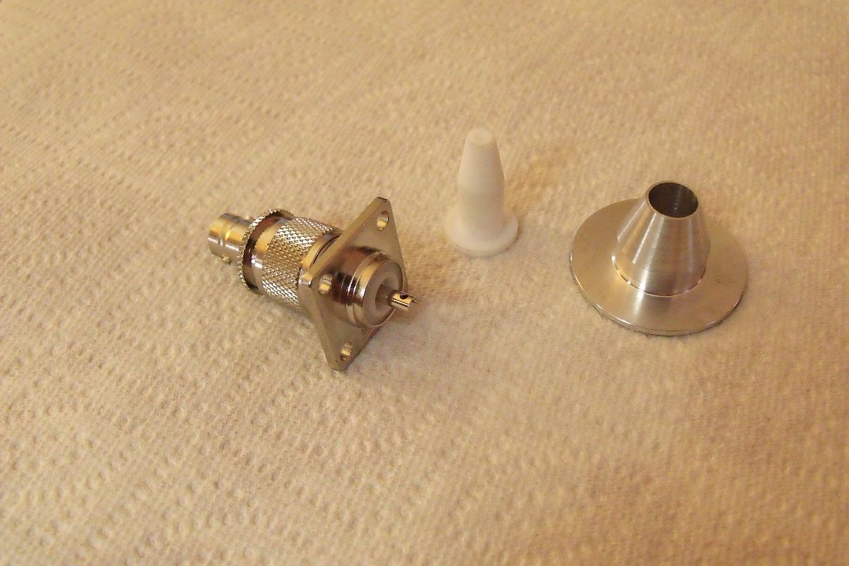

I fly to enough fly ins to make having a radio a nice convenience, so over the summer I've been putting together an inexpensive system for Zulu Delta. I looked at all the handhelds available and the cost of accessories. I looked at Sporty's JP 200, the Icom A6 and the Vertex 220. At $170 the Vertex won hands down. That it came with a headphone adapter (for which Icom charges $80) was icing on the cake.  At first I tried using the VOX feature of the radio but the lowest sensitivity setting wasn't enough to resist the noise put out by the 582. I found a generic push to talk switch at Mypilot.com for less than $15.
I looked around for antenna ideas and found a chassis fitting (pn 278-201, $3.69) at Radio Shack that looked like it had possibilities. I also bought an adapter to use a BNC cable (pn 278-121, $4.99) and a 6' BNC cable (pn 278-964, $7.49)  The chassis fitting was meant to put an antenna cable fitting on the back of radio but I turned it around and soldered a piece of 1/16" brazing rod into the wire socket. It probably wouldn't hold up for long by itself so I turned an aluminum cover and a teflon insulator to give the rod some extra support (see photo). The antenna needed a ground plane but there was no room for one where I wanted to mount the antenna so I used the aluminum frame for my nose hatch. Not perfect but it works just fine. The last thing I did was trim the brazing rod at 22" for the middle of the aviation band (+/-).
And speaking of working. My first flight with the radio installed I picked up the ATIS at Mid Continent at 300' from Cherokee Strip (26 miles). At 1000' I called the tower for a radio check. The controller reported a little noise otherwise I was clear. This last Friday night I tuned the radio to 122.8 for another check. At 1000' I could pick up aircraft in the pattern at McPherson 75 miles away. I listened to them while turning my aircraft to check reception from all aspects and could not hear any degradation even when the signal was coming from the rear.
So for less than $300, including headphones, I have radio communications in my Kolb.

I'm glad you got a good radio system built for your Kolb. It makes a huge difference in situational awareness in and around populated areas. Nobody cares what brand radios we have. If it works well then it is a good radio.
I bought an SP-200 many years ago and its reception was good and the nav feature was a but saver for me on one occasion but I did not know it did not have a side-band when I bought it. Since then the transmit side has quit working but it still receives well. But the lack of side-band was enough to make me wish I had bought something else.
Last year I purchased an iCom A-6 for $239 from MarvGolden.com and that included the headset adapter and 12-v power plug. Right out of the box it sounds nearly as good in my Slingshot as the iCom A-200 did in the much quieter Allegro. Connected to the Kolb antenna makes no difference in the sound quality but increases the range a good bit, I pick up pilot chatter from airports I've never heard of, which means they are quite some distance from my local area.
