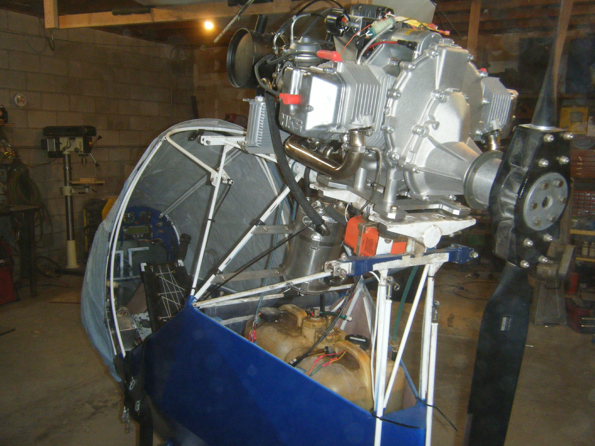

My configuration is a 3.47 gear box mounted up, and a borrowed 68" 3 blade warp set to 17 1/2 degree pitch. There is plenty of room to install up to a 72", but I'm trying to get the most speed and compromise climb. any input would be appreciated.
Tom,
Here is my installation on a Fire Star II. I have a Warp 2 blade 66 inch Prop. You might talk to Jerry Olenek (at) Green Sky Adventures since he has installed a HKS on a Slingshot prior to mine.
mail(at)greenskyadventures.com (mail(at)greenskyadventures.com)
Larry
[img]cid:E929A592BF804319A9BAD9AF8C3A5C74(at)larryPC[/img]

The only thing that I would worry about is the higher thrust line. Mine with the HKS and a 66 inch prop climbs when I give it power rather than cause me to hold up elevator. Mine is trimmed to 5300 and 5800 gives me about 200 fpm climb.
Your plane, your choices!

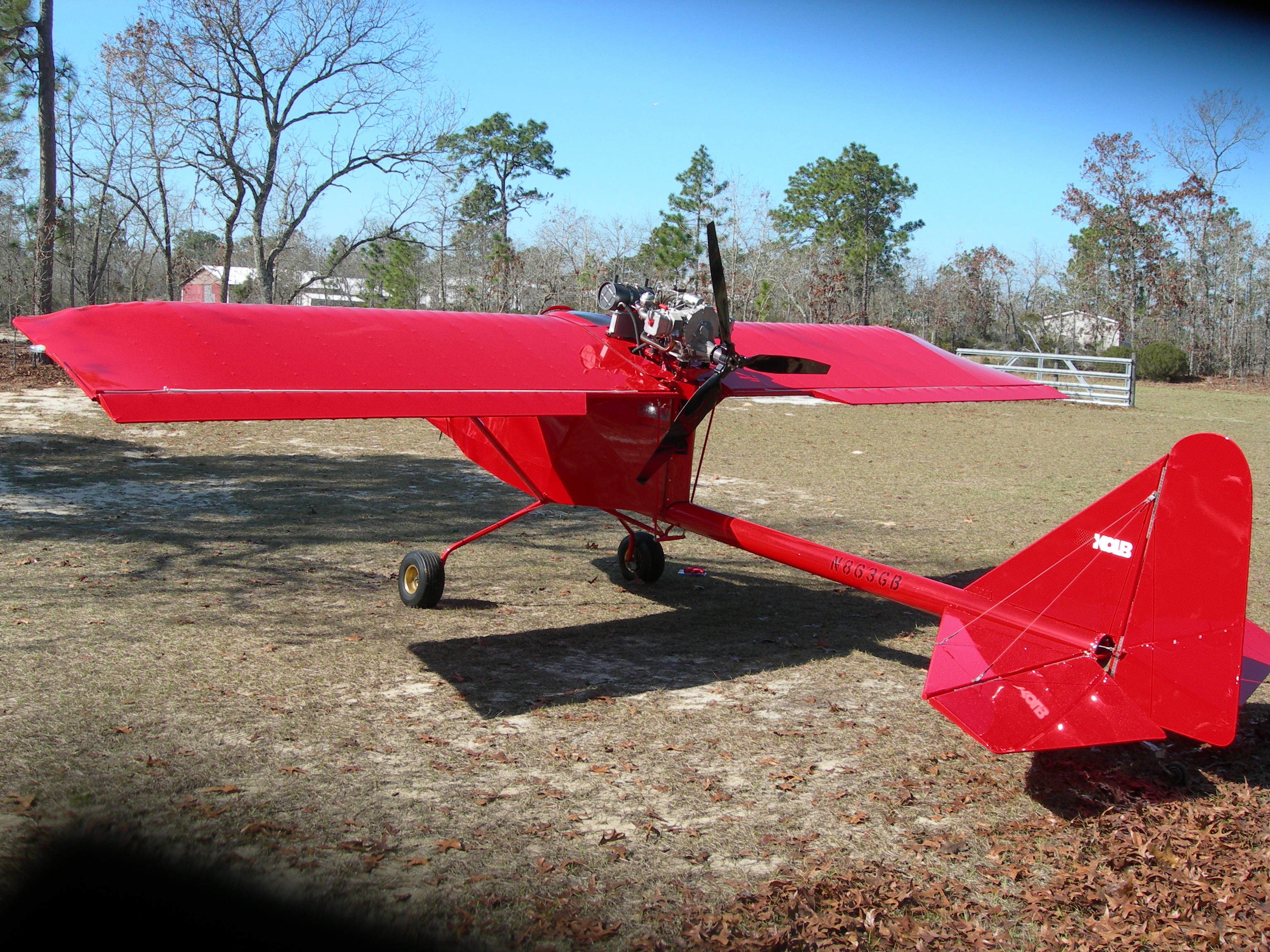

I am in the final stage of installing a HKS on my Slingshot. My question to those that have done it on any Kolb are, what gearbox ratio, and is it installed up or down, and what prop type and size are you running. My configuration is a 3.47 gear box mounted up, and a borrowed 68" 3 blade warp set to 17 1/2 degree pitch. There is plenty of room to install up to a 72", but I'm trying to get the most speed and compromise climb. any input would be appreciated.
Thom,
Here is a link to Jerry Olenik's report on flight testing an HKS on a Slingshot.
www.greenskyadventures.com/EnginePricing/HKS/Kolb/image.htm
I watched Jerry fly this Slingshot around the pattern in January of '08 at his home field in Forida. It performed fine, and Jerry goes about 210 lbs. or so. I don't see why your Slingshot should perform any differently with the HKS.
I had Jerry install an HKS on my Firestar II in July of '09. I've got 140 hrs on the engine and have had no trouble with it at all. My FS II weighs 435 lbs. empty no fuel, and 750 lbs. or so w/ me, 13 gal fuel, & some gear. I get a 550-700 fpm best climb rate on average. Mine has the 2.58 gearbox and a 66" 2-blade Powerfin prop.
Good luck with your project -
Jimmy Young
Missouri City, TX
Kolb FS II/HKS 700
Jimmy Young
Joined: 24 Nov 2007
Posts: 182
Location: Missouri City, TX
PostPosted: Sun Oct 03, 2010 11:49 pm    Post subject: Re:Re: HKS & Kolb Reply with quote
Tom,
After looking closely at some photos I took of Jerry flying the HKS powered Slingshot, I noticed the N# is 863GB. That would be your plane.
I guess the guy you bought it from removed the HKS for some reason. Well, at least you now know it's had one on before.
