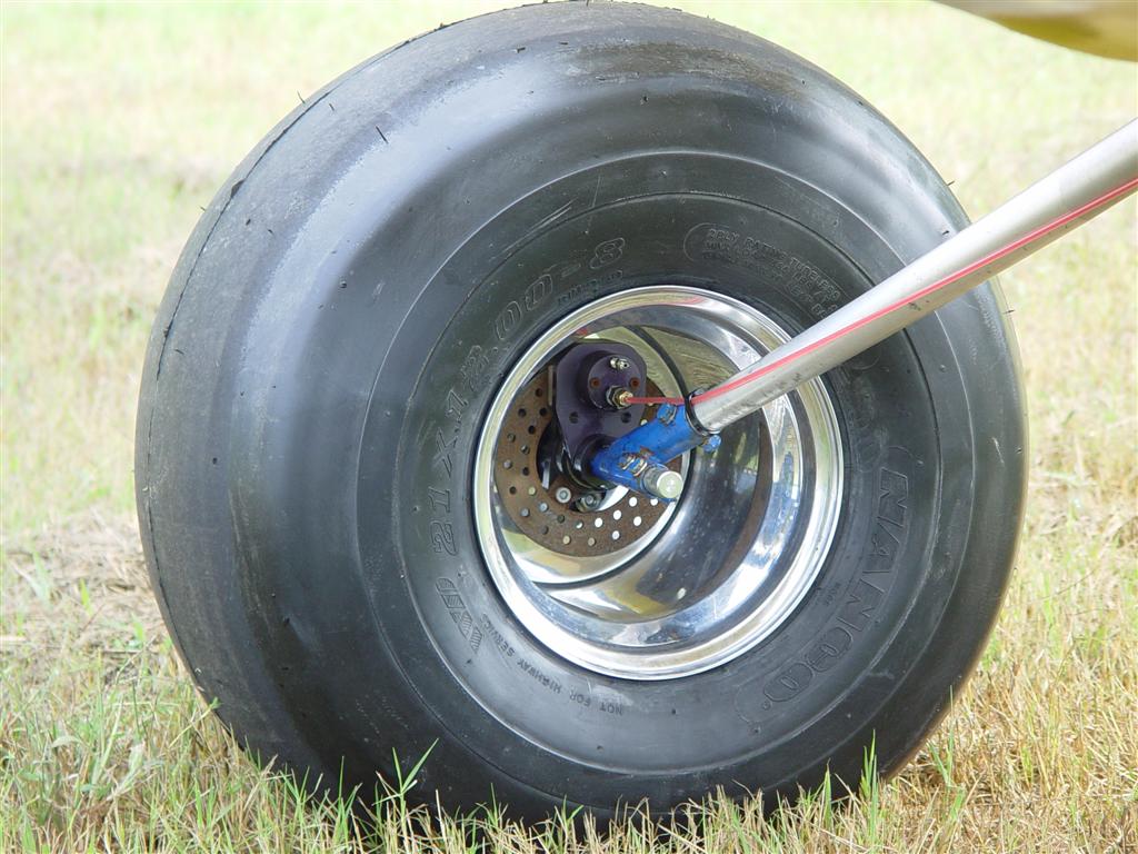

This a 6 Year Old could do..... You take the Black Max Axle and install the woodruff key, then you slide the Caliper onto the axle and when directly over the woodruff key you tighten a set screw that is in the bottom of the caliper...... After that you remove the Kolb's Axle and slide in the Black Max Axle.... Then you drill two holes that secures the axle like the Kolb axle was secured..... Joe
Here is My Black Max Set-Up
The Wheels are custom made for me, for these Tundra Tires

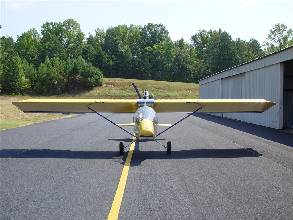

Here is a Picture of my Kolb Firestar II with a different set of Wheels on the Black Max System...... If you buy extra wheel hubs you can change both tires in less than 5 minutes.... You remove a cotter pin then unscrew a Nylon lock Nut using a Ratchet and 15/16" Socket. Put the different set of Wheels on, replace the one nut and cotter pin, and your ready to Fly.... In this Picture I have 8" rims that have standard DOT approved Radial Trailer Tires... .. I use this set-up when I am using the paved Runway.......... When I am on a Grass Strip it is back to the Tundra Tires.......... Joe

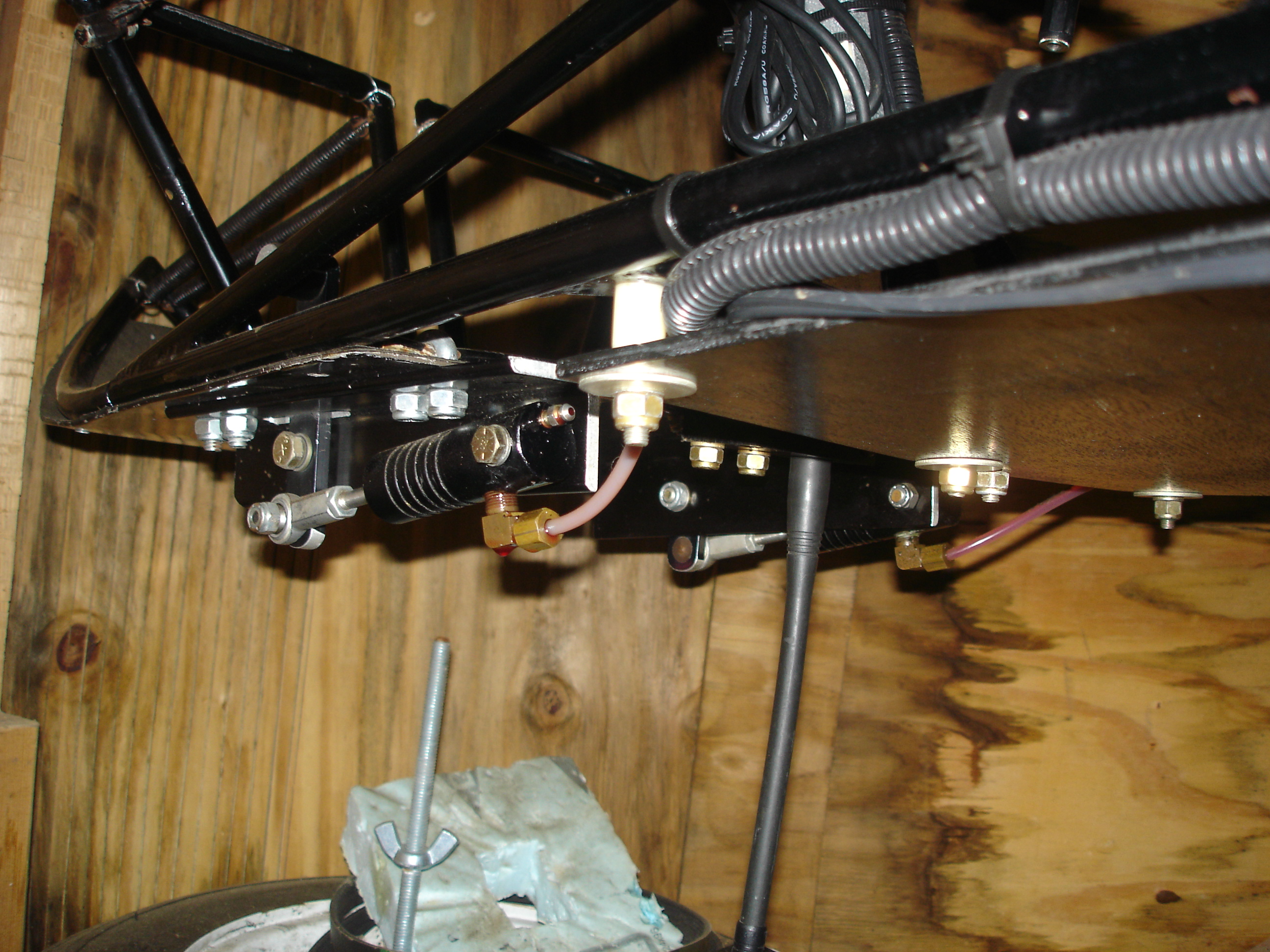

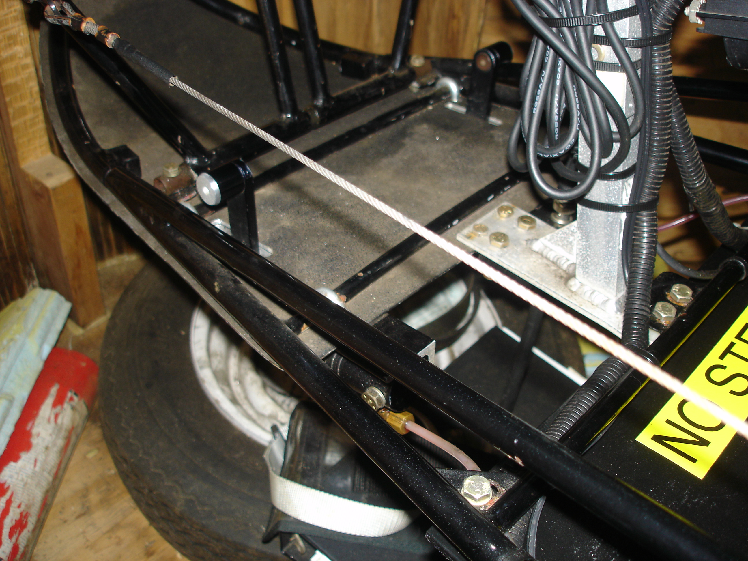

At 08:24 AM 10/9/2010, fs2kolb(at)aol.com wrote:
Did you attached the master cylinder to the heel brakes or do you use a handle brake?
I would like to see pictures of the heel brake setup
Here's a couple pix of mine, on my UltraStar. These are Hegar, not Black Max, master cylinders, driving the Black Max calipers.
Had a bit of trouble with the brakes today. Went out to fly, taxied out to the runway, and the left brake pedal went to the floor and stuck there. Taxied back to my trailer, and it was a good thing, because contrary to the forecast, the winds suddenly picked up and started howling, gusting to 20, which is real nasty on this hilltop airport. Anyway, turned out the master cylinder was scored, not sure why, probably a bit of crud got in it. Took it home, honed it out and replaced the o-rings, went back and spent some time bleeding the system... and the caliper bleeder screw stripped out, Grrrrr... took it home and managed to tap it out for a larger bleeder screw, but not before sunset. Oh well, hopefully tomorrow will be better...
-Dana
