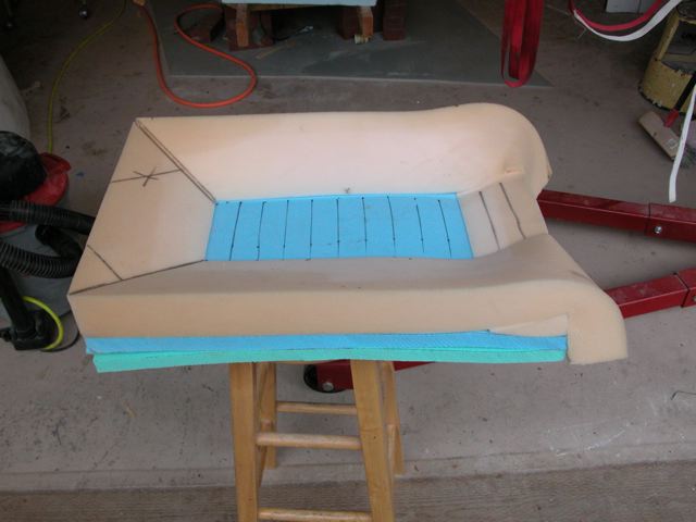

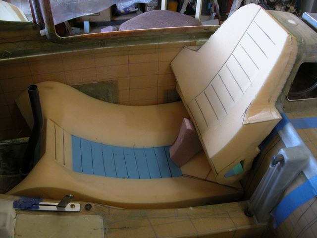

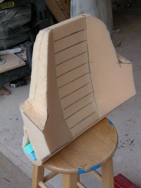

I used a combo of memory foam and med. density upholstery foam. I'm 6-1", 190#. Seat cushion is 1" green "crash" (very dense) memory foam + 1" blue memory foam + wedges of upholstery foam. Seat back is but 1" uphostery foam + wedges, rolled over as shown w/ memory foam inserts for lumbar supports. Seat back will be velcrowed w/ straps going down backside of CM...it's pictured w/ a pink foam temp. support. Seat cushion is 18" x 23.5" and extends forward of FG thigh support, but remains clear for full movement of control stick.
This really feels comfortable for my bod, particularly w/ the wedges and the forward thigh supports.
I did have, however, a major hiccup when I took it to an uphosterer who wants $400/cushion...way above budget...but thanks to youtube, I believe I'll be able to do a credible job of making patterns and sewing it up myself...wish me luck!
Fred
