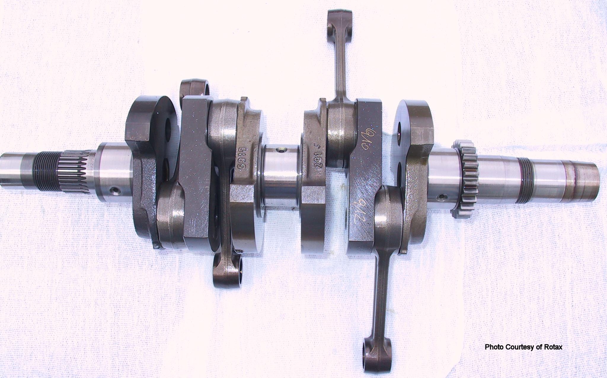

912 crank shafts are not one single piece of metal but units press fit
together.
Apparently, prior to the introduction of the slipper clutch in late model
gear boxes, prop strikes caused a rotation in the press together junctions
of the 912 crank shaft, which could not be detected by measuring prop
shaft flange "run out" at the gear case or crank shaft flange "run out".
Maybe 10 percent of 912 prop strikes result in crank shaft rotation,
primarily in older pre slipper clutch engines, and if not detected these
result in engine failure.
Crank shaft internal rotation has probably gone undiagnosed in many 912s
after prop strike. And my bet is prop strikes may not always show up in
logs, so buyers of used aircraft should probably ask questions if they
find indications that a prop or blades ahve been replaced.
I understand that Lockwood Aviation in Sebring, Florida can measure
internal rotation within the 912 crank shaft caused by prop strike.
Anyone having better information, or direct field experience on this might
want to chime in. My info is NOT from direct experience, but from what I
know to be a very knowlegable source.

How do you figure the crank is composite ? Having held it in my hands it
is
made of metal like every other crank. It just comes as one
piece(including
the rods) and yes it can fail like every other engine crank.
Dick Maddux

If you have a prop strike there is a procedure to follow. It isn't hard, but will tell you if you have further damage and absolutely needs to be done because you will not see the hidden damage with your eye. The procedure is in the maint manual under special checks. The gearbox needs inspection and the crank needs a run out check which can be done right there on the plane. The full amount of damage will also partly depend on whether you hit the ground at full throttle or at idle and depends on what prop you have on the plane. If you have a prop strike do the maint and be done with it. It will require a gearbox inspection and a run out check on the prop flange and shaft. You will be paying for a new oil shaft seal and a bearing. If the engine has a number of hours on it most likely 3 new bellview washers, too. About $160-$200 for all. If you really tagged the prop flange or bent the prop shaft add another $650. Thank God for the clutch because that will usually protect your crank. This is the perfect scenario about keeping you engine up.
For those that use 100LL all the time then you really need to pull the gearbox by 800 hrs. and send the clutch in to have all the lead paste removed because that will keep it from functioning correctly or even keep it from working at all.
If you have a strike I can do the inspections.

Dick, Speaking of that English language bugaboo, did you mike the crank, i.e. check it's size with a micrometer, or indicate the crank, i.e. place a sensitive (resolution of .0001" or .005mm) dial indicator on the nose of the crank and check for runout as the crank is rotated? The latter is what is required after a prop strike, while the former is a nice to do but doesn't really tell you much unless there is evidence that the taper on the crank nose or the mating surface of the drive gear is damaged. See the Line Maintenance Manual, Section 5-50-00 "Unscheduled Maintenance" pages 3 and 4 and the Heavy Maintenance Manual Section 72-00-00, 3.18, pages 95 and 97.
See the Line Maintenance Manual, <<
Rick
I just returned from vacation and was too pooped to talk let alone type! Too many errors.
No,a dial indicator was applied to the crank to determine the runout and it was fine, gearbox check will be next.(will use the manual as a guide)

I've always thought that a prop strike caused the "New Engine" light to come on in the panel.... Wink
Couldn't you tell if the journals had been twisted with a timing check? I.e. with a dial indicator put into the SP hole and a protractor on the crank?
Unless it was a new engine, I always figured a prop strike put you in the neighborhood of a new engine cost-wise anyway, so down to the bank... with a gun... Wink

Lucien, all, I don't think we're talking anything more than a few thousandths of an inch of twist out of register in the crank before significant damage happens to the main bearings. As you look at the crank you can see that the front and rear main bearing segments each carry a rod journal and the center main bearing segment carries a rod journal on each side. Connecting those three segments are essentially just plates. Now refer to Rotax table of limits for measuring the crank. First, it's done at the magneto drive end of the crank, not at the gearbox end and the 100% wear limit is only .0007" ( 7 ten thousandths of an inch ) over the maximum allowed for a brand new crank. Without splitting the case, what assumption would you have to make about any given movement of an individual crank segment? That movement most likely occurs at the plate connecting the crank nose and the center segments? Or does it reflect through all segments equally? For simplicity let's say all movement happens at the plate between rod journal 1 and 2 so that you get a reading of .0034" at the mag end and to further simplify all movement happens on rod journal 1. Even if you had a perfect, zero spec crank to start with, you are only talking .0017".
Measuring something at the top of the piston you'd have to decide how much, if any, variation could be accounted for by piston rock, wrist pin wear, rod journal wear, and rod bearing wear just to name a few. You could drive yourself nuts trying to factor in all those sources of measurement error, much less finding sine tables with enough accuracy to get measurement values and we haven't begun to think about movement caused by environmental factors not even related to the engine. Is the moon in the wrong position? Tide out or in?
Okay, I'm kidding with the last, but you get the idea.
Just to illustrate how difficult fine measurements like these can be, I have a precision level that I only use to set the bed of my engine lathe. It is so sensitive that the bubble will measure a change when I take a step. I cause the concrete pad on which the lathe sits to flex and the bubble moves. I don't drink coffee on the day I'm going to use it.
