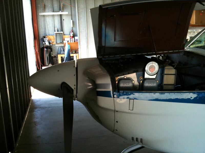

Plane #2: (Cheetah)
2 shims upper right. 1 shim lower right. No shims on either of the two left mounts.
left rail: 2.5-3 degrees up
right rail 2.5-3 degrees up
left engine: 2.5-3 degrees up
right engine: 2.5-3 degrees up.
The distance to the spinner was: 39.75 inches.
Bottom line: the engine sits about 1 degree down.

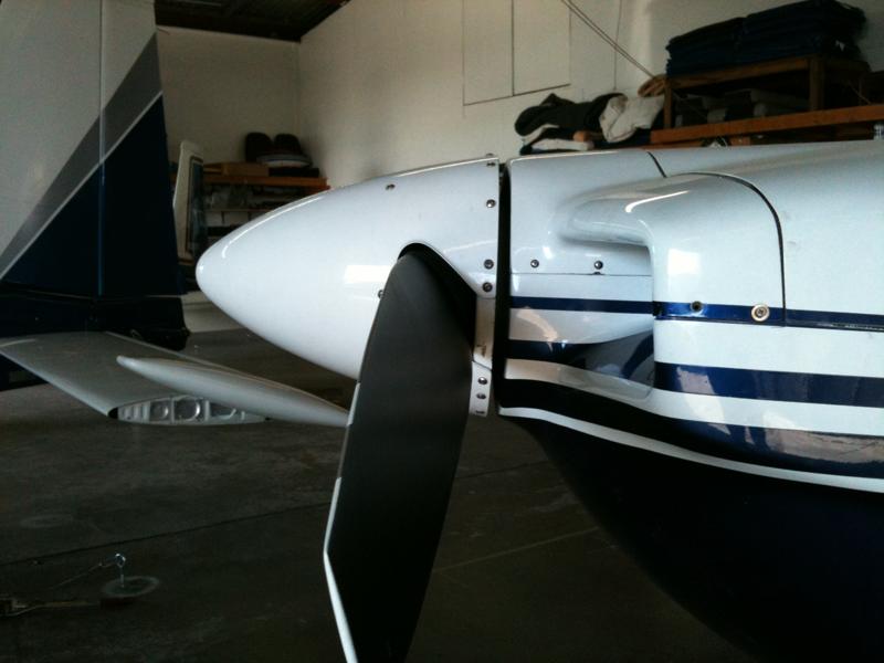

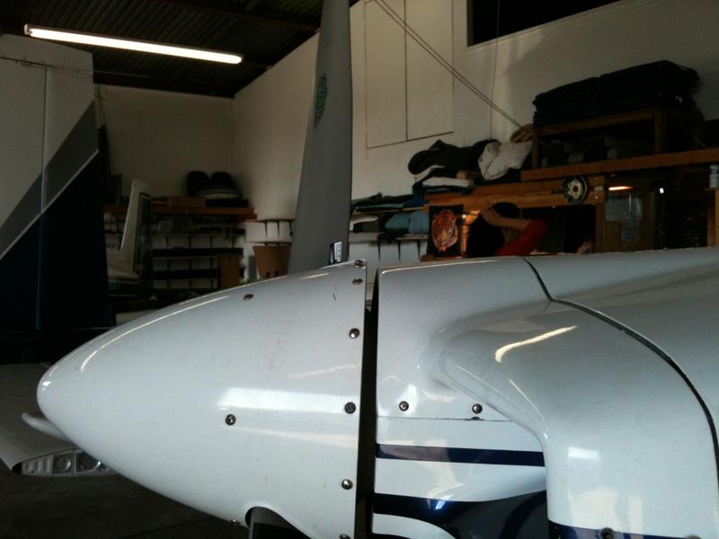

I've included a pic of this. The engine needs a 1/2 shim on the bottom mounts

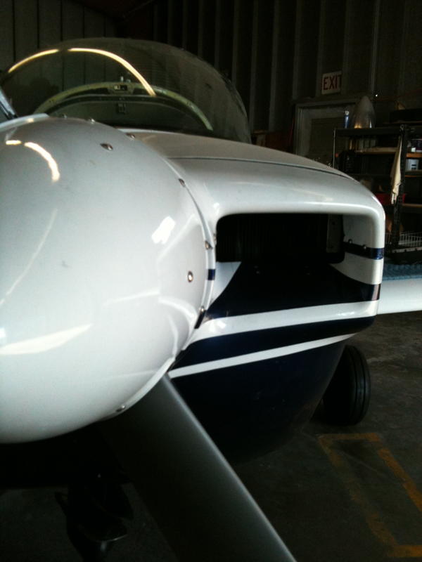

Interesting thing on the AG5B Project X plane. The cowling is 3/8 inches low with all the screws in but not tight. It's also off to the left a little. Pushed up and to the right and then tightening the screws, it's more centered. I did notice that the cowling behind the spinner is a smaller diameter than the spinner.
