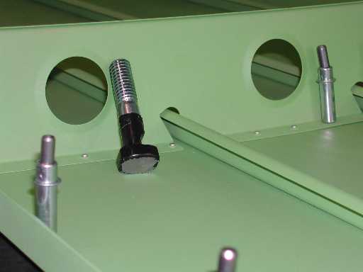

c. it is possible to backrivet those rivets that sit under the J Channel. I used a hardware store hex head bolt with the head polished and part of the bolt shaft ground out. With the rivet backed on the plate, hit the bolt firmly with a solid hammer a few times for a perfect rivet. Picture attached.

jjessen
Joined: 22 Apr 2006 Posts: 285 Location: OR
Posted: Wed May 03, 2006 8:14 pm Post subject: Back riveting the tailcone (was Errant hole) |
What a great idea for driving those specific rivets! Innovation at its best. Thanks, Ron and John G.

armywrights(at)adelphia.n Guest
Posted: Wed May 03, 2006 8:46 pm Post subject: Back riveting the tailcone (was Errant hole) |
Some of the innovation ($time$) may have been used elsewhere. Unless my backrivet set is directly on the rivet, the rivet will slide to one side of the nylon insert and only set half the diameter of the rivet, which looks kinda weird! I just began using my non-swivel mushroom set for my back riveting. With the larger surface area it’s not really any harder to keep the set on the rivet, and it fits wonderfully under J channels.
