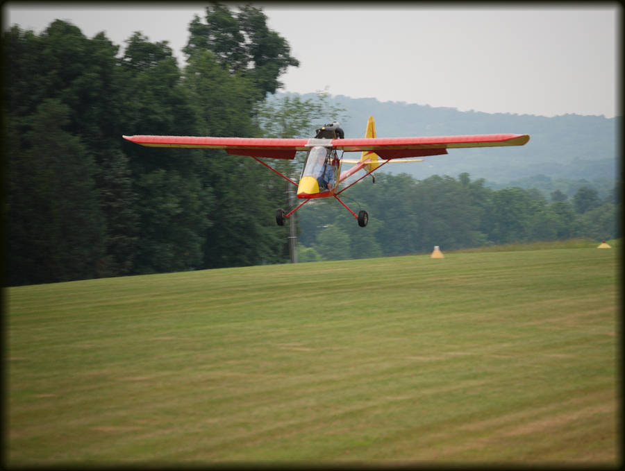

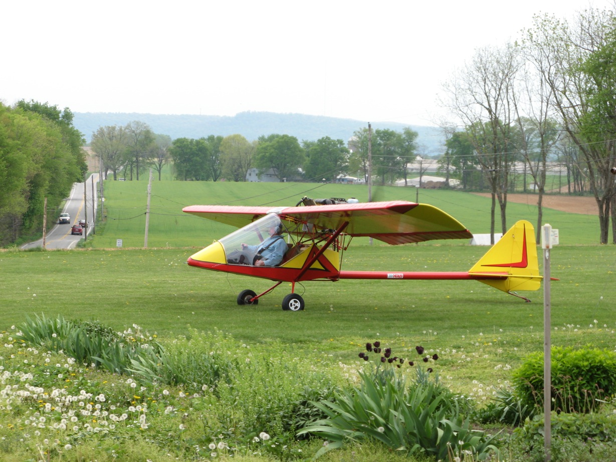

I like the way my plane flies with its Hoerner type wing tip modifications. It is very good at slow flight and very stable and controllable even in a deep stall mush.
But would I do it all again, or recommend it for others? Probably not. The plans built Kolb is already very good at all that, and any improvement is merely a tweek of what is already every stock Kolb plane's strong point.
