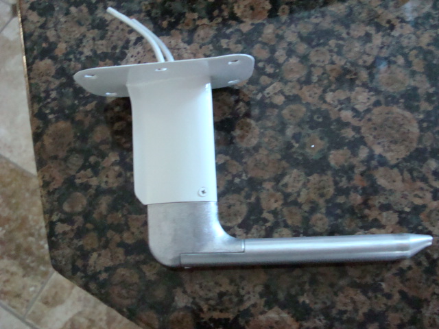

Kolb guys, and specifaically Xtra drivers,
  I'm getting close to drilling the underside of my nosecone (like...in a few minuntes),
and I was wondering if anyone has an opinion about the best place to mount the front of the pitot
tube.  I have the following pitot (from Dynon--unheated);
http://www.aircraftspruce.com/catalog/inpages/heatedAOApilot.php
  The "L" shape of this pitot places the intake hole 1 1/2"  (3.8cm) down from the mounting surface.
Can't change that.  My question is;  considering the wedge shape of the Xtra nosecone....
how far ahead of the front edge would you think would be good enough.  One inch?  Two?
  I appreciate all input, but please realize the uniqueness of the Xtra nosecone, compared to
other Kolb aircraft.  In other words....just becasue your's may work well on a Firestar, etc, etc,
I don't want to assume it'll work that same way on an Xtra.
Thanks,   Mike Welch

PostPosted: Sat Dec 11, 2010 2:01 pm    Post subject: airspeed indicator pitot placement Reply with quote
Hi John,
  Thanks for the reply.  Re: the cost, I already spent it years ago, back when I
used to make boat-loads of money.  It came with the Dynon D10A EFIS I have.
(I bought 5, since they were such a good deal...I have two remaining, using one on
the Kolb)
  My concern is.....if you place it in "disturbed" air (like that bouncing off the leading
edge of the nosecone), the you're going to get an inaccurate reading.  I realize just
about any ol' place on the airplane would work okay, I was just wondering if anybody
has found out what it takes to get 'out ahead' of that split airstream hitting the leading
edge of the Xtra nosecone.
  I went out in my shop and held the pitot 'roughly' in position.  It looks to me like
1" ahead could be okay.  (It's ALWAYS at least 1 1/2" down).  The problem with it
sticking out in front of the nosecone is it will be a great knee catcher!!
  My thinking is 1" in front of the leading edge would be fine, 1 1/2" would be more
than I need.  The final ram air point would end up at ...1" ahead & 1 1/2" down from
the leading edge.
  My apprehension is I don't want to start cutting holes in the nosecone, only find out
I should have done it differently.
Mike Welch

John, and others,
  My favorite preference would be the apex of the nosecone.  While I was
waiting for replies, I did a 'google' search and came across a guy that was
installing the exact same pitot (Dynon) in his Zenith high-wing airplane.
  I don't know where he got his pitot installation directions, but he mentions he
was supposed to put his pitot inlet 6" below the wing, etc, etc.  He built
an airfoil shaped extension that slid on the notched area of the Dynon pitot.
He says he ended up with only a 4" extension (in addition to that other 1 1/2"??).
Maybe he got 5 1/2" overall.  (I can't re-find him to verify any of the perticulars.....)
  I'm thinking I'm going to try to build one of those airfoil shaped extensions.
That way I can lower the inlet, rather than go too far forward.   BTW, the extension
would look like a Kolb plastic wing strut airfoils, only smaller, and a lot shorter, and
made out of aluminum.
  Thanks for letting me bounce all these ideas off ya.  Headed out to my shop
to see what I can come up with.
Mike Welch

mdnanwelch7(at)hotmail.co
PostPosted: Sun Dec 12, 2010 3:38 am    Post subject: airspeed indicator pitot placement Reply with quote
Hi Tom,
  Thanks for the help.  After I last replied to John H, I went out to my shop
and built an extension that lowers the pitot inlet 4".  So now, with the normal
1 1/2" "L" drop, and my added 4" drop, I end up with 5 1/2" down from the
mounting surface.
  It looks to me like that 5 1/2" lower, and maybe 1" ahead of the front of the
nosecone should be sufficient to be ahead of the 'bow wave', especially considering
the wedgie shape of the Xtra nosecone.
  I got the extension mostly finished last night.  The only thing left is to cleco on
the nosecone, raise to tail to approx. flying position, and get a fairly close idea of
the angle between the underside surface of the nosecone, and the slipstream.
  Once I have a good idea of the angle, I can cut the extension's lower edge to
make the pitot point toward the best in-coming air.
  I'll take a picture and post it later.
  Thanks again, Tom, for your pointers.
Mike Welch

Mike, John, and All –
One of my Tony Bingelis books says that a pitot tube sticking our 6 inches ahead of the structure (either wing leading edge or nose cone) should be in undisturbed air. So that’s how I did mine. Must be some margin in there, if 2 inches works OK for John H.
Also, I agree with the advice to mount the 5/16 alum tube on a small piece of polyurethane tubing, to allow the pitot tube to bend without breaking. This has saved mine many times. Mine is mounted on the tip of the nosecone, right at knee level.
At airshows, I tell the kids not to stand in front of it because if someone in the cockpit pushes the little red button on the top of the control stick, it fires a laser which will shoot a hole right thru your body.

Hi Dennis,
  As I previously mentioned, I'm not using a 5/16" tube, I have a Dynon
pitot tube (see attached photo).  I made the extension, which is the white
part, and that now places the pitot inlet 5 1/4" lower, and about 3/4" ahead
of the Xtra nosecone leading edge.  I would find it difficult to believe that
that location wouldn't work well. (with regard to oncoming air)
  Because of the very sharpish nature of the Xtra's nosecone wedge, I can't
imagine it produces very much of a bow wave like you could expect from a typical
wing leading edge, or possibly like that on a MkIII Classic's more round nosecone.
  Regarding having it bumped at airshows, etc.  First of all, I'll have a 'remove before flight'
tube slid over it, with an extra 3-4" of foam rubber, making it LOOK like it sticks out 5".
Secondly, maybe I can build a little taser circuit that will dissaude kids from kicking it.
Nothing funnier than watching a 10 year old holding onto 20K volts.

Spruce sells a pito tube that you can mount where ever and the tube twists one direction to stay and the other to come out. Allowing you to remove it around klutzes. Its pretty cheap too.
