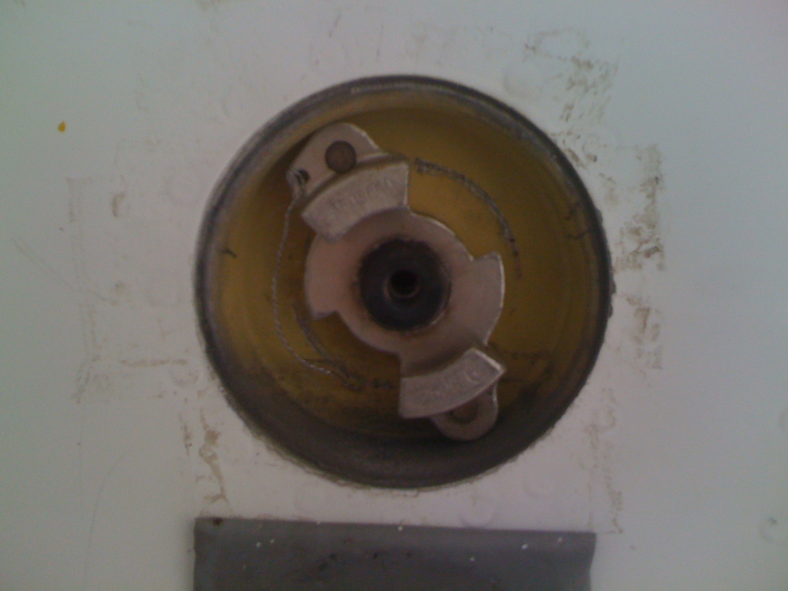

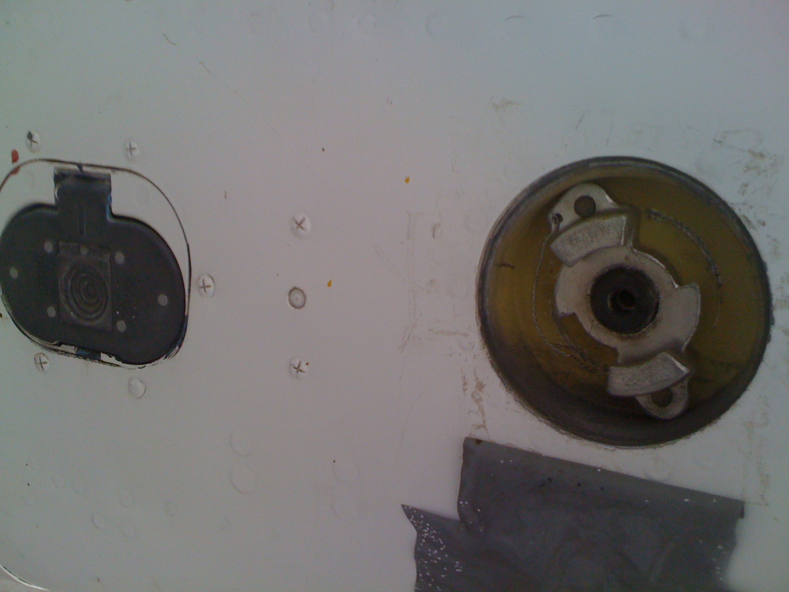

Hi all,
Does anyone have an air connection cover for my 18T. Also are the other Yak's the same?
Thank you,
Ant.

Ant,
You can make your life a lot simpler regarding the external air fill port by installing a Schrader valve fitting (http://www.mcmaster.com/#schrader-valves/=a66ydc), part number 8063K31, on the cover. Remove the valve core because it is not needed. It's a 1/8 NPT Schrader valve fitting. Drill and tap the center of the cover plate. Put a small amount of epoxy around the threads when installing the Schrader valve to prevent leaks. Then you can use a simple Schrader valve coupler attached to the hose going to an air tank, http://www.aircraft-tool.com/shop/detail.aspx?PRODUCT_ID=SK2043C, and you'll never have to find a Russian adapter again.
By installing the Schrader valve fitting on the cover, you can still remove the cover and use a Russian fitting.
Hope this helps.
Dennis

Thanks Dennis,
But it is the actual cover plate that I am after.
Ant.
