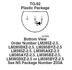

Okay, all of the voltages you've measured are expected
values with one exception. Pin 3 of U107 voltage is
established by the voltage reference Z103 and SHOULD
be within 30 millivolts or so of 2.50 volts.
http://www.national.com/ds/LM/LM185-2.5.pdf
The fact that you're reading only .68 volts suggests
that Z013 is installed wrong. See data sheet for pinout
orientation . . .
[img]cid:.0[/img]
Note that the image is a BOTTOM view
of the device. The pictures for assembly of
the 9005 show the flat side of the device
pointed toward the power transistor location.
If you determine that the device IS
installed wrong you should consider the
best way to replace it. If you have the tools
and experience to removed parts from a plated
thru hole board, you have a high probability
of re-using the original part.
I very seldom pull a part off a board with
any notion of reusing it. The value of the
part is usually pretty small compared to the
value of the whole. I usually clip the leads
on the part to be removed so that they can
be taken out of the holes one at a time thus
minimizing hazard to the board.
