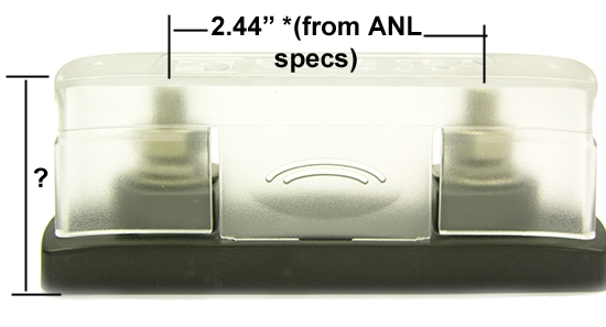

Looking at the Picture from the B&C website . . .
[img]cid:.0[/img]
. . . and applying some simple ratio and proportion studies
suggests that the overall height of this product is on the
order of 1.75".
Close enough for OBAM work?
