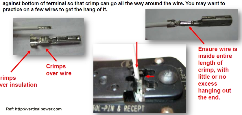

The VP tools are a finely tuned, ratcheted operated die set
to close the open barrel, sheet metal pins
[img]cid:.1[/img]
Thanks for raising that flag!
