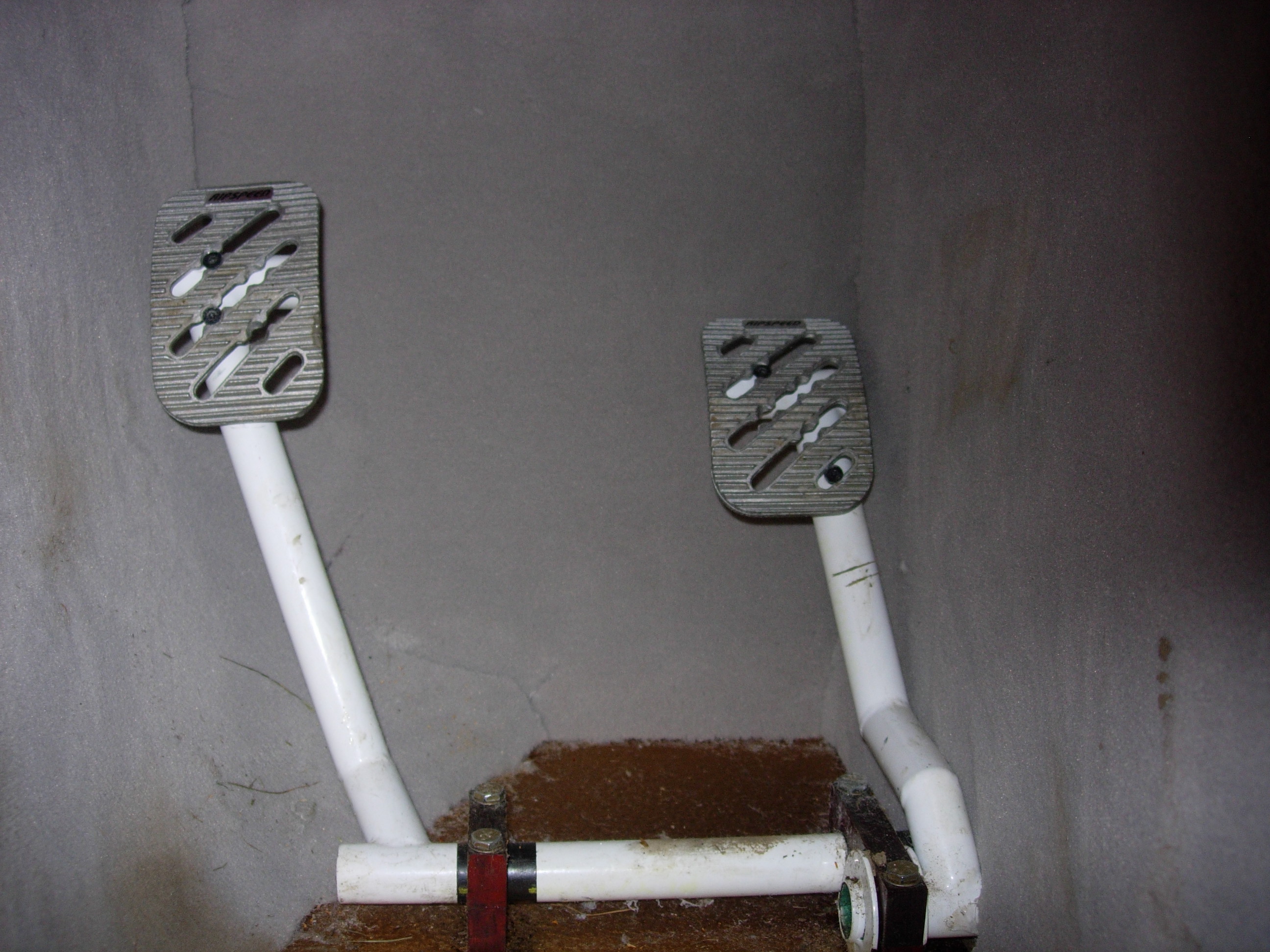

I have been looking for some pictures to show what I should do to make some rudder pedals - don't much like the pipe - too narrow, shall I just make some wood or aluminum blocks and self tap screw on. Also I think I have seen plates at the bottom for ones heels, is that the thing to do?

I know what you mean looking at the standard rudder pedals. I thought the same but in use I have never had a problem. They are fine.

Sorry can't remember where you are based but I used two footplates produced
by Ripspeed in the UK. They are lightweight aluminium and have ridges and
holes for fitting to the pedals - non slip and ideal for the Europa. The
only problem is you have to buy them in 3s as they are for cars.
Steve Pitt

A picture tells a thousand words.
Steve Pitt

The rudder pedals (crude though they look) work just fine ....if it "ain't
broke don't fix it" with more weight !
