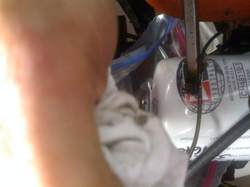

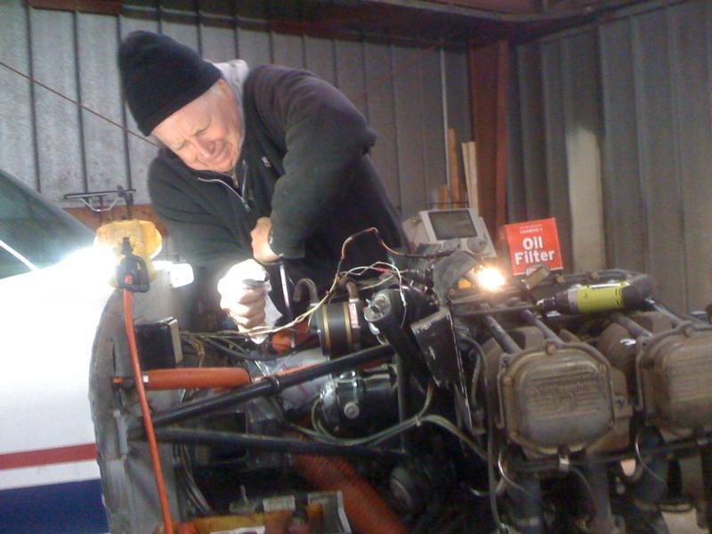

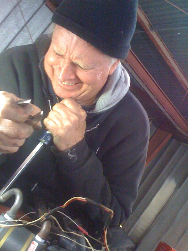

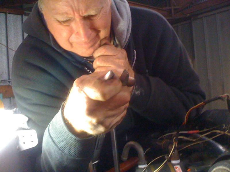

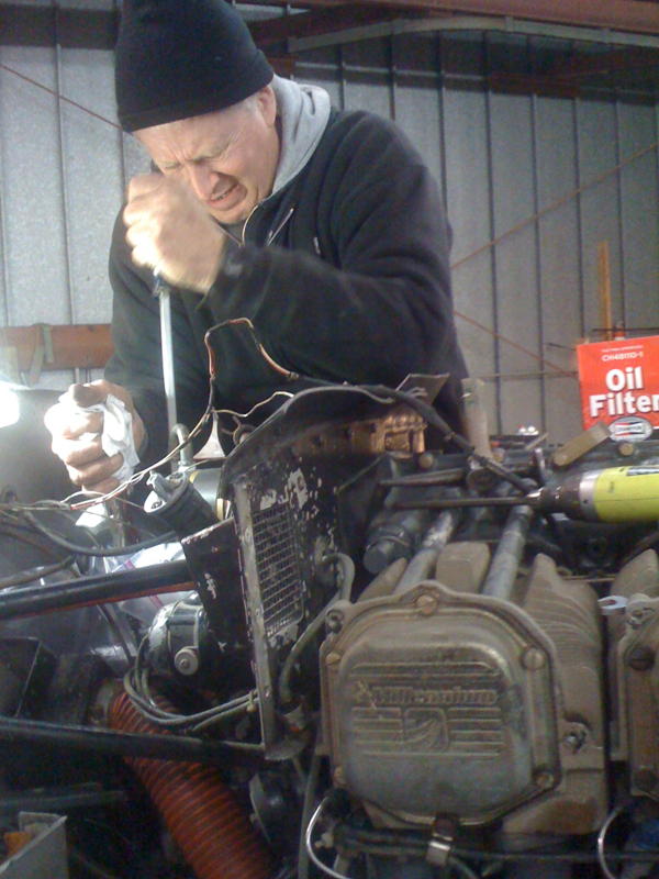

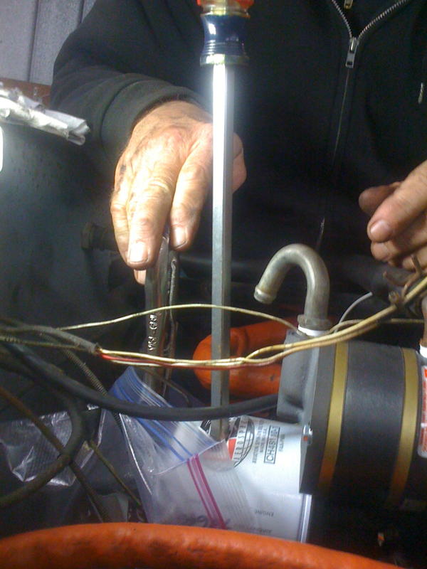

I just spent an hour REMOVING an oil filter.
About the only thing that would have helped would have been the old style strap type oil filter remover. I didn't have one.
I started out using vise grips with a 7/8 inch wrench as a breaker bar extension. I got the nut on the filter pretty much rounded off. Then, I got a 24 inch screw driver and punched through the oil filter. With both working at the same time, I was able to turn the filter about 1/4 turn. Then, it stuck again and all I did was end up tearing the oil filter. I then punched all the way through and was able to turn it about another 1/8 turn. Then I punched a new hole an inch from the other but this time all the way through. I was able to turn the filter another 1/4 turn. So, now I used the holes on the bottom and pushed the screw driver through. With the vise grip and the 7/8 inch wrench, I was able to get it another 1/2 turn. From there, I used the vise grip and was able to turn the filter. The filter did not come off the gasket for another turn. This filter was so seriously over tightened that there is no describing it.
PEOPLE, YOU DO NOT NEED TO TIGHTEN THE FILTER PAST GASKET CONTACT PLUS 1/2 TURN. IT WILL NOT LEAK. IT WILL NOT COME OFF.
See pics.
This isn't the first filter I've had to resort to extreme measures to remove. This is the tightest one though.

It sounds like whoever installed the filter either over-torqued it or didn't use DC-4 lubricant, or both. Alas, this means that you may now have a warped filter adapter plate (the Lycoming engine maintenance manual talks about this). You should check the plate for warpage as soon as possible -- before the next flight. The filter may not leak for a while, but then suddenly give way, result in an engine fire or even catastrophic engine failure.
I always use an automative-type filter along with a 12-point 7/8" socket on the hex end of the filter to get a double grip on the filter, but sometimes that's not enough and you have to use the filter piercing trick. The hex end is just sheet metal, so I would avoid any kind of crushing tool like a vise grip. A great strap wrench that lets you use any 3/8" socket wrench as a handle is the Plews-Edelmann 70635:
http://www.hardwareandtools.com/Plews-Edelmann-70635-Oil-Filter-Wrench-6289409.html
Lycoming also recommends Dow Corning DC-4 compound as a filter gasket lubricant rather than engine oil. This makes an astounding difference in ease of removal, and DC-4 is cheap: $15 for a lifetime supply from AC Spruce.
Your idea about only tightening the filter past the gasket plus 1/2 turn isn't a good one, though. Lycoming calls for a specific torque, I believe 18 to 22 foot lbs on the O-360, and cautions about over-torquing leading to adapter plate warpage. I know you didn't cause this filter's problem, but your method could result in either under or over torque when replacing the filter.

Blah, blah, blah, the sky is falling,
I've been installing oil filters on airplanes for 35 years. I use the engine oil and I tighten as I said. I've never had one leak.
As for warping the surface. Are you serious? The gasket will blow out and the engine will catch fire? You can't be serious.
You use an automotive type filter? you mean filter wrench.
Quit overworking the problem. Tighten as I say and you won't need anything fancy to remove the next one.
