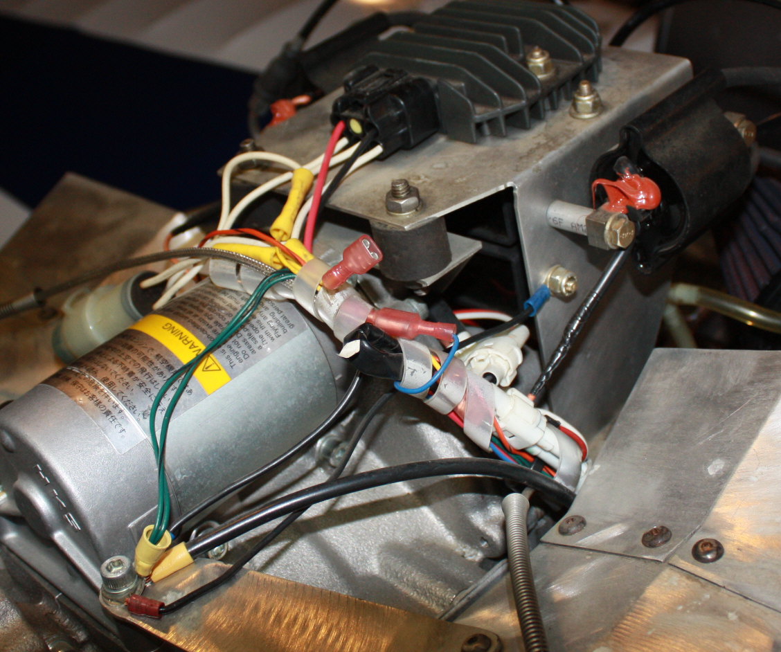

I am using the HKS 700 E and it does have dual ignition. There are two wires coming out of the ?lighting coil? that will indicate the RPM's Either one will work with occasional lapses, neither one will work all the time. The two pink connectors are the wires that indicate RPM, the blue wire is the one that goes to the EIS. I will again check to make sure that I have a good connector on the EIS wire.
