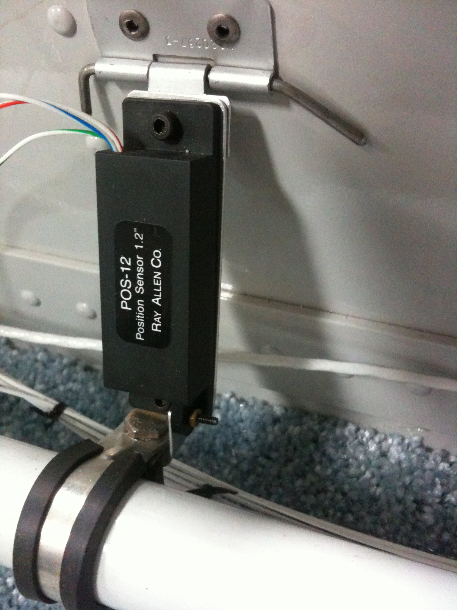

Can't remember who I borrowed this from, but this is the way I did it.

PostPosted: Sun Apr 03, 2011 2:25 pm    Post subject: ray allen potentiometer flap indicator Reply with quote
2 points. The movement is non linear because of the hinge. It is great for
indicating flaps up or down but not partial flaps. Also if the POS
overextends it breaks and you will get no reading so be careful how far you
let it extend.
Alan

PostPosted: Sun Apr 03, 2011 2:27 pm    Post subject: ray allen potentiometer flap indicator Reply with quote
Yep, that's mine. Thanks for reposting it... I didn't have the picture handy

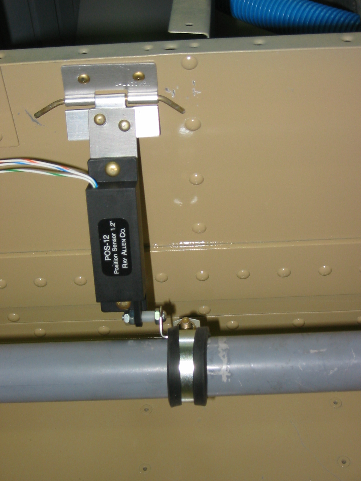

PostPosted: Sun Aug 28, 2011 6:08 am    Post subject: Re: ray allen potentiometer flap indicator Reply with quote
I like this simple solution to mounting the POS-12. It is inside the airplane (keeping it out of the weather) and easily accessible for maintenance. This is my implementation(see attached picture). To get the 1 inch travel, I found that having the arm attached close to the outside of the flap tube worked well. I just bent a piece of scrap aluminum, drilling a hole close to the flap tube. I used a 4-40 bolt (with loctite on the nuts) and a short piece of plastic spacer material (from Lowes). This eliminated possible interference between the POS-12 arm and the metal tab. To keep it even simpler, I just placed the angle bracket under the cushion clamp and it seems to work fine. (No drilling in the flap tube.) The total travel of the POS-12 is just about 1 inch of the total 1.2 in available. The comment was made that this provided a non-linear representation of the actual flap extension. This is true, but I'll be calibrating it for the VP-X display with actual flap position measurements that should be close enough. Remember, many folks don't even bother with flap position information, relying on their eyeball measurement by looking out the window.
