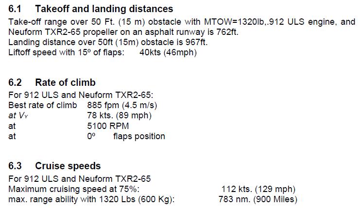

Attached the performance figures of what is supposed to be a latter day hot ship, the Flight Design CT-LSA. Doesn't that just show how effectively the TR-1 still competes with the best. With MTOW the TR-1 with 130hp will manage over 1000 ft/min climb and the usefull load is effectively the same. Comparative takeoff and landing distances at full weight are not different enough to worry about.
So the primary advantages of the CT-LSA lie in the ease of boarding (mainly of interest to womenfolk), lower stall speed (if you can stop it floating of the end of the runway) and some saving on fuel ( which matters only for long journeys). On the other hand the TR-1 can be fitted with power to nudge it up to the 180 kts mark due to its much higher Vne -- and the TR-1 will surely fly quite happily in conditions which will ground the CT. So, when the price is factored in the TR-1 doesn't have to stand back for the competition at all.
Mmmm ... I'll have to go fly the CT2K then to make up my mind Surprised) IF I can get the main gear position sorted out the TR-1 probably still holds the edge if the price differential is big right. Now if we can just get a smidgin of factory support again ... Surprised)
Now would you believe it!! ... as I was writing that I got a call from James in the US asking me to send over pictures of my wing root dimensions so that they can check it against the dimensions of the factory stuff. Spooky ... brrrr Surprised)

PostPosted: Fri Apr 15, 2011 3:31 pm    Post subject: Re: Longtudinal Stability of KIS TR-1 Reply with quote
Chuckle .... completely forgot to attach the CT-LSA peformance figures to previous message, what with all the excitement of receiving a call from Pulsar Surprised)
Here it is attached now ....
Figures taken from section 6 of the CT-LSA POH ...
