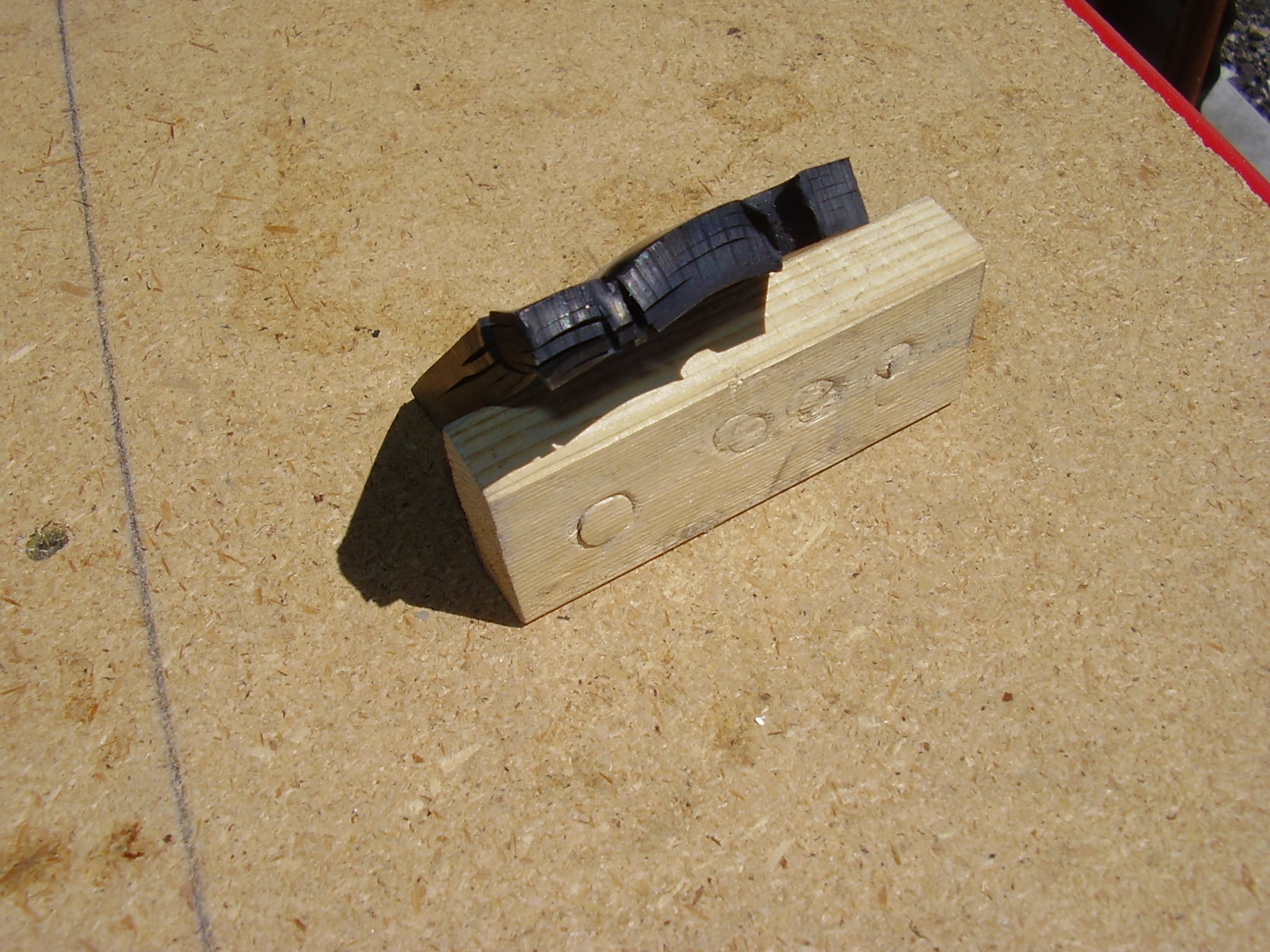

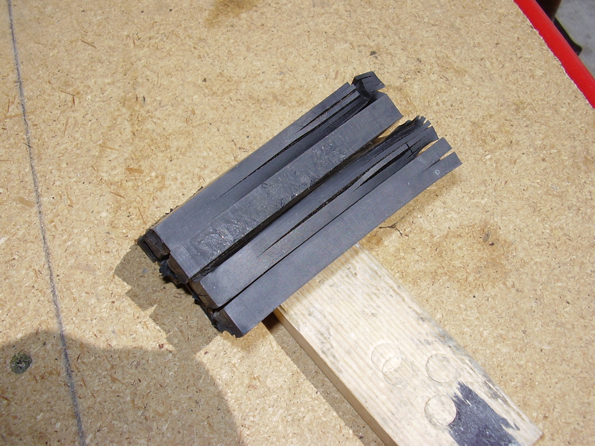

Then on inspection, during pre flights, I noticed that the rubber that was showing was beginning to crack where the tension was applied at the edge of the bottom bracket.  That's when I started to ask questions and research the past articles.  I had already been aware of the "weak link" and I got some new pads from Zenith after talking with Roger - but as we all are want my efforts were to get into the air so delayed putting on the pads.
Attached four pics and you can see why I'm glad I took the two hours to get-er-done. (Sorry they are out of sequence)  IMHO, if I had a 701  with the old pads I'd get out there and get on my back and take a good look.  The majority of the delamination and such is not noticeable until you take it apart so be guided by that thought.  I'd be interested in what everyone finds.  Don't know how this would have affected airworthiness but looks like something that needs attention.

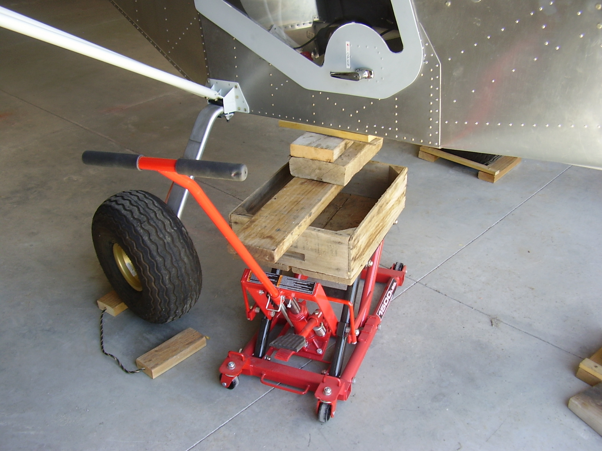

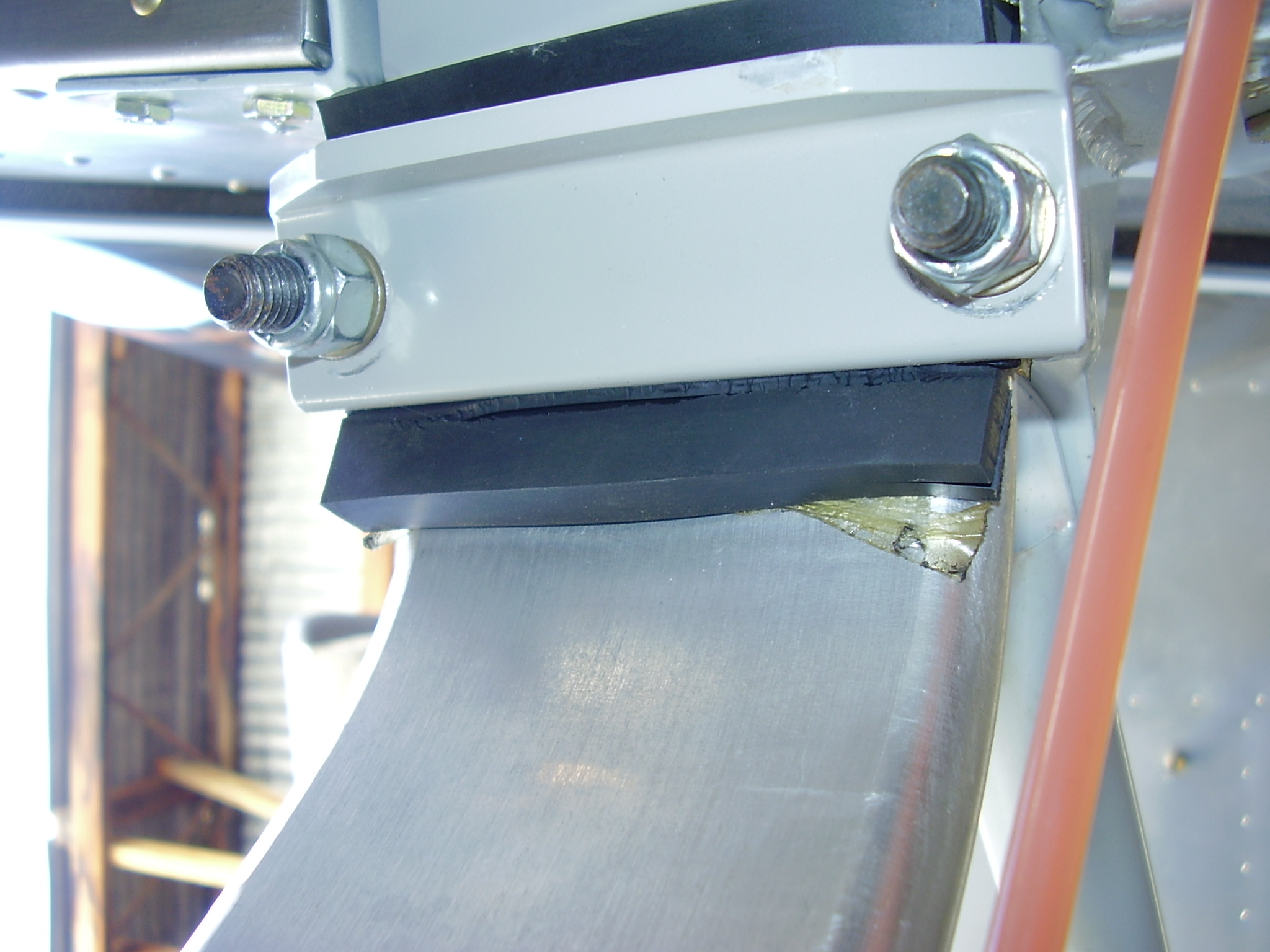

Really straight forward; borrowed a motorcycle jack, fit up some spacers, chocked the nose and off side wheel (you can just see the nonslip chocks I built) and lifted one side till the tire was just off the ground.  Dropped the bracket to the end of the bolt thread travel, lifted the side a little more and took out that side's upper pad.  Inserted the new material pad (from Zenith) and lowered away till the weight was just back on the wheel - then bolted up the lower pad and bracket.
As they say "repeat one thru...ten  for other side"!
Worked great with no problems and I felt the the plane was stable and if things went terribly wrong if I had not taken the whole gear out of the "channel and bracket"  AND the other side was still mounted that there was really no place for the plane to go.  That's why I opted to do it one side at a time without complete disassembley.
After both sides were done I rolled it back and forth to "normalize" the tracking and all seems well.  Let you know if any other quirks come up.
