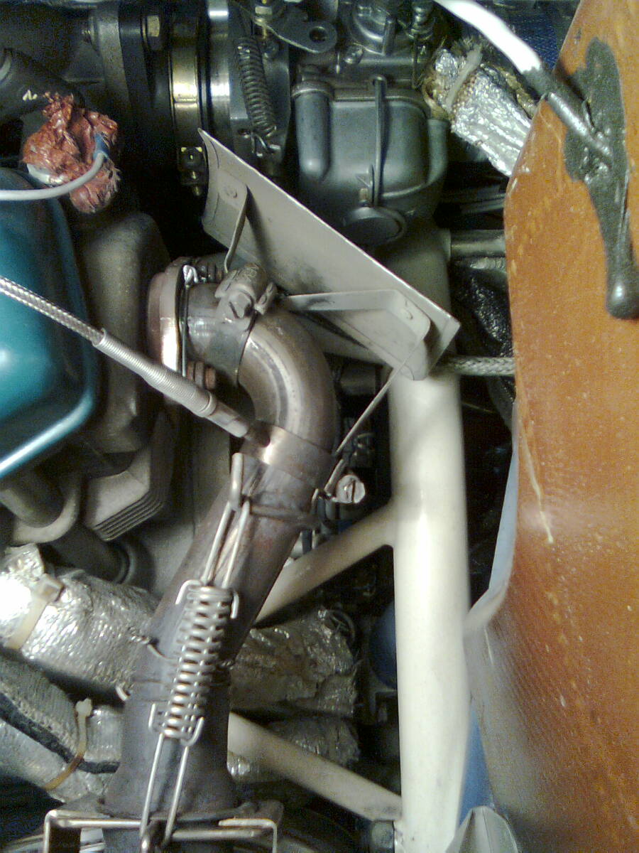

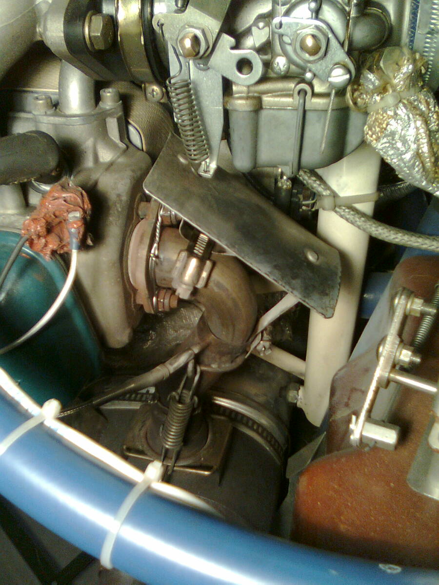

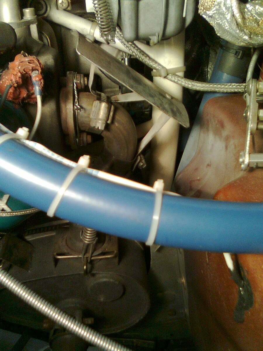

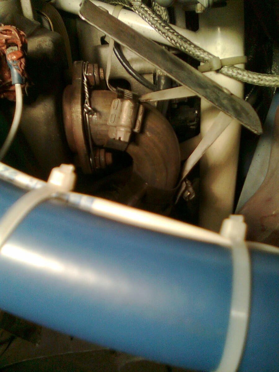

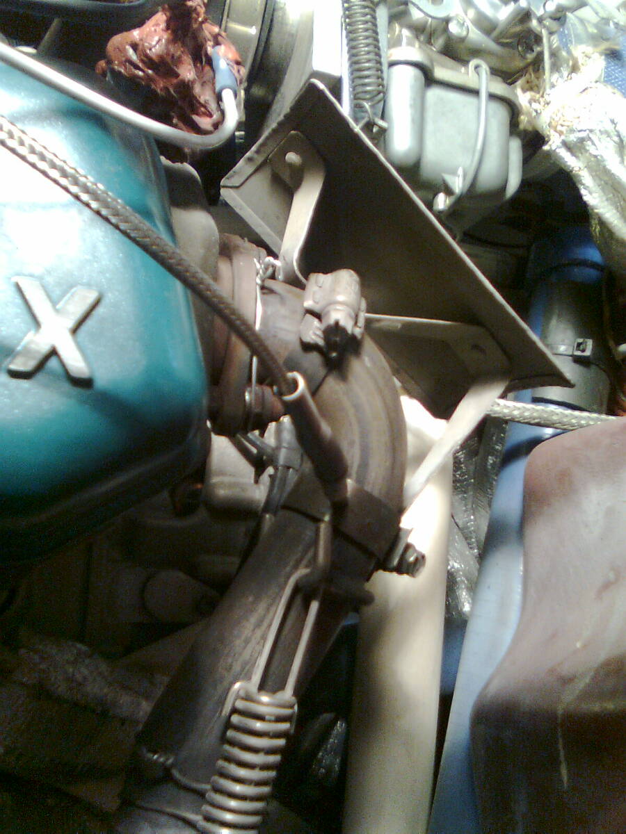

Attached are five photos of my carb heats shields (912 ULS), which I hope will say more than a thousand words.
The shield is made of thin stainless steel plate. The support is one continous strip cut from a stainless steel plate, riveted to the shield. The zig-zag shape makes the support sufficiently stiff against vibrations.
You will see that the aft, lower fixation of the shield support is the screw clamp that holds the exhaust temp thermocouple in place, while the forward, upper fixation is a standard stainless steel screw hose clamp. Both are tightened "just so" - no point tightening hard. If you do not have these thermocouples installed, use hose clamps.
Good luck.
Svein

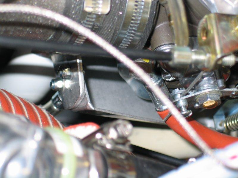

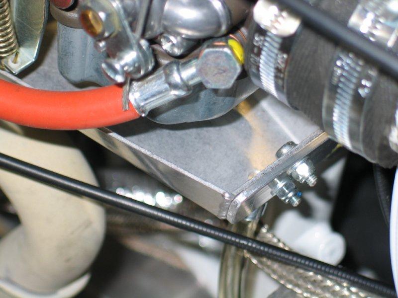

PostPosted: Wed Jun 15, 2011 11:14 am    Post subject: Re: Heat shields - carbs Reply with quote

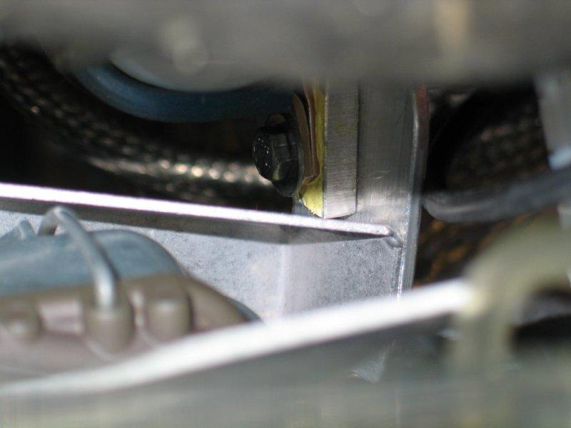

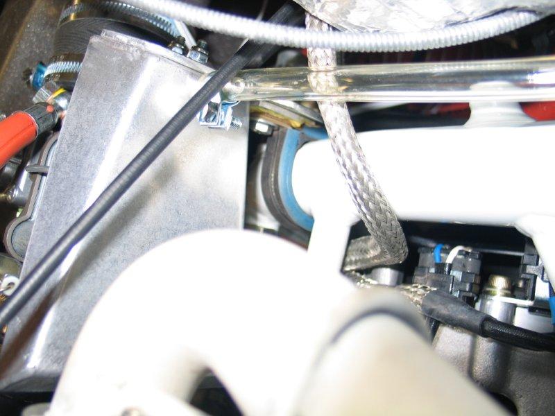

Here are some pictures showing my heat shield cup installation. I used loop-type cushioned aluminum alloy clamps (WDG) to fasten the cups to the engine mount. To do this I had to build small aluminum brackets. To the one on the left side carb a rather thick piece of aluminum is bolted between the bracket and the clamp because the carb on the left side is further backward. See the attached pictures. More details can be provided on request.
Alfred, HB-YKI, XS Mono
