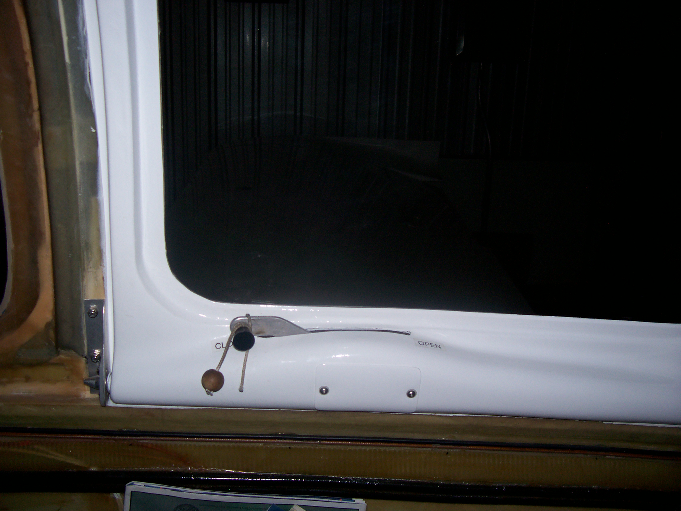

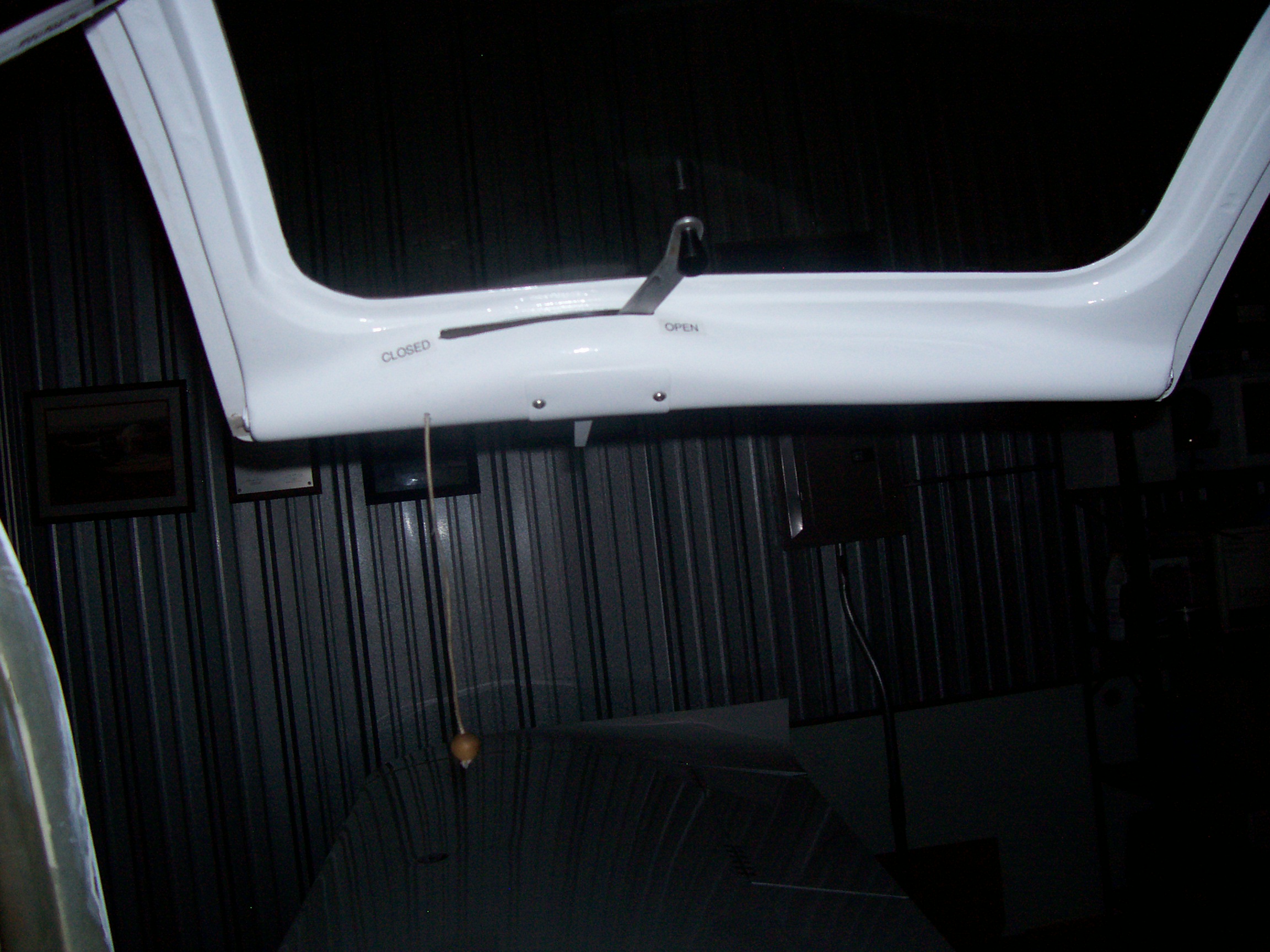

PostPosted: Tue Jul 05, 2011 8:11 pm    Post subject: Door pull Reply with quote
4/5/2011
Hello Al, Attached are two pictures of my KIS TR-1 door pull system.
Picture 0548 is taken with the copilot's door partially open (for picture taking purposes). When the door is fully open the string and ball hanging down makes it still possible to reach the ball and pull the door down and then the bottom end of the door inward for latching purposes.
Picture 0553 is taken with the copilot's door closed and the string wrapped over the handle and then around the handle knob to both keep the string out of the way and provide additional assurance that the handle will not inadvertently move to an open position. A little bit of bees wax rubbed on the string from time to time provides just the right combination of stiffness and stickyness.
Notice the taper on the end of the locking pin. This provides a wedging closed effect. The aluminum bracket that the pin goes into holds a nylon disc with a hole in it that the locking pin actually comes into contact with. The nylon disk provides a lubricating effect so that I don't have aluminum rubbing against aluminum during the pin locking movement.
This system has worked perfectly for over 336 hours.

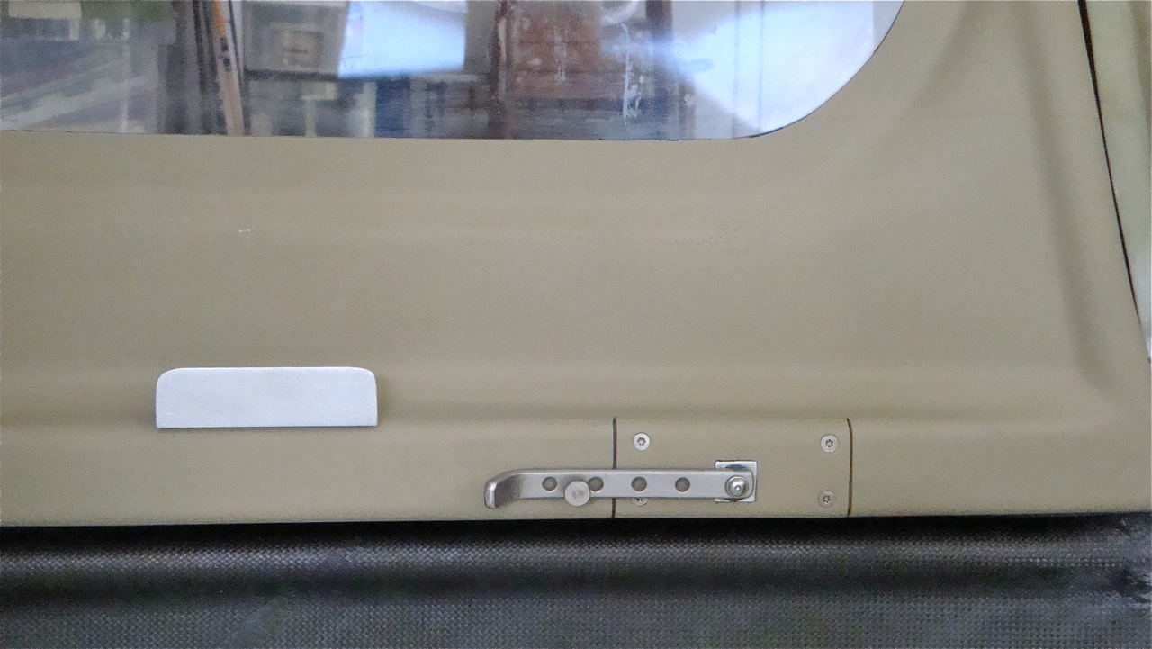

fredorosa(at)gmail.com
PostPosted: Wed Jul 06, 2011 9:25 am    Post subject: Door pull Reply with quote
Bob,
Are you're referring to OCs pull string solution?  It's simple all right and effective.  Only thing is it doesn't look aeronautical with it's homespun
materials.  Iv'e decided to try an aluminum pull grip riveted to the door.  Will post a picture.
Al

Hello Al, I have a short length (maybe 12 inches long) of nylon cord coming out of a hole on the inside of the fat part of each door. A knot on the outer end of the cord keeps the cord end from pulling out through the hole.
On the cockpit inner end of each cord I have a round wooden bead (maybe 5/8 inch in diameter) with a hole through the bead and a recessed portion in the hole for a knot on the end of each cord to keep the bead from coming off.
The cords hang down with the beaded ends within easy reach for pulling the doors down with the cord into the door closed position. Additional inward pull is also applied by pulling inward on the beaded cord end as the other hand moves the latch handle into the door pinned closed position. (A slight door inward wedging action is created when the door latch handle is moved into the pinned closed position by the door pin design.)
Then each cord is wrapped around the door latch handle knob a few times to both keep the cord out of the way and to add some additional insurance that the latch handle will not inadvertently move to the open position while in flight. (The primary means of keeping the door latches in the closed position is the Europa shoot bolt mechanism.)
For some cooling air one can taxi with an elbow holding the door open a bit while that same hand is used to hold the cord to keep the door from moving further open.
An additional consideration is that a person on the ground can force the door latch into the door unlatched position in an emergency rescue situation because the nylon cord  will slip and unwind if enough force is applied to the exterior door latch handle.
I'd be happy to take and send or post some pictures if anyone is interested

[img]cid:ii_13105cc9df67a57e[/img]Here is my solution to a door pull. A piece of angle aluminum riveted to the door frame.  It requires getting off your ass
to reach but it gives a very good grip to hold door tightly shut while engaging the lock pins with the crank handle.
My plane has rear wing boarding so the outside handle is on the right side of the door.  The crank drives a spur gear
which engages teeth in the square rod pin.  One complete turn locks or unlocks the door.  A thumbscrew fits a hole to
lock the crank handle in the closed position.
 Filesize:  220.14 KB
 Viewed:  9133 Time(s)

Hello Al, Thanks for the picture and the explanation -- a very neat installation.
'OC' Baker Says: "The best investment we can make is the time and effort to gather and understand knowledge."
PS: I note with pleasure your use of the Torx (6 lobe) drive, countersunk, flat head, stainless steel machine screws from Microfasteners. It helps to justify the long effort that I put into having those screws created and available to our homebuilding community.
