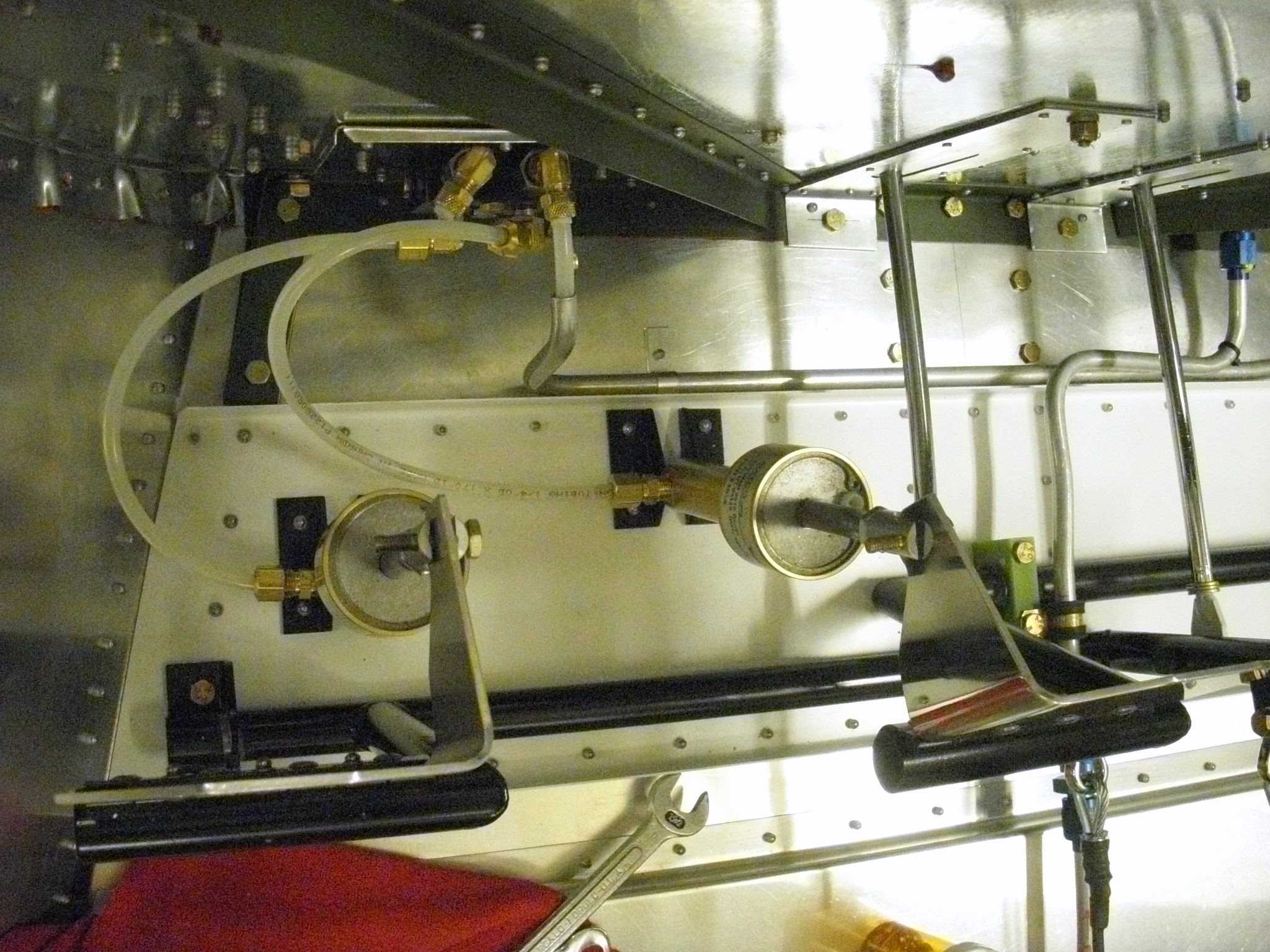

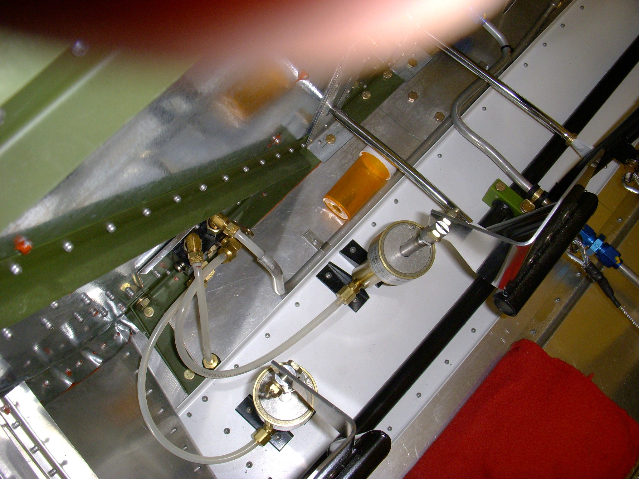

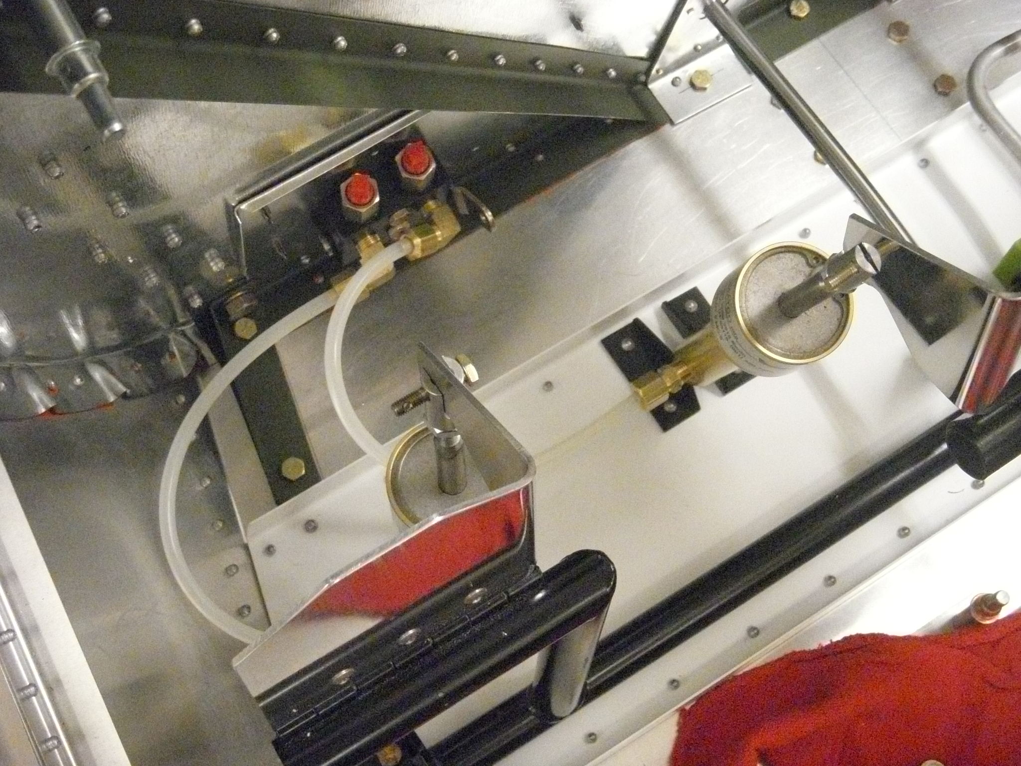

Chris, here are 3 pics from my install. Yes, I added a lever to reverse the direction of the brake...but I didn't have it included at the time these were taken.

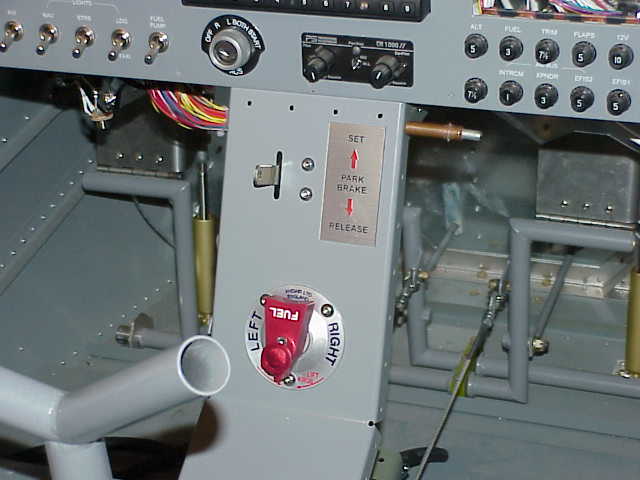

I put my Matco brake on the console between the seat and instrument panel above my fuel selector. I still need to make a nice knob for the lever but I don't need any linkage cable and it uses the empty space. Also looks great with the label next to it. I also used the 1/8th size tubing from Matco. I would be happy to talk about it if you want to call me. John 913-915-1989 Central time.

If you are using the Matco MC-5 brake actuator
the vent hole on the top of the actuator has to be the highest point in the hydraulic system. See note in the Matco web site.

PostPosted: Thu Jul 28, 2011 3:19 pm    Post subject: Re: matco park brake location Reply with quote
