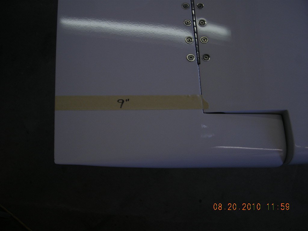

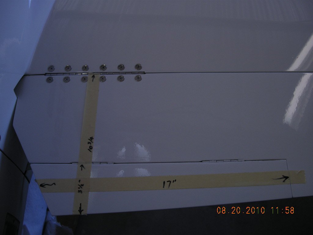

I also added 1 3/4" to the elevator and have plenty of authority. A friend has a stock elevator and runs out of authority on a slow approach and touch down. When I fly his I notice that his elevator and aileron stick forces are nearly equal while mine is much lighter in pitch.
