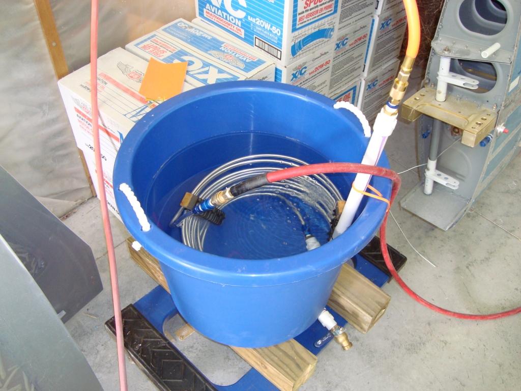

For those of you doing your own painting, attached photo is a water separator that I find to work well. When painting I add a few blocks of ice to the water. In the photo the red hose is air in, the orange hose is air out. The drain valve is connected at the bottom of the vertical PVC pipe. The vertical pipe acts as a water collector.
Carl
