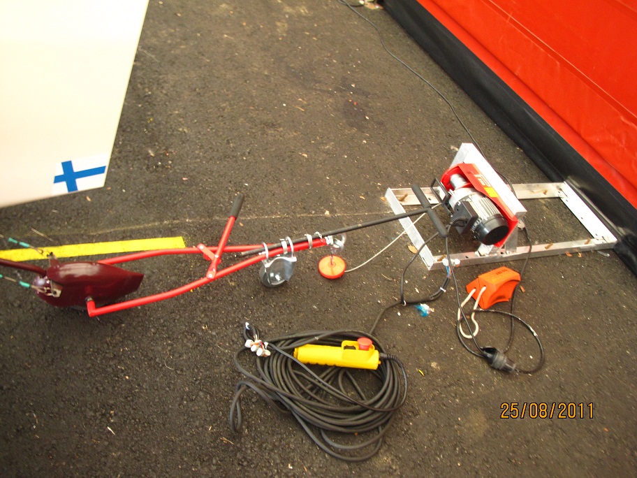

Attached is my solution (how to pull my Mono to
the hanger which locates on the small hill).
As you can see, I trust to my tailwheel.
Max pull force which is needed when pulling it
into hanger is 40 kg which is not a problem for a
sturdy structure of Europa´s tail wheel.
The winch itself is actually an engine hoist which
should be mounted to the roof.
It is capable enough to pull/lift 150 kgs = 330
lbs.
I did an adapter and bolted the hoist via adapter
to the ground /asphalt.
Remote controller is wired (a long cable, 12
metres /36 feet so I can well check all the
clearances when pulling her).
There are two limit switches so it is safe to use.
It would be easy to make it wireless controlled
but that is not necessary in my case.
When using it I feel myself to be more an operator
than a labour-pull-man.
If I were you, I would watch ATV (All Terrain
Vehicle) winches. Some of them are very strong and
operates straight with 12 VDC.
So it is easy to install into to the trailer.
Cheers, Raimo Toivio
Europa XS Mono OH-XRT #417
Updated flight hours /landings:
37500 Lempaala
FINLAND
p +358-3-3753 777
f +358-3-3753 100
toivio(at)fly.to
www.rwm.fi

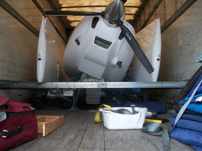

My fabricator makes from 1/2 to 3/4 inch nylon a set of tapered spacers that drop in the carrier and hold the tire very snug to prevent side to side leaning. The wheel bearings and wheel are very strong so I expect it to hold the aircraft. A six ply sidewall on a 7 inch tire flexes very little. Only a small amount of taper is required to get the tire wedged in. Then the trailer ramp/arm is raised to hold the gear channel in position and if that is a bit loose, shims of phenolic were added to get a snug fit.
Here at Custom Flight we use ratchet straps to pull the gear leg into the trailer ramp hard and will modify the two adjustment arms if they do not bring the ramp up snug. Then we strap the wheel down hard to the trailer with crossed straps.
To prevent rocking back and forth if the tire loses pressure, we use bolts and a fake spar through the fuselage to hold the fuselage from leaning too far. Yes the wing will get in the way, so we run a strong strap from the trailers metal brace horizontally and hook down into those hooks. Miserable, tight and dirty to get between the fuselage and wing but doable. I have also seen folks use a strap over the fuselage, but I am not keen on that as the gear bounces so if you pull down tight, pad it well and check often.
Photo's attached of an aircraft that did not have the main wheel strapped:
[url=https://skydrive.live.com/redir.aspx?cid=2161856909618aa7&page=play&resid=2161856909618AA7!140&parid=2161856909618AA7!139&type=1&authkey=*AFq6nx20aM%24][img]cid:00c501cc680f$764abf30$00B69D56(at)goldfishbk2xxe[/img][/url]
Operator only strapped swing arm to trailer and aircraft bounced out.
Remember the gear takes the load, any fuselage strapping puts force on the fuselage or other attachments. So as soon as the fuselage begins to lean, stop and readdress. I pulled a mono kit with no engine from Utah without any difficulty except trailer tires and the foam wing cradles. If your trailer still has the foam inserts in the wing rack, replace them with strapping or fiberglass and pad them as they are notoriously bad about breaking down over time.
As for pulling the mono backwards, we have a tow bar set up similar to Raimo's.
For mono trailer loading and unloading, we just pick up the tail and move the plane. Lift the tail over the main wheel cradle and get it in the track and added a rope winch to the trailer to pull it aft. Easy to do with a young strong assistant. Be sure to strap the tailwheel down.
I have a 22 foot flat bed for my trigear and an electric winch that hooks to either the tow bar or around my nose gear pivot shaft housing. One guy can load the fuselage. Wings are still hoisted. Flip up wheel pants allow for a quick strapping using a cable over the brake disk and three ratchet straps (one for each cable and one for the nose gear leg, holds the plane marvelously secure.
