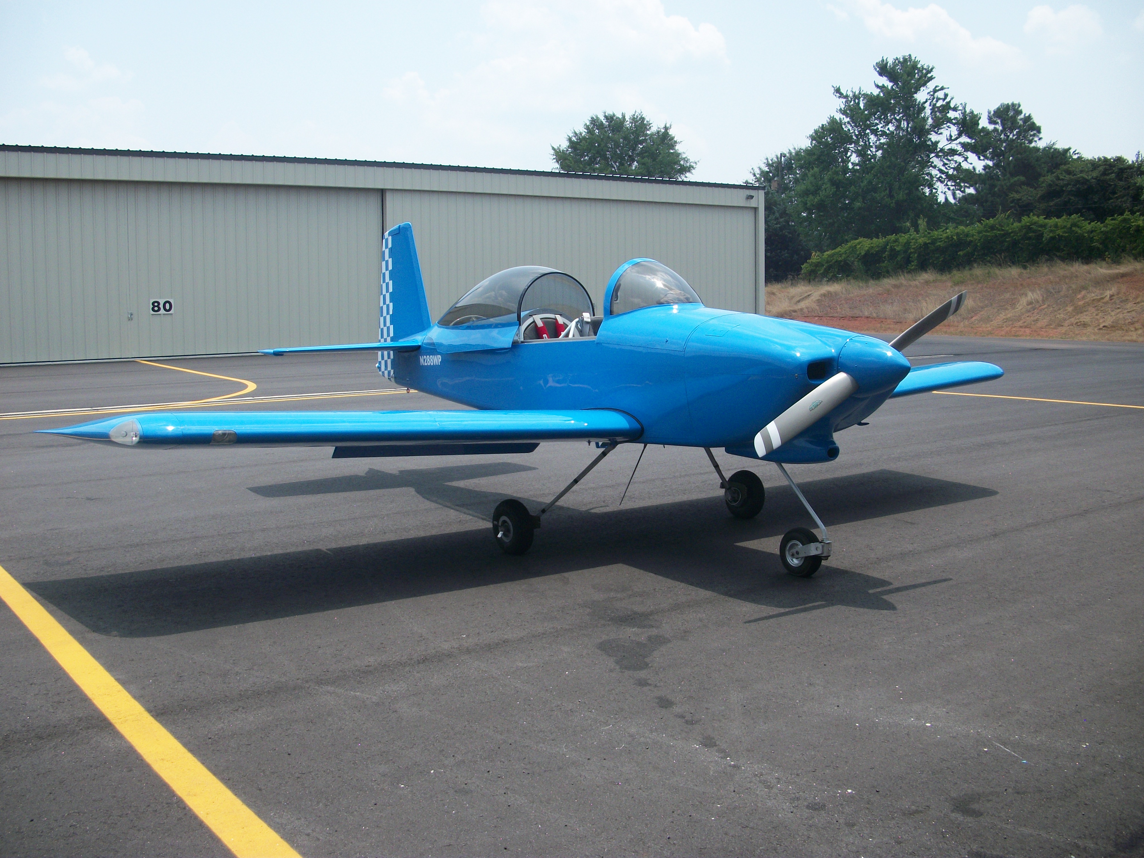

PostPosted: Wed Sep 07, 2011 3:08 pm    Post subject: Pre-punch baggage door Reply with quote
If you want a baggage door that fits perfect (not just good) do it my way.
Being an overweight oldfart, I didn't want to do it on my head from the
underside. Get all the pieces ready and cleaned up with solvent and
scotchbrite. Use 3M structural Epoxy, JB Weld, or any good structural epoxy
and assemble with clecos and then strap down flush. After the epoxy sets it
will be perfect forever and the rivets will just be to fill the holes. I'd
put the fit of my baggage door up against any RV8 out there. Also use a Gas
Spring with geometry such that the spring will hold it closed if you forget
to lock the latch but once the door is raised an inch or two it slowly
raises it to full extension and the holds it up. The only way to fly!
Thanks!
Esten Spears, Leeward Air Ranch, RV8A, 80922, N922ES, - Flying
9127 SE 72nd Avenue
Ocala, FL 34472
352-347-3523
ewspears(at)comcast.net

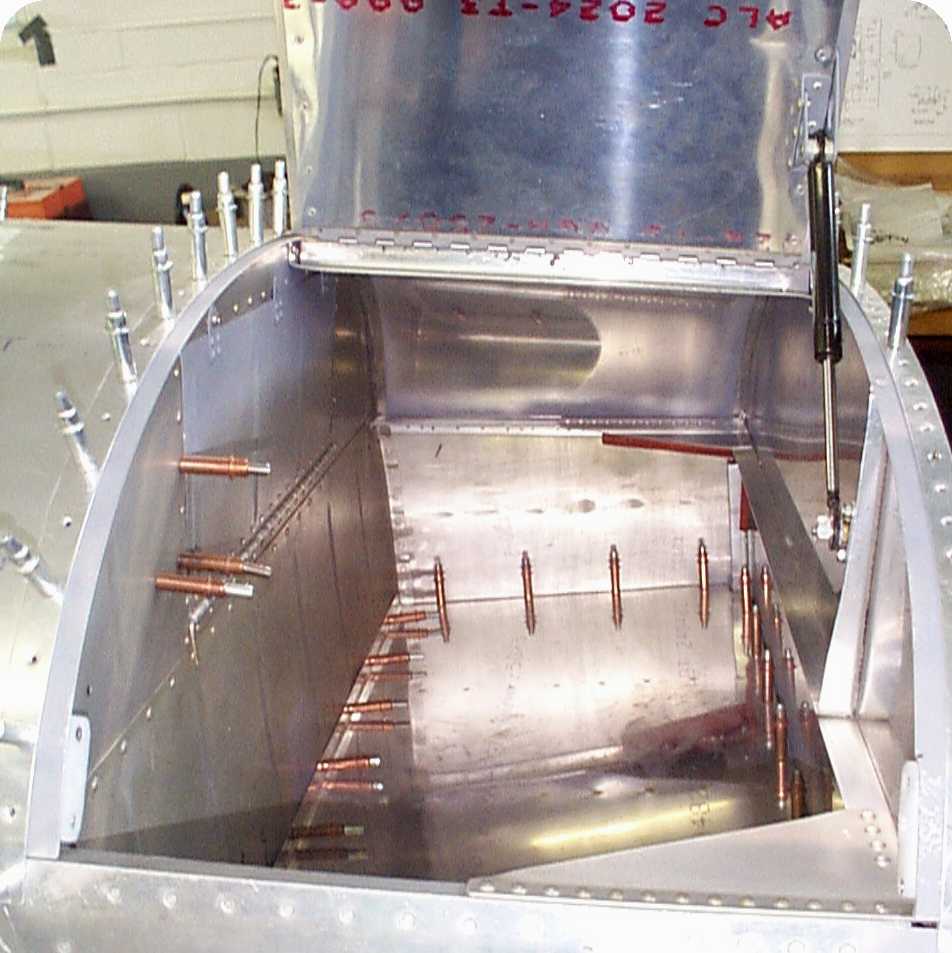

PostPosted: Wed Sep 07, 2011 3:53 pm    Post subject: Pre-punch baggage door Reply with quote
As far as the selection of a strut to hold the door open/closed, I found a sweet unit at McMaster-Carr that fits and works perfectly. Here are the details from my log entry:
Page 1:
http://www.mattsrv8.com/users/display_log.php?user=MattsRV8&project=638&category=2973&log=93336&row=235
Page 2:
http://www.mattsrv8.com/users/display_log.php?user=MattsRV8&project=638&category=2973&log=93337&row=234

PostPosted: Wed Sep 07, 2011 7:10 pm    Post subject: Pre-punch baggage door Reply with quote
Michael, yes you have to drill and rivet the bag door while its mounted if you want it to fit right and tight. Also you have to get inside and under to pull rivet the door back skin on which holds the door shape. I put the pedals in and out a bunch of times before finish. Fill and bleed the brakes so you know all the tubes and parts work and don't leak then disconnect to the last thing, but you'll have to get inside probably more than once. Best regards, Bill of Georgia RV-8a, 17 hours into phase l
