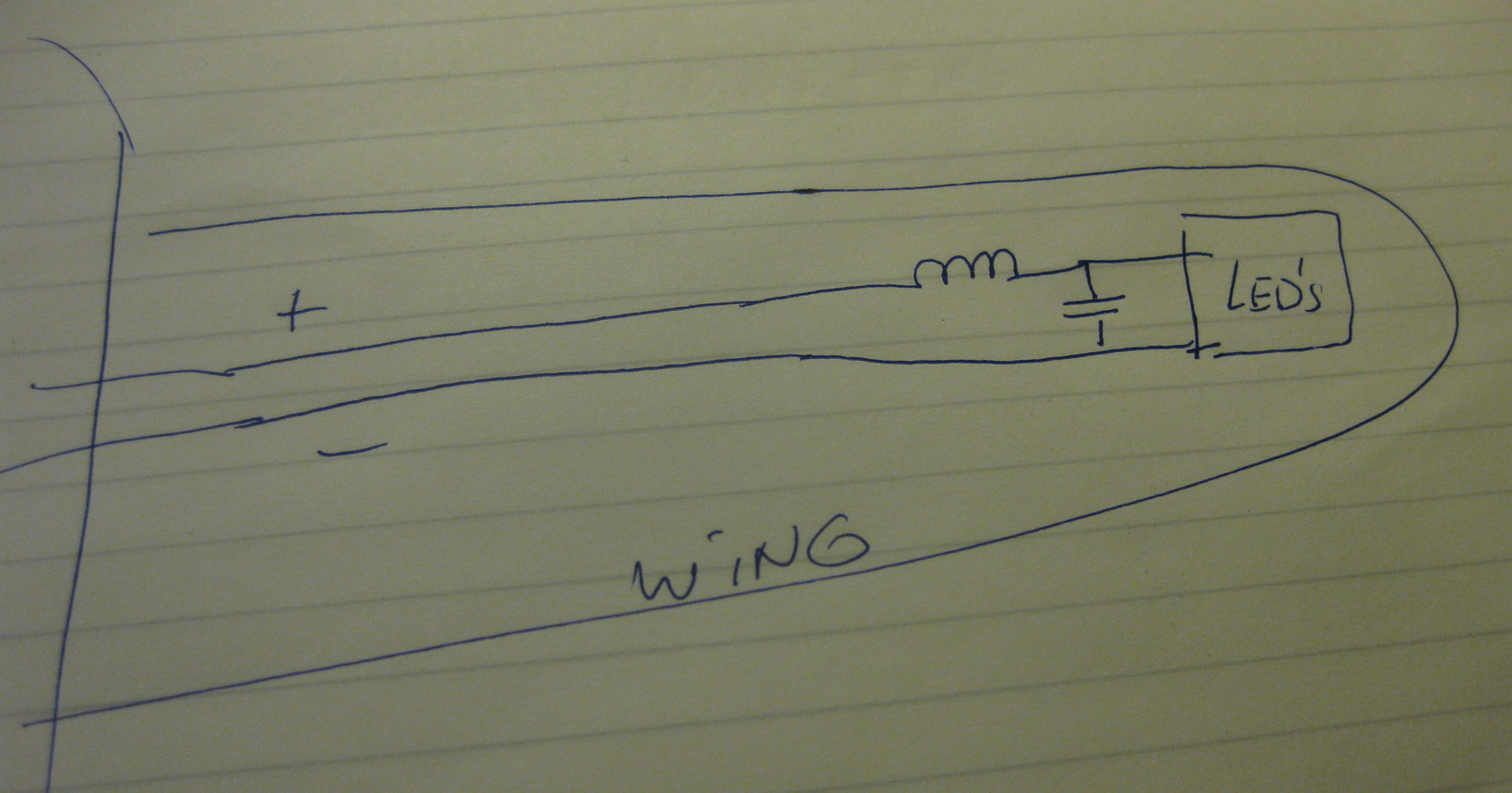

The problem is that you have to use long powerlines from the main switch to the wingtips. So in the wingtips are the "transmitters" (the switched power supply's to make the led's working). These long powerlines act as an antenna and dirty-up your system. In order to surpress this transmission you have to block it with a choke (i guess 20-30 turns of 22awg wire and a condensator of 10 micro farad). See drawing...good luck.

PostPosted: Sun Oct 02, 2011 6:23 pm    Post subject: Aero LED'S Reply with quote
Electrolytic capacitors are almost never a part
of a solution for reducing attenuation at radio
frequencies. The value of inductance for what
I presume is an air-wound, helix of wire is only
useful as an attenuator at radio frequencies.
I'm not suggesting that this approach did not
work for somebody . . . they were on the right
track for a practical filter. But without knowing
the spectrum of energy for the offending noise,
this filter was far from optimal to the task.
In the instance where a filter was added to the
Buck Pucks . . . see
http://www.aeroelectric.com/Catalog/AEC/9051/9051-700A.pdf
the components were selected to attenuate radio
frequency noise reported by disappointed users
of the Buck Pucks. A hand-held transceiver held
close to an operating LED driven by a Buck Puck
was bombarded by a substantial noise sorce.
The capacitors used in this case are rather small
as is the inductor. The inductor was not selected
for it's ability to function as a high quality
resonance but as a lossy impedance. It was desirable
that any VHF+ RF appearing across the terminals
was converted to heat!
It seems likely that the AeroLED study will
produce a similar finding. But until that
finding is verified, moving forward with any
filter experiments could be a poor use of time
or offer a risk of less than optimal performance.
