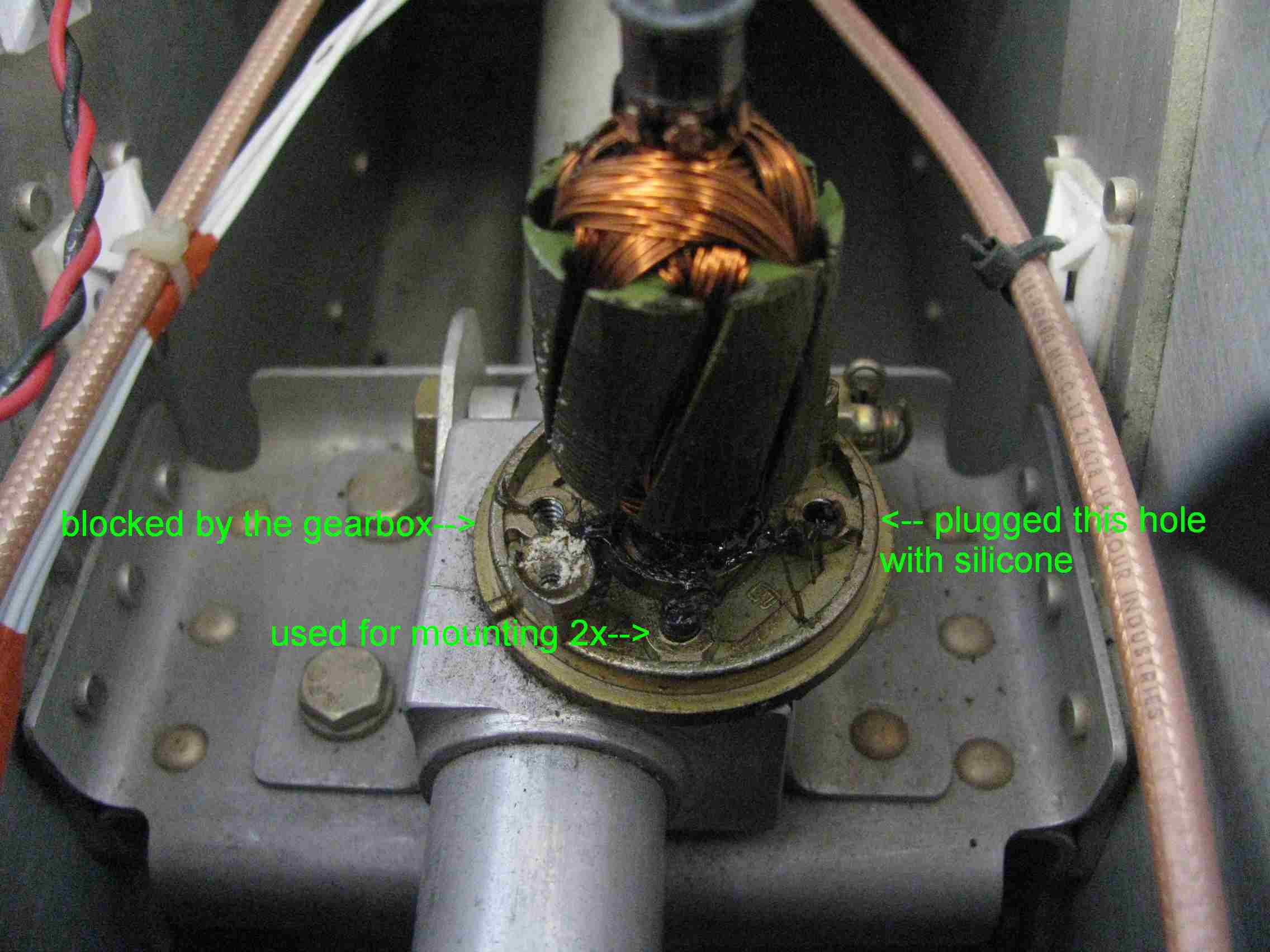

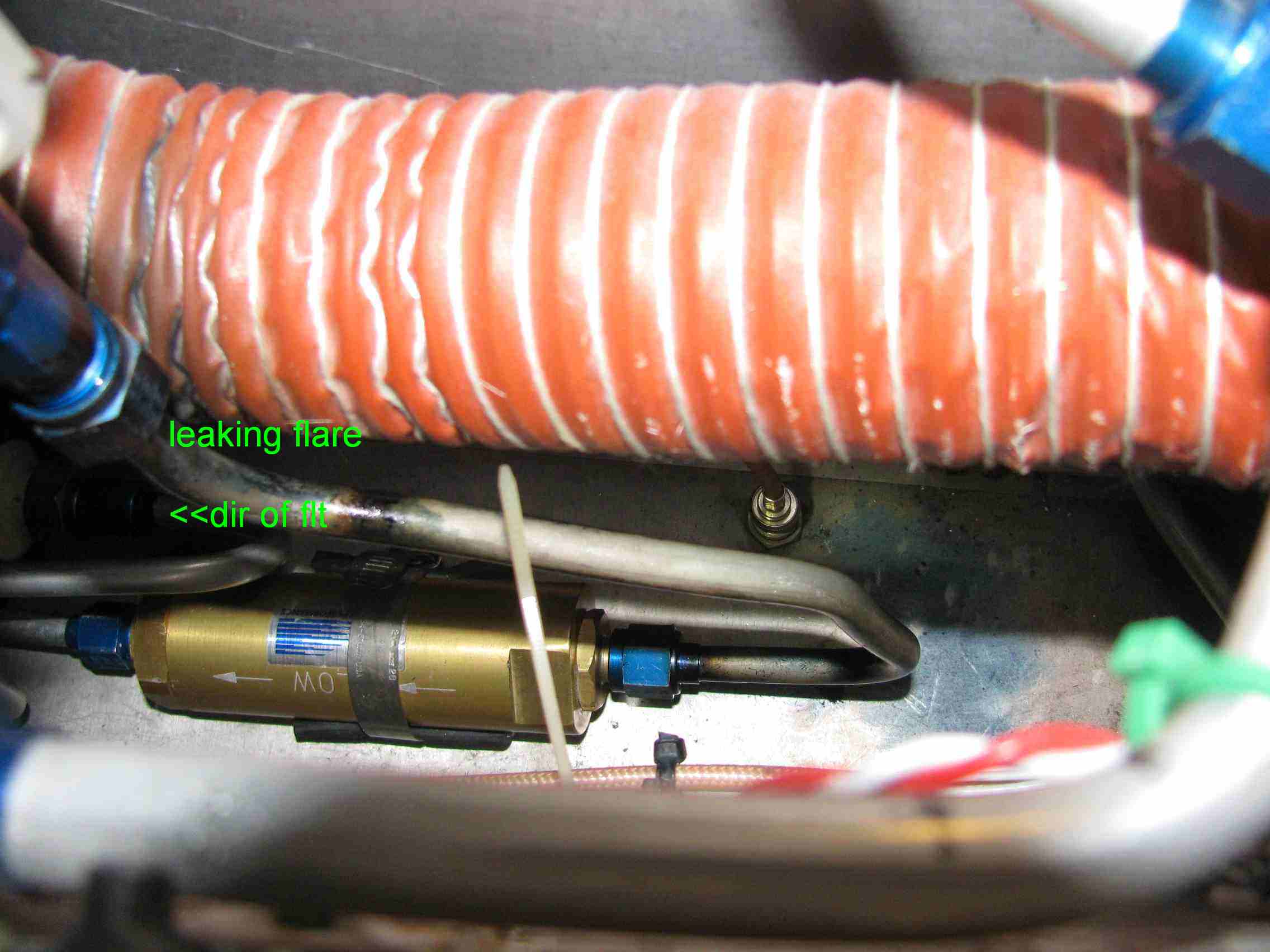

The other day on preflight I noticed a faint fuel smell in the cockpit.  I talked myself into thinking it was nothing, and the next day it was stronger.  Time to investigate.
I found a pretty good drip coming from the flare at the bottom of the fuel valve.  There was some staining and a little dampness on the bottom of the tunnel, easily fixed with a flex hose.
It got me thinking again about the flap motor as an ignition source.
To date there have been at least three RV-10 cockpit fires.  Now of course keeping the fuel where it should be is key, but once it gets out, keeping it from igniting seems like a good defense.

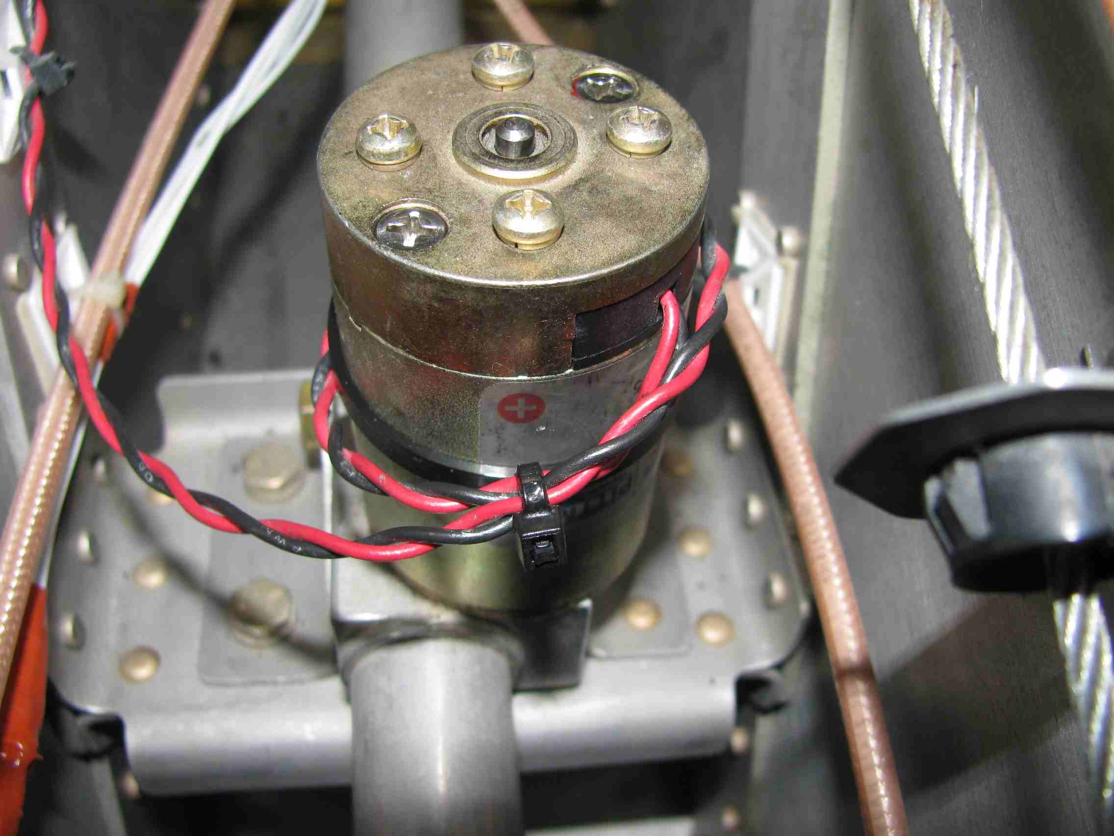

The flap motor in my RV-10 is described on the attached data sheet.
There are four 6-32 threaded holes in each end of the motor.  Two are used for mounting, one is blocked by the gearbox, leaving five that expose the brushes to the tunnel atmosphere.
I wiped a little blob of silicone into the unused hole on the bottom of the motor, and put AN515-6R4s and split lock-washers in the top holes.  The motor works fine, no issues with clearance.  There's a picture of the motor with the outer case taken off, which I wouldn't recommend doing.  Now I realize it's not necessary.  I just included it to identify which hole was plugged with silicone.  Putting the brushes and shims back together wasn't much fun.
I kind of doubt that this makes the motor officially "explosion proof" but I don't see how it hurts and hopefully it's a tiny bit safer.  Fixing the leak was the best solution.

I have an Andair valve with an AN fitting screwed into the bottom of it.  The leak was between the AN fitting and the flared tube that I fabbed when I upgraded to the Andair about three years ago.
I replaced the leaky flared tube with a flexible teflon hose.

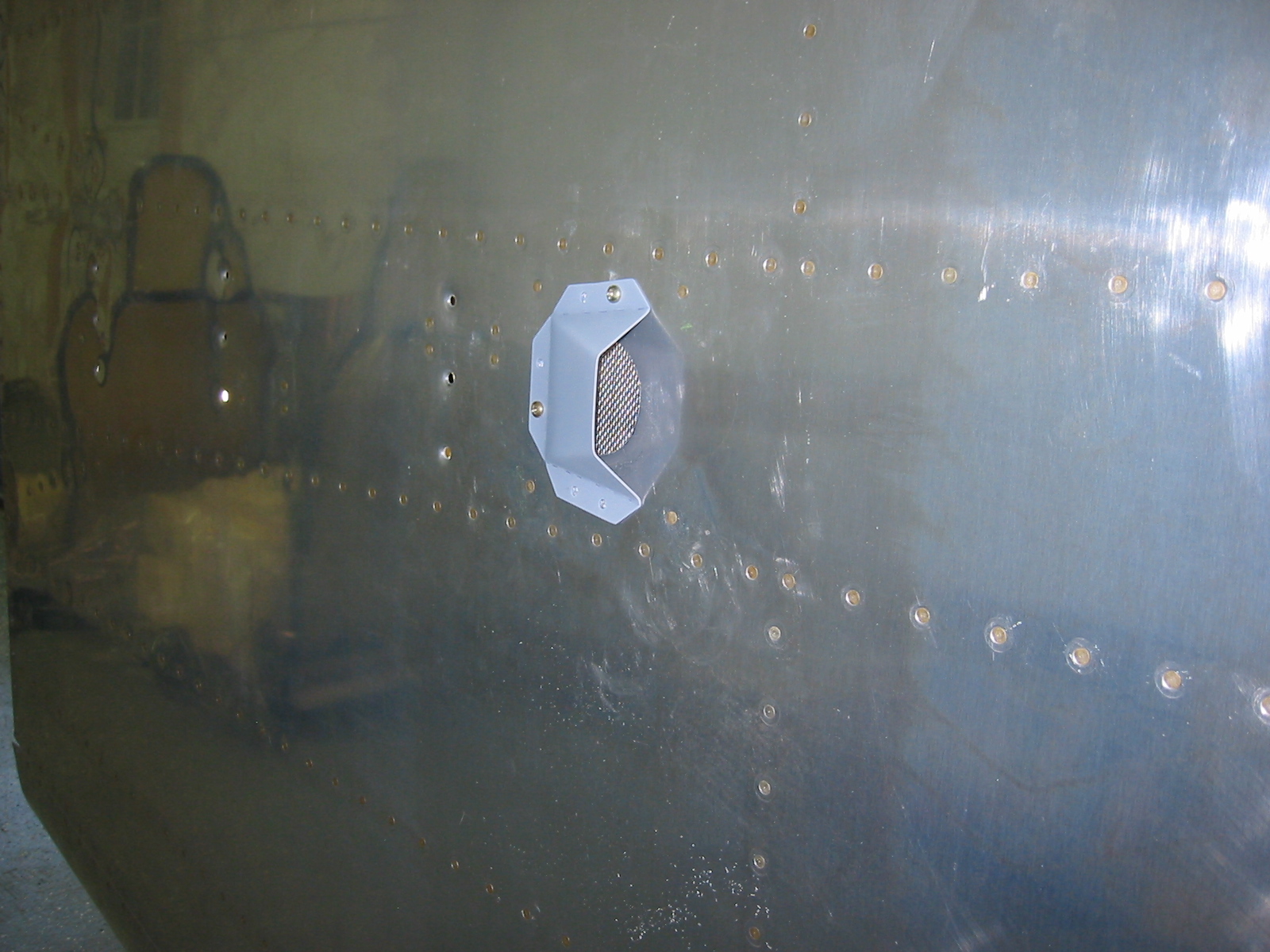

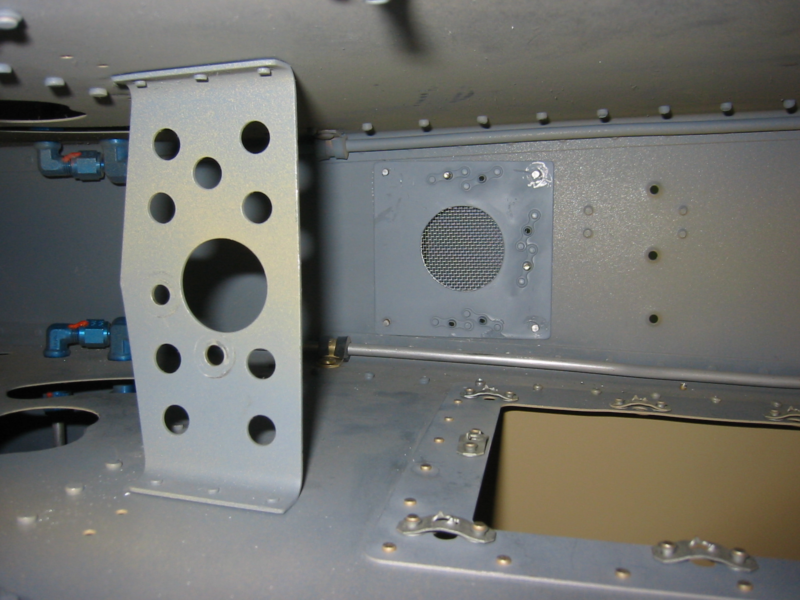

Thank you for the information on the flap motor. It's a step in the right direction and I plan to make the changes.
Many aircraft designs also provide a means of venting areas that may accumulate fumes (fuel/hydraulics/etc.) from the aircraft. Larger aircraft are required to have positive ventilation in these areas. Although the RV-10 doesn't have any major issues in this area, I decided to take some proactive steps to provide some separation between the fuel lines and the rest of the tunnel and also add a small amount of ventilation. I installed an aft facing vent on the bottom of the fuselage, directly under the fuel valve. This should create a small amount of negative pressure in the tunnel and draw any fumes out. I plan to enclose the area that has fuel lines/pump/filter with some easily removable insulation material. The insulation will be self supporting, easily removed and secured with velcro. Again, like the flap motor upgrade, this is not a perfect fix, but should improve the odds in case there is a small fuel leak. Attached are pictures of the fuselage vent.

I'd like to find a direct replacement for the standard motor that is brushless.  That's always been my thought.
I suppose I could call the manufacturer and see if they could sell an equivalent motor in brushless form.

I'm pretty sure the tubing was 3003.
--Dave
On Oct 21, 2011, at 16:54, "John Cumins" <jcumins(at)jcis.net> wrote:
[quote] Dave
One question on the tubing. Was it the 3002 tube van supplies that’s real soft, for was it 5052 standard certified aircraft tubing.
I have seen the 3000 series tubes leak over time way more so than the 5052 type.
Also, I think you are dead on with the plugging of the holes on the flap motor. Great idea. I will for sure do that on mine when I get to that point
