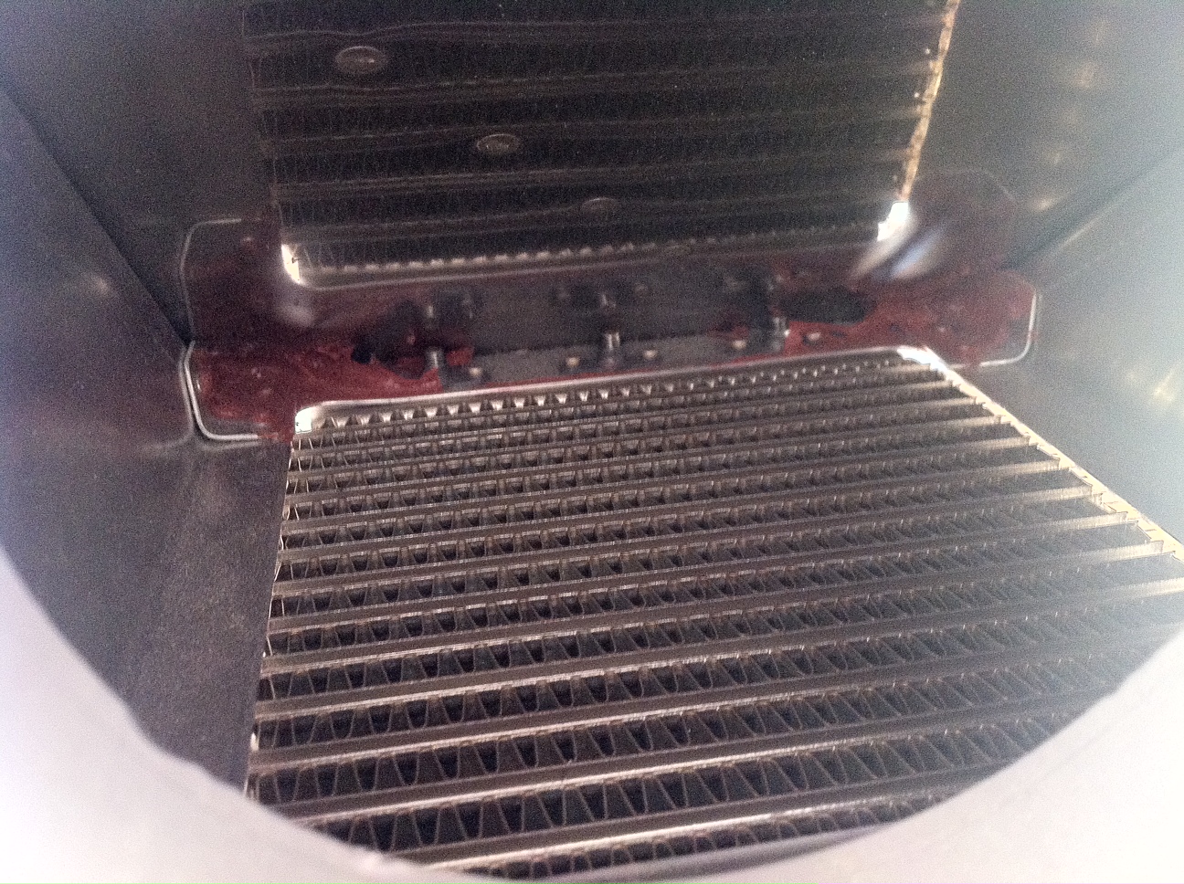

Last night I installed the oil cooler onto the airbox and noticed it's a very leaky setup.  Attached is a photo of the *inside* of the airbox and you'll notice some big gaps on the corners and even a gap down the sides.
Has anyone sealed these?  I'm thinking of putting a fillet of red rtv along the edges and a blob in the corners to keep the air moving through the cooler and not around it.
Phil

That's what I did.
Linn

Phil I sealed mine but used a silver RTV high temp which does not show as much as the red
Geoff

That’s what I did. Lot more of the red high temp RTV on the baffles and sealing around the engine as well.
Byron
N253RV still in phase one but loving it more each day.

One the topic of baffles and installing RTV.  Has anyone found an applicator that's long (~12 Inches) and skinny (~3/16") for pumping the stuff into some pretty tight spots?  It seems like there could be a pneumatic applicator or a mechanical plunger type that would get you into some pretty tight spots.

Grab a plastic straw from Mc Donalds and cram it on the end of your applicator and reach as far as you want.
Gary Specketer

I did the same.
Dave Leikam
