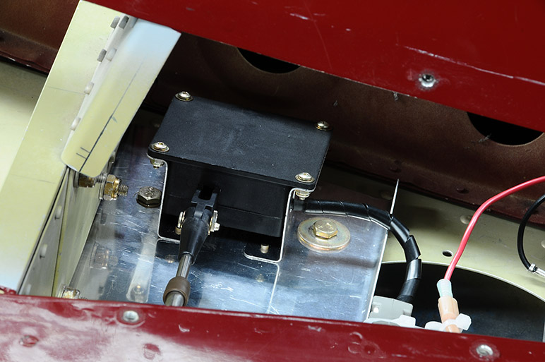

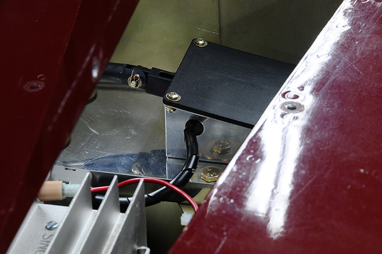

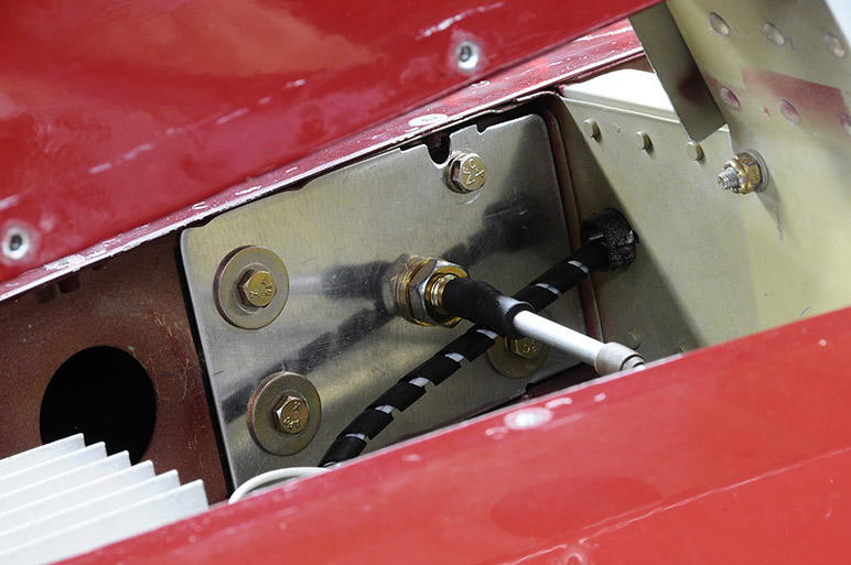

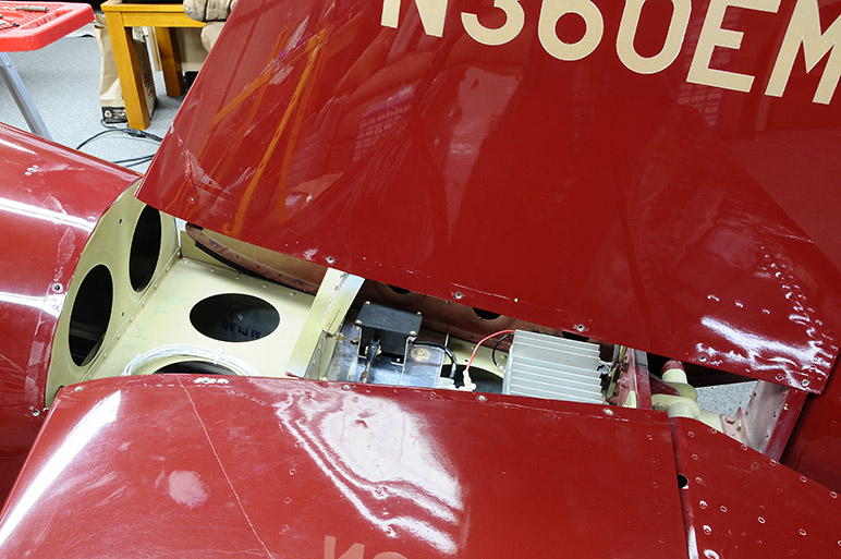

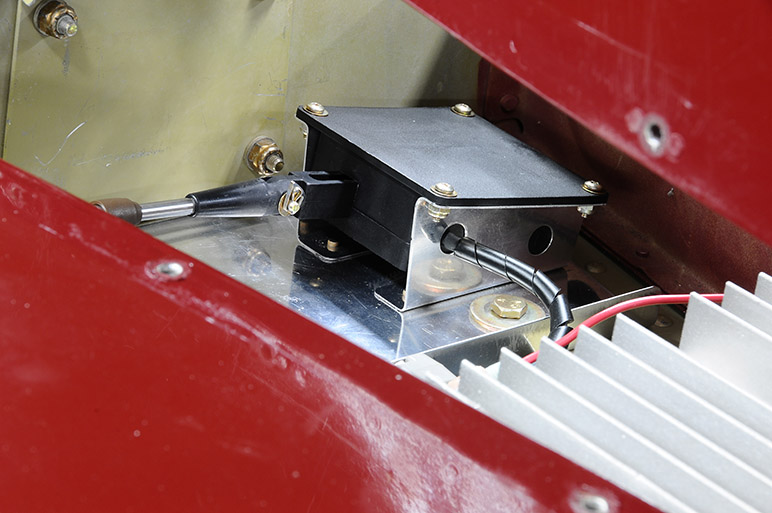

Hi Charlie,
I just did this very thing on my circa 1994 RV-6, The Flyer. I installed a servo under the fin and ran a short, standard green control cable to the original trim tab and horn. Works GREAT! Attached are some pictures of the retrofit.
Matt

Thanks Matt; the trim tab end remains as Van designed it? Do you recall
where you got the short control cable?
Charlie
