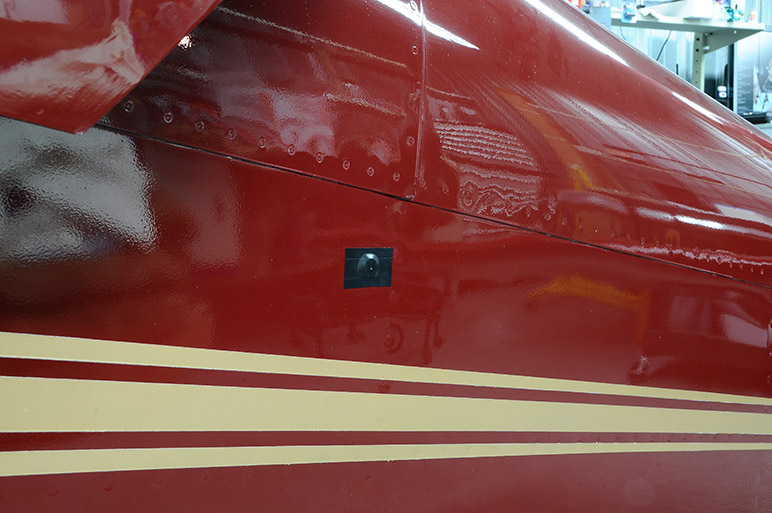

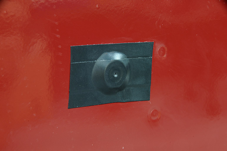

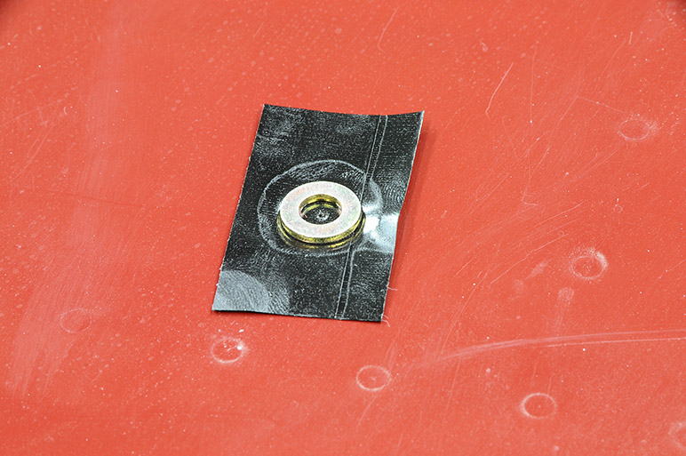

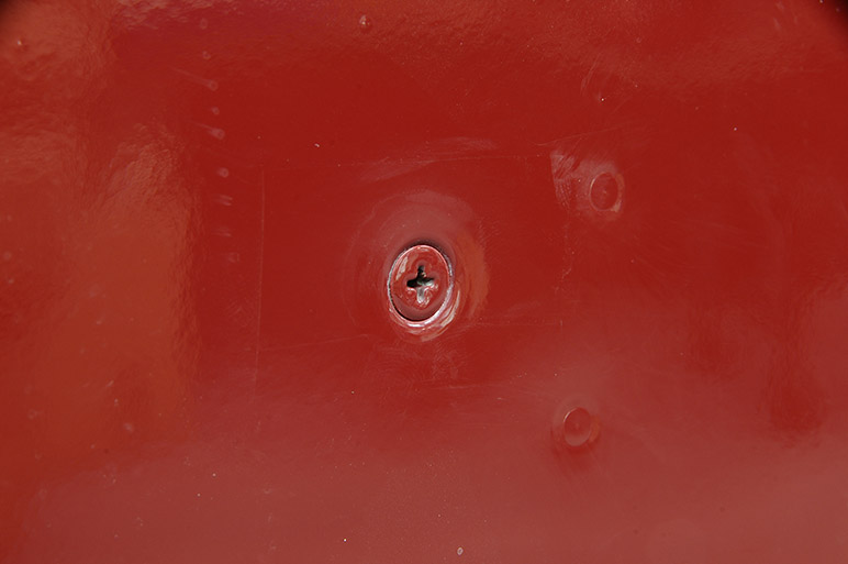

Listers,
Thank you for all the great suggestions on resolving this airspeed issue! I took a look at the static ports on the RV-6 today and found that they are done using a flush head screw with a hole drilled in the center on either side of the fuselage. They do *not* protrude from the side of the plane at all. They are totally flush (see attached picture). Just for fun, I whipped up a couple of quick test deals using a 3/16" washer and some electrical tape. I poked a 1/16" hole in the center of the tape and then put the washer centered over the static ports on both sides of the fuselage (see attached pictures). Then, I went flying on this beautiful December 27 day in California!
I didn't have time to do any real scientific multi-leg testing, but I was amazed that the True Airspeed is now falling in a much more believable range compared to the GPS-derived ground speed. On one cross-country leg, I had an exactly 90 degree crosswind component and the True Airspeed and GPS Ground Speed were tracking exactly the same. Yahoo!
Obviously I need to do some additional, more scientific measurements and probably come up with a slightly more "permanent" washer arrangement, but the early returns are very promising! Smile
Thanks again for all the great feedback!
Matt
