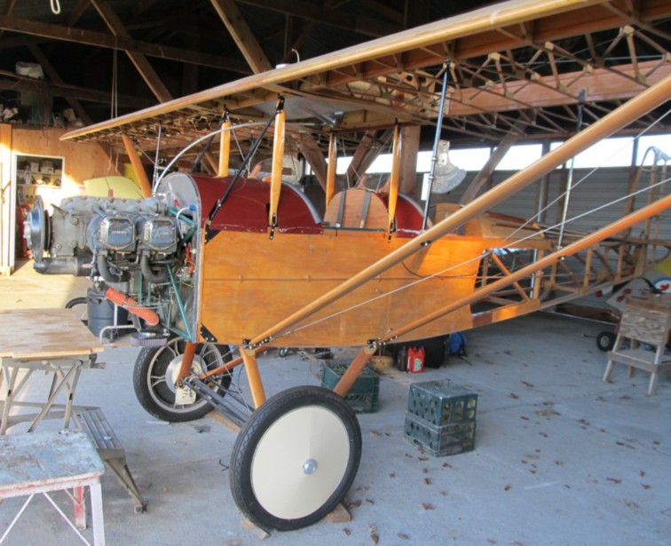

Clif; thank you. And I know I'm getting way off-topic here, but seeing the nice wood cabane struts and other details on your airplane, in Canada how does your CAA (or Transport Authority, or whoever it is that deals with experimentals) look upon deviations from the plans? In some other countries, every single little thing has to get approval or it won't fly, literally. How much leeway do you have?

PostPosted: Sun Aug 19, 2018 11:41 pm    Post subject: Bronze-Brass Bearings Reply with quote
Lots! There was even a Piet some years ago that got passed
with a declared gross of 1500lb!
You have your DAR, we have MD-RA.
The inspectors are fellow builders. A couple of local ones
have built wood AC and even designed AC. I don't expect
any issues. I've had it on display at our local RAA June
flyin and show. Two of these inspectors have looked at it
and commented favourably.
On a side note. Transport doesn't give a s--t if you fly through
a barn. Just DO NOT, however, carry a passenger while doing so!
Clif
