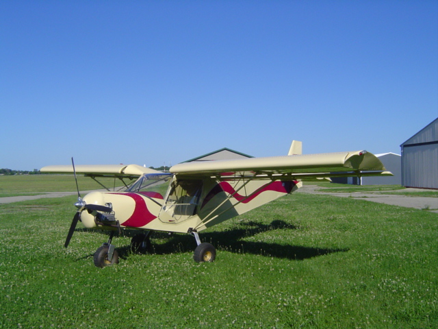

I had the same problem looking for a cowl that would work. Never did find one, so I made my own. I never did get one that looked good.
I also had some issues with the re-drive system. Took the whole shooting match out and installed a Honda/Viking engine and cowl. Much better setup if you ask me.
Make a reasonable offer and you can have the whole FF plus whatever else I have for a VW.
