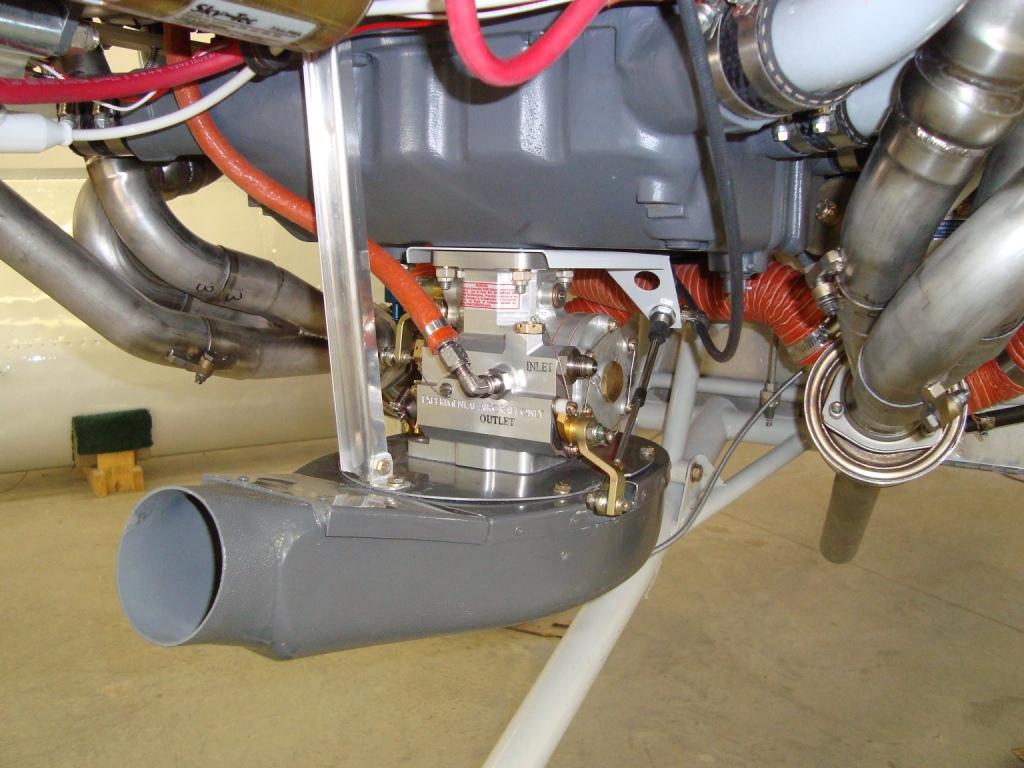

All,
I had three air box top plates crack on my RV-8A. I solved the problem by adding a support bracket to keep the box from bouncing around (the prop was dynamically balanced). I did the same for the RV-10. The RV-10 air box is modified to take the taller K&N E-1000 air filter – the modification is simply to invert the air box cover. This box is also modified to fit the James Cowl.
Forwarded for your information.
