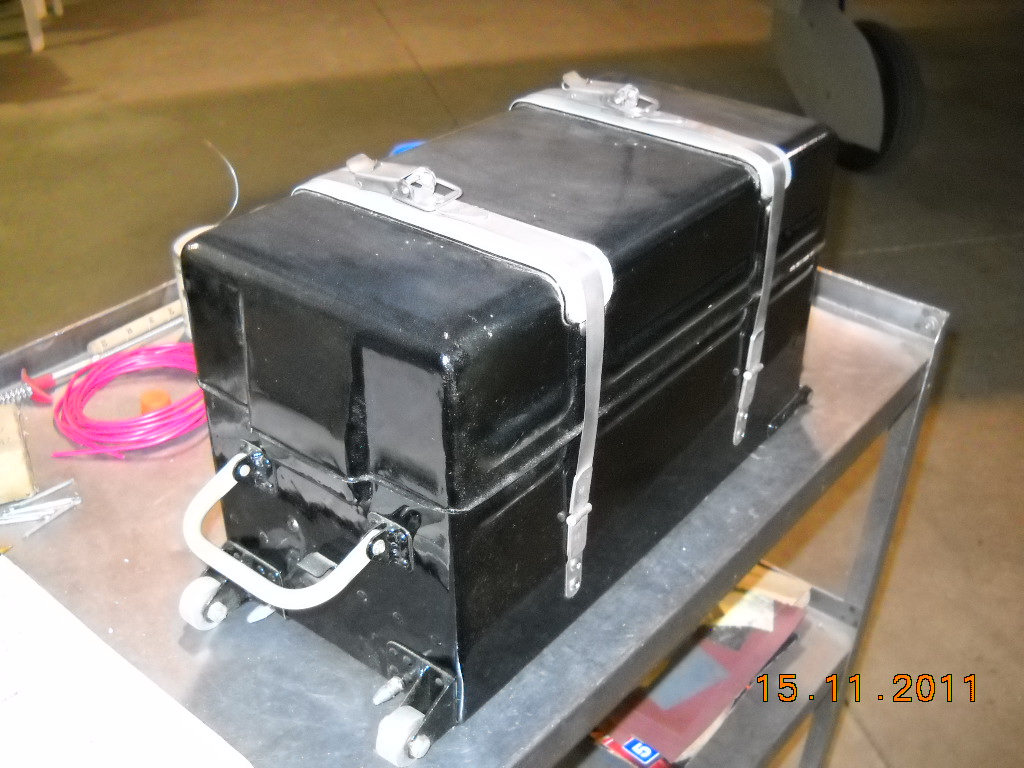

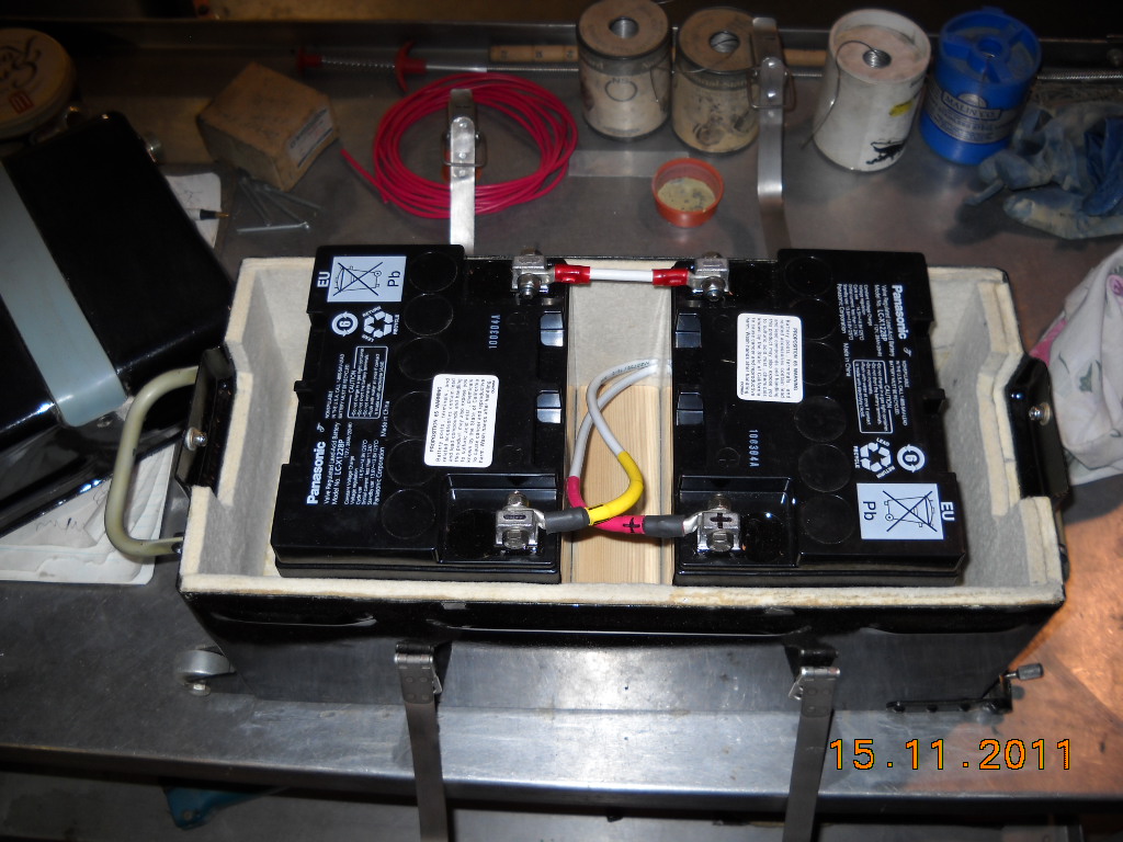

PostPosted: Sun Jan 08, 2012 10:35 am    Post subject: Yak Battery box Reply with quote
Hi Anthony;
Just happen to have a pic of my CJ6 battery box with two Panasonic LCX 1228P batteries installed. Horizontal retention and spacing provided by wood blocks attached to the box.
Unfortunately did not take a photo of the inside of the cover which has two wood blocks attached for vertical retention.
Walt

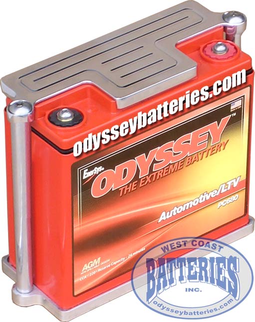

PostPosted: Sun Jan 08, 2012 1:02 pm    Post subject: Yak Battery box Reply with quote
Hi Ant.,
attached is a picture of the
Odyssey PC680 with the
metal jacket and a racing car
hold down billet.
Hope that helps.
cheers
Elmar
