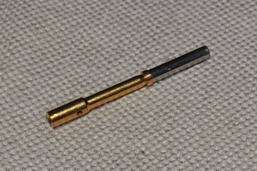

G'day all,
Has anyone found a convenient after-market supplier for the D-Sub pins with
an oversize butt that Garmin include in some installation kits? The Garmin
part number is 336-00023-00 and they're physically longer with a larger
crimp cup to fit 18 AWG wire ...
I want to parallel looms into a single connector ... and it seems that
paired 22 (and perhaps 20) AWG wires will fit in these pins. Sadly I only
have three of them Smile
Kind regards, Stu

I searched for them a few years ago and had almost no success. The only
source I found wanted $5 each. You could try getting them from Garmin
through one of their approved avionics shops.

Most every shop has extras laying around because they almost never use all
of them supplied. Gimme a call if you need a few.
BTW, unless the runs are long an AWG20 wire will work fine in place of an
AWG18.

OBTW depending on the crimper you have, you may need a different
positioner to crimp the special pins. Another option for your
application might be to join your two wires into a "Y" either with a
soldered joint or a pidg fastener then connecting the single end to your
DB-X. It would be bulkier but easier.

PostPosted: Wed Jan 25, 2012 9:29 am    Post subject: Larger D-Sub pins Reply with quote
AWG18.
You beat me to it my friend. I will also suggest that it's
perfectly okay to peel a few strands out of the "too large"
wire to get them all into the 20AWG crimp cup of a standard
pin. You'll have to leave the bare strands exposed over a
greater length because the insulation will not go down
into the wire opening of the connector. Experiment with
an extra pin and a chunk of wire to establish the new strip
dimensions.
When somebody calls for putting overweight wires into
a d-sub connector, the design goal is to REDUCE WIRE
PATHWAY IMPEDANCE. Putting the larger wire into the
pin does not increase the pin's current handling
ability. Hence my suggestion for peeling out extraneous
strands is not a technically 'evil' thing to do in
terms of the physics. It would have an immeasurable
impact on design goals that called for the larger wire.
I think this is preferable to the FAT pin. It adds
no bulk to wiring immediately behind the connector
and leaves less exposed conductor.

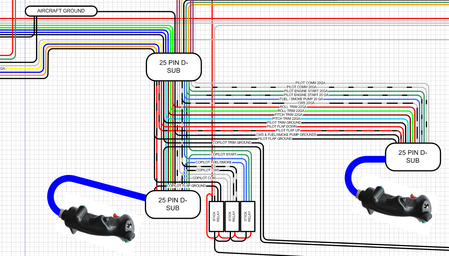

Thanks for your help everyone.
The current-carrying capacity of the wires isn't a factor in my installation
.. they're only carrying signals or minor currents off to relays. The
Infinity grips have a mix of 17 different 22AWG and 20AWG wires each, but I
have already terminated each of those wires at a 25-pin D-Sub connector. The
two grip functions are wired in parallel for the most part, so my aim is to
connect both FWD and AFT grips via a "Y" loom terminating at one 25 or
37-pin D-Sub connector to mate with a main central loom. The "Y" loom will
be fabricated entirely of 22AWG wires (disgregard the AWG ratings in my
pic), but I thought it would be more convenient to use 18AWG pins where the
wires come together at the top connector, rather than trim or fold away
strands so that 2 x 22AWG wires fit into 20AWG pins. As Bob said, 2 x 22AWG
wire insulation won't fit in the connector and makes pin removal difficult,
so I thought it would also be more convenient to use 18AWG pins for this
reason (but I haven't tried removing them).
I found 18AWG pins at this site (bottom of the page), but they're asking $2
each ... http://www.aircraftelectronicssupply.com/garmin_install_supp.htm
Cheers, Stu

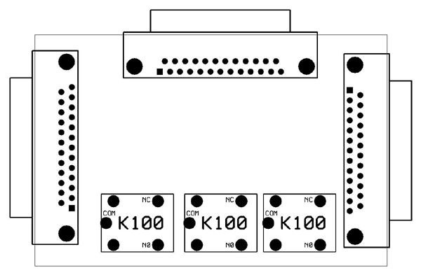

PostPosted: Thu Jan 26, 2012 9:28 am    Post subject: Larger D-Sub pins Reply with quote
Hmmm . . . hadn't thought about that. I'm not sure they
CAN be removed with the legacy extraction tools.
Given the complexity of your stick grip wiring I think
I would give serious thought to building an etched
circuit board for the relay-deck and stick-grip-junction-
box.
Your mating connectors then solder to the board. The
board can mount the relays and perhaps a speed adjustment
system. the mating connectors get 'really clean' with
respect to materials and techniques.
Express PCB has free software and really reasonable
prices on double-sided, plated-thru boards laid
up and ordered via your computer.

stuart(at)stuarthutchison
PostPosted: Thu Jan 26, 2012 6:57 pm    Post subject: Larger D-Sub pins Reply with quote
Thanks Bob,
Good idea. I think I'll go ahead and make a parallel wire loom now, then replace it with a PCB later (when I have more time) ... after all, we never really stop working on our boys toys do we !! Smile
