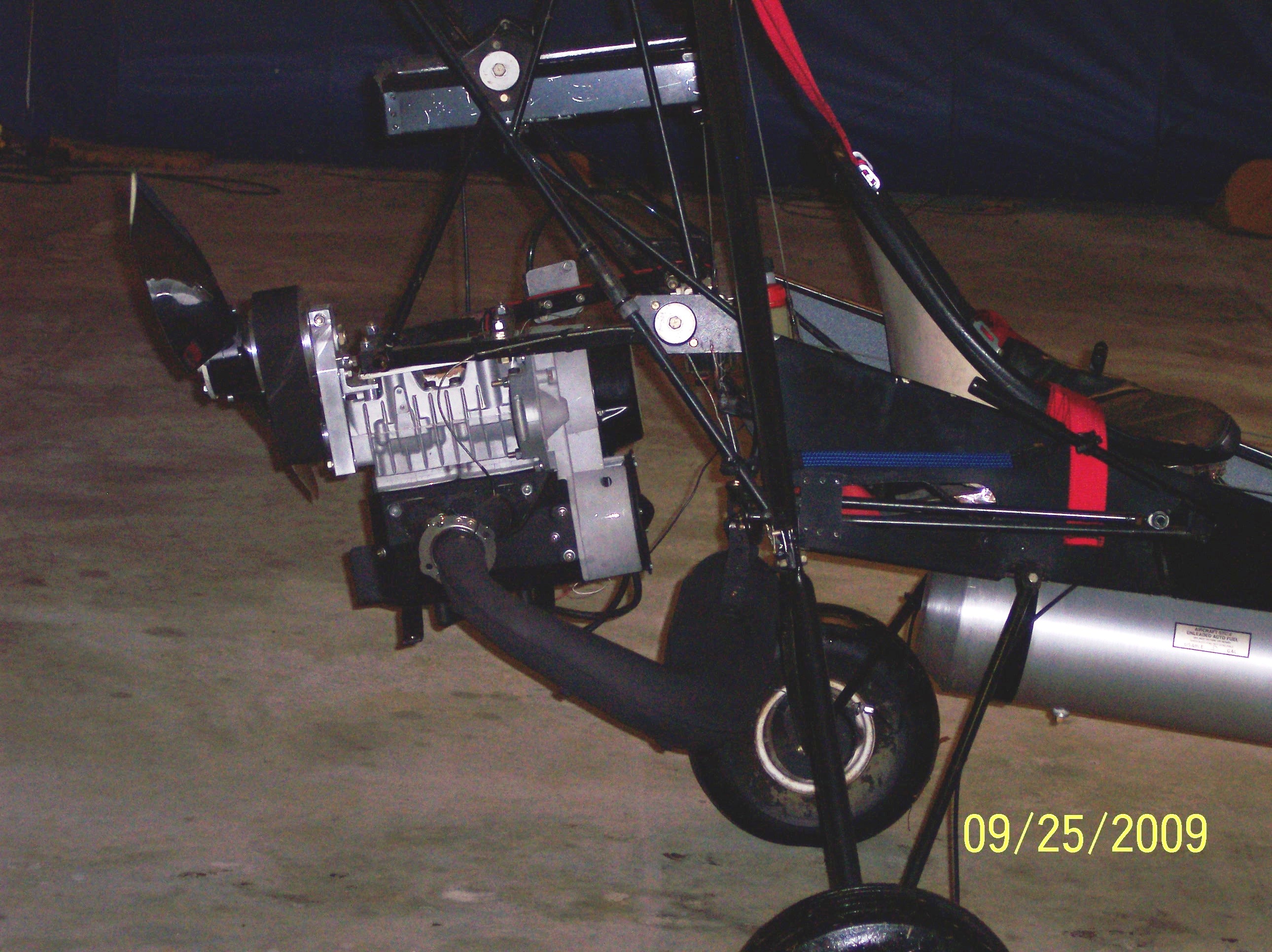

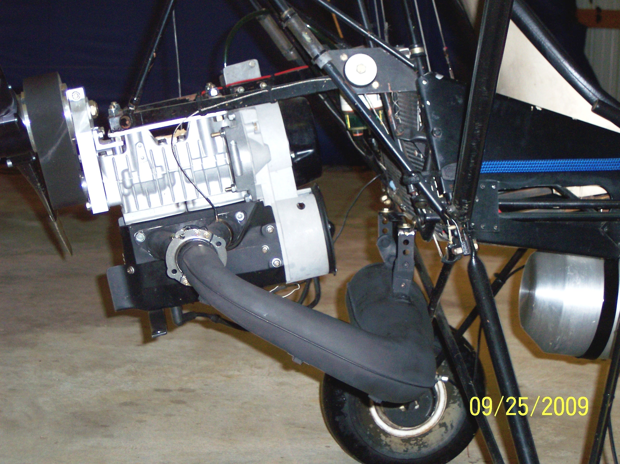

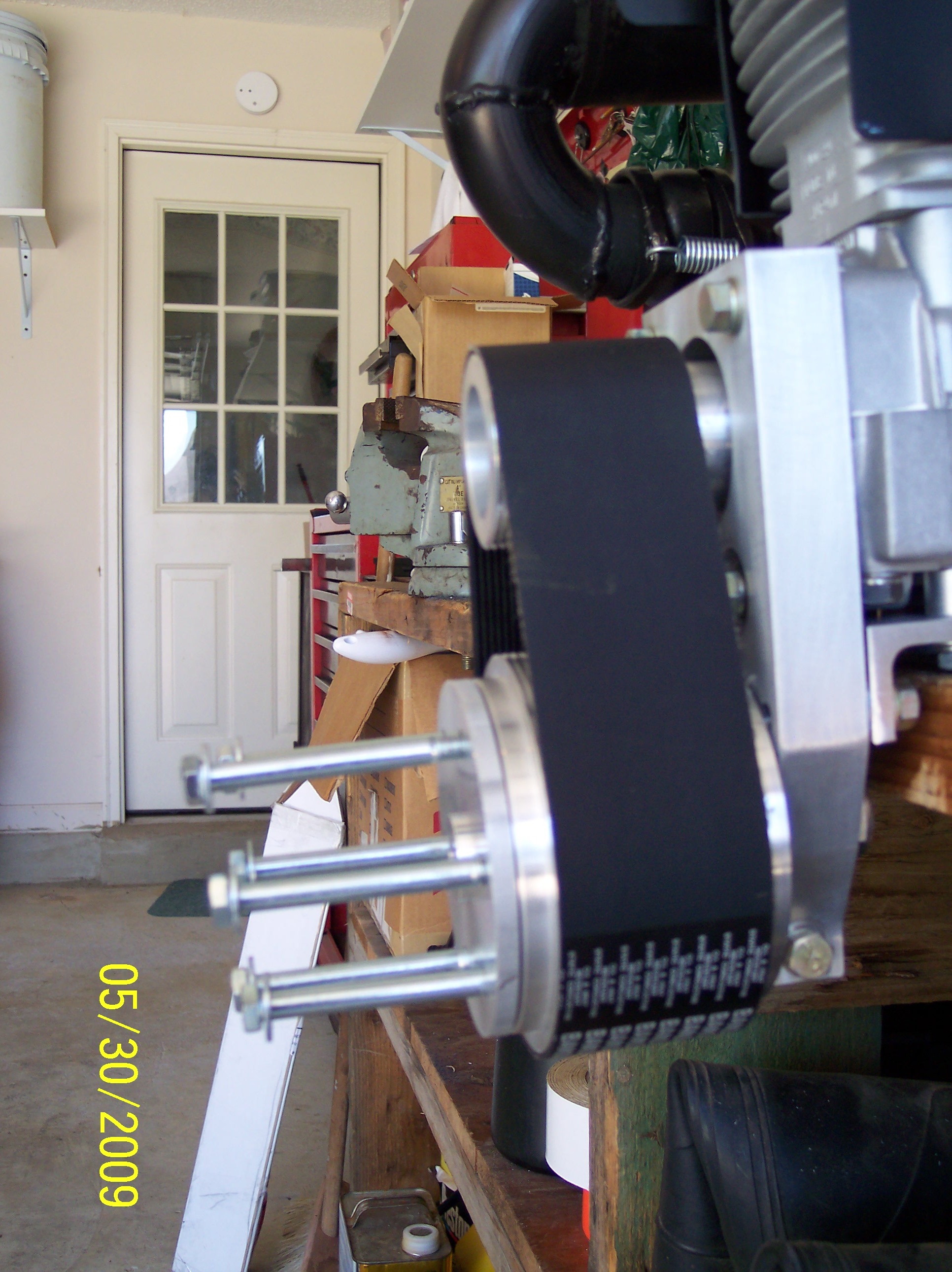

Use the 2.6 or more ratio if you can and you will like that Micro-V drive. And 35hp will fly a Firefly quiet well as Jack Harts post prove and did pretty well on the Ultrastar. Wish I had taken a picture of the mounting plate. It was a 30 Minute change out to switch engines which allowed me to do lots of comparative testing.
I did a lot of work on an Ultrastar to find a good replacement for the Cuyuna UL-II-02 and I was happy with the 440A BUT it is only 35HP equivalent to the 377 that used to be on a lot of early Firestars. IT is not 40+HP as J-bird or anyone else trying to sell one will state. You can go to the Ultrastar Yahoo group and read the archives about my experiences. The Micro-V worked well, I had the provision crankcase and it mounted right to the engine. I will try to get some pictures attached for you. You do NOT want the 38mm blue cap carb, just use the 32mm VM and it will jet up and run well. I used the Ultra Prop on the Ultrastar for its durability but don't recommend it for the firefly, IVO or wood would be better. And you need to use the Chaparell exhaustt pipe, my weight all up was 80#. I did not have electric start though. Mine ran well and I put 140 hours on it before selling it at Sun-N-Fun 2010. Youtube at thumperfour and you can watch some video at sun and fun. Here is what I posted back then but you can do a search of the Ultrastar Yahoo group and search 440A and read more.
I'll try to keep it short. I wanted to get better climb since I am heavy at 225# and I have a BRS installed. History first. The Cuyuna was running well at all of the proper temps and the plane flew well, 300-400fpm climb at around 70 degrees and 400ASL. As the summer was approaching I had heard that the Cuyuna had cooling issues and it was running at 400 CHT already. So I purchased the brand new Kawasaki 440A with a provision crankcase so I could buy the compact Micro-V and have it be a simple bolt in place for the Cuyuna. Goal accomplished. I can swap engines in less than an hour. Starting with the Kaw I bought the 3 blade Ultra prop 54" and an ACS side mounted exhaust so it mounted to the engine like the Cuyuna did. I also ordered it with two prop pulleys, 2.4 and 2.0. That way I could compare the Culver prop to the larger props. With the ACS exhaust it would not spin up the Culver 50x30 prop to about 5800rpm with the 2.0 ratio. Way less than the Cuyuna. I had the same issue with it not spinning up to proper RPM with the suggested pitch blocks on the Ultraprop and the 2.4 ratio. I bought a 54" 2 blade Powerfin and had the same issue. I am only guessing here that it gave me about 30hp with that exhaust. After going to flatter pitch blocks it would fly with the Ultraprop but the climb was very marginal. I then purchased the Chaparell exhaust recommended by the trike guys who fly a lot of the Kaws. Big difference. I had to change pitch settings as now the engine would scream past 7000. After getting the pitch blocks set properly and swapping exhaust back and forth it would show a 600rpm improvement with the Chaparell exhaust. That exhaust is 7# heavier but worth it. Now the Kawasaki weighed exactly the same as the Cuyuna at 80# complete but without any prop. I am guessing 35hp now. But I have yet to reinstall the Culver prop with the 2.0 as an equal test. I was flying and having fun. I plan to do it this month if the weather will settle down. I want to know just what the power of the Kawasaki is. Now the advantages of the Kaw are; lightweight, smoother at idle (same at flying speed) no steel cylinder liners it has all aluminum cylinders with Nikasil coating so it is more forgiving to seisures. The Kaw parts are available at any smowmobile shop. Forget the blue cap carb in the 38mm size it is hard to tune and gains nothing at our RPM. I installed a 32mm and it tunes fine. Now the bad about the Kaw, at the proper 1200 EGT and plug color it runs 430-440CHT on climb, higher than the Cuyuna. I installed the EGT prob where the manual from J-bird recommended 2" from piston skirt. This engine is sensitive to carb jetting in that IF you run it richer to reduce the EGT there is a noticable difference in power. The engine is peaky with this exhaust, there is a certain RPM where then engine will fall off the pipe and a very small increase in throttle and it will hit the pipe. It is managable but keeps me from flying in that rpm range. Best climb is at 1200 EGT and cruise near that and you will get 2.5 to 3 GPH at 50 airspeed. Without the steel liner for the piston I feel safe those 430+ head temps are OK. Try running it richer and you lose performance. I had good luck with J-Bird Jim other than him being long winded and going off on tangents and being stuck in the 80's for oil mix and technology lag. I have run both engines on Castrol TTS synthetic and plan to continue with it. I would have no issues now running the Cuyuna but I would buy the new Micro-V reduction in 2.4 ratio so I can run the larger prop. 2" spacer would be required to lower the engine but would add thrust and keep my climb rate near 500fpm even in the summer. Hope this helps but feel free to call me for more details and opinions.
Long winded but hopefully valuable to someone. The Kawasaki is a good alternative to the Cuyuna UL-II-02 but not required. Homer had it right if I just wasn't gravitationaly challenged so much.
Dennis
More information from testing is now available.
I am just passing on some more information I learned today. I re-installed the Culver 50x30 prop with the 2.0 pulley. I was curious what the actual HP of the Kaw 440 is since I have the pipe and carb tuned to 1200EGT on climb like I did the Cuyuna. With the 440A, 32mm Mikuni, Chaparell Exhaust and the Micro-V 2.0 redrive the engine would spin up to exactly the same RPM as the Cuyuna under the same weather conditions. This tells me that any claim to it being 38 or 40 hp is
just wishfull thinking. I only have one other test to complete and that is
trying the larger 38mm Blue Cap carb. I will try and get around to it this next month. I really don't think it will help as the 32mm passes as much air as this engine can use but? I tried the 38mm carb with the ACS exhaust and that carb was very difficult to tune. Lean spots and bogging. Maybe with this Chaparell exhaust it will be different? Also the "Thrum Thrum" was back just like the Cuyuna had with this two blade prop and the 2.0 reduction. It is annoying more than anything else. BUT the flat spot in the 4600-5300 rpm band was gone. This prop must keep the engine loaded differently than the Ultra Prop. I did not express that in the earlier post but the 2.4 reduction the 54" 3 blade UltraProp had a flat spot, more a feeling of the engine hitting the pipe like on the old motocross bikes. There was a flat spot between 4600 and 5300 that the engine just would not stay in no matter what I did with the jetting. Must be the ultraprop not having twist and it just not loading the engine right at that rpm. It is sensitive to prop loading near this point by climbing or decending. The larger Ultraprop spinning slower DEFINATELY helps the climb rate over the 50" Culver prop but the Culver Cruises at a lower rpm but fuel burn was approximately the same. So your best improvement with a 35hp engine is to somehow increase the prop size to gain thrust. I would love to try a 2 blade Culver set up for the 2.4 reduction, maybe 54x28? Just passing along more information as I learn.
