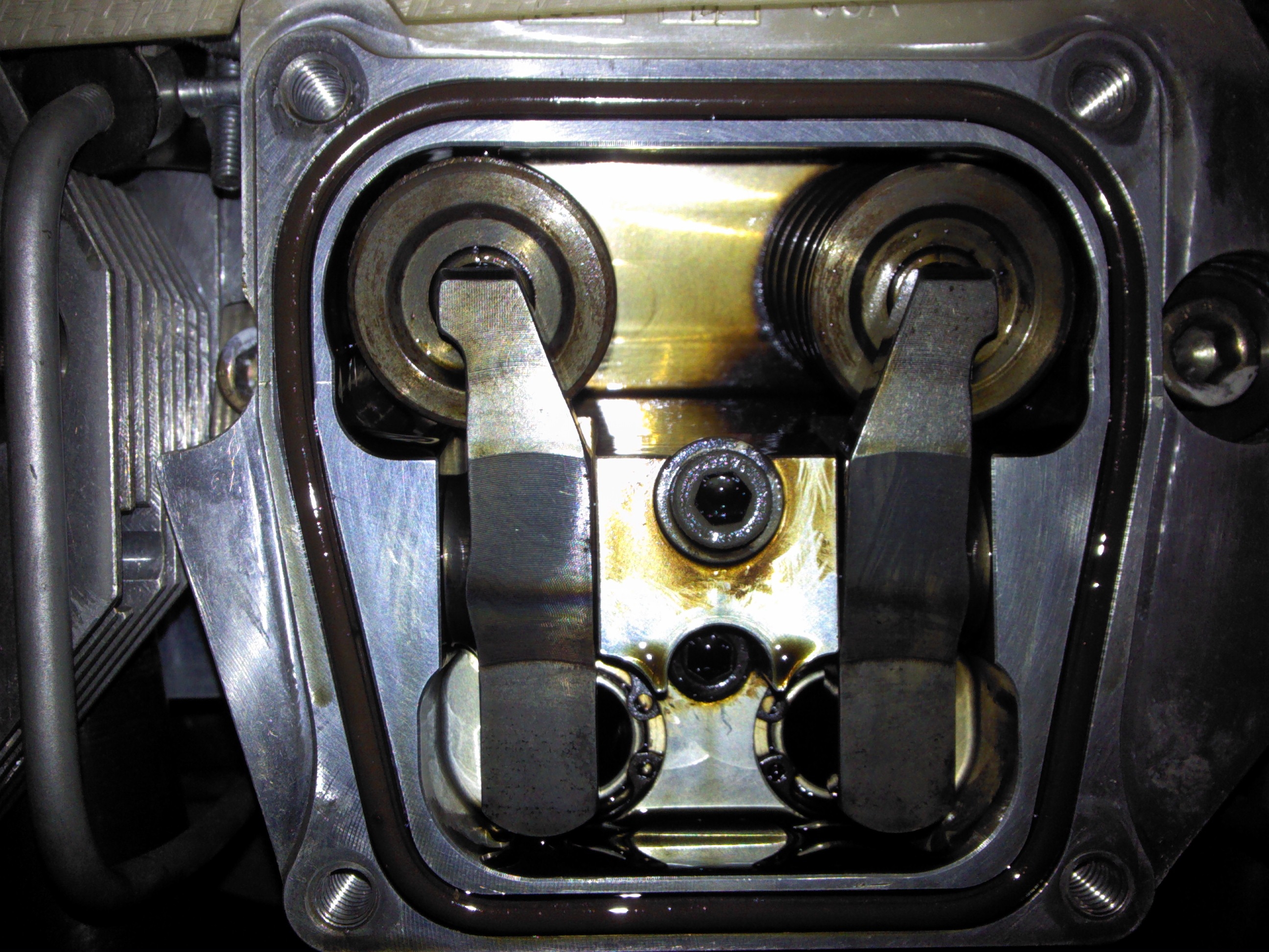

For those interested here is a picture of the rocker box with the cover off.(as if you are doing a head bolt check) If you see the discolored area around the exhaust valve on the right,you might want to look further into the situation.

For the folks following this thread, I would urge some level of caution and a high trust in USA Jabiru.
A couple years back we had a new Jab 3300 that had a real problem with valves sticking. Ultimately the valves bent and several had to be replaced. A casual notion would be that the valve guides were TOOOOO tight!!! However, inspection by Pete K and the folks in Tennesee revealed the presence of a gunky contaminate. It was that material that caused the valves to gunk up and stick. The engine was torn down and checked, then reassembled. Other than a clean up, touch up of the seats and new valves, nothing was done. It is running fine today as far as I know.
The heads in Tex's picture could have a bent exhaust valve (which can come from overheating), from dirt or problems with the seat, from overheating cooking the oil in that spot, or perhaps other causes, not excluding a problem with fuel contamination. We are not told of the number of hours on the engine, the compression numbers obtained on multiple occasions, CHT's and EGT's over time and other considerations. Frankly, if the compression is up, particularly a differential compression check, I would not do anything unless Pete, et al, said it was an indicator.
While Tex wants to make his own valve guides, that would not be the solution I would pursue first. Having just discovered a cracked valve guide in a O-320 Lycoming, I tend to believe that some things just happen. Better to replace with the correct part and simply move on....if the guide is indeed out of spec.

Guys - please take note:
In this age of instant communications it amazes me how information isolated aviation people have become.  I frequent different aviation online groups and all have reported this SAME type of valve problem. It is nothing new.  What does amaze me it how technical engine manufactures can get.  "Pete K and the folks in Tennessee revealed the presence of a gunky contaminate."  That GUNK is known as coke, not the type that you drink but what happens when you expose oil to high heat.  This coke is a carbon base substance.  The coke attaches itself to the valve stem and guide; the coke is harder than the steel of the valve or the valve guide and causes ware.  This coke hardens - And, the valve stem and valve guide ware allowing more oil leaks into the space between the valve and guide.  In engine design the valve is harder than the guide so the guide wares more.  As the coke builds up it causes the valve to stick.  History has shown when this happens the valve sticks OPEN, in the DOWN position.  Since the valve is DOWN it is met by the UP coming piston.  You can just imagine all the fun and sounds that happen in a split second.  What I do not know is:  Dose the Jabiru have an INTERFERENCE fit between the piston and valve?  If not than all that may happen is a loss of power; otherwise it's flying parts and vibration - If you are lucky.  This problem is more prevalent with engines that burn AvGas but it does happen with MoGas also.
How do you prevent it?  The jury is still out on that verdict.  But, there is a test that can be performed that gives one a better than average idea on when it is happening.  Go to the Lycoming web site and down load Service Bulliten SB388C.  It explains the required equipment and how to perform what is know as "The Valve Wobble Test".  Remember: The equipment will have to be modified and the specs (Go-No Go) limits will have to be developed to address the Jabiru Engine.
My thought on prevention is: COOL the valves and guides as much as you can. Prevent the HEAT from burning the oil.  If the oil does not burn coke will not develop.
Side Note:  Engine manufactures - If cooling does work you will have to re-calculate the clearance between the valve stem and guide considering the maleficent of expansion of the materials.  Less heat means less expansion unless you go with a NPO material.

Thank you for your coments , but we already know the whats the problem.

Barry, it wasn't coke. It wasn't carbon based. It was a yellowish material that we believe was present in the mogas with ethanol. It showed up in less than 3 hours of running, hardly enough to cause significant carbon deposits.

This was not coke but some foreign substance from the fuel

The engine the kayberg is talking about was not burned oil or fuel deposit. this "gunk" or "coke" as you call it was not found in the rocker box on this particular engine. It had gummed up the mechanical fuel pump, carb, intake plenum and tubes, and the intake valves only at the portion which is exposed to the incoming mix. This was not a oil burn or lead deposit. It had formed from a fuel contaminate and easily disolved with parts wash and solvent. It was tanish in color and clear like a varnsih.
I would belive everything else but it was not oil or lead, it had contaminated and built up on everything from the fuel tanks in. I know because i rebuilt that engine.

Could the substance be epoxy or a tank sealer? I know many epoxies will dissolve in ethanol laced fuel and some will dissolve in regular fuel. I have seen fuel systems clogged with dissolved epoxy, a brownest color. It is nasty stuff.

On Fri, Mar 16, 2012 at 1:42 PM, <[url=mailto:Kayberg(at)aol.com]Kayberg(at)aol.com (Kayberg(at)aol.com)[/url]> wrote:
While Tex wants to make his own valve guides, that would not be the solution I would pursue first. Having just discovered a cracked valve guide in a O-320 Lycoming, I tend to believe that some things just happen. Better to replace with the correct part and simply move on.....if the guide is indeed out of spec.
Doug Koenigsberg
In a message dated 3/16/2012 6:51:50 A.M. Eastern Daylight Time, [url=mailto:wb2ssj(at)rochester.rr.com]wb2ssj(at)rochester.rr.com (wb2ssj(at)rochester.rr.com)[/url] writes:

Doug:
Is this your post?
"A couple years back we had a new Jab 3300 that had a real problem with valves sticking.  Ultimately the valves bent and several had to be replaced.   A casual notion would be that the valve guides were TOOOOO tight!!!   However, inspection by Pete K and the folks in Tennesee revealed the presence of a gunky contaminate.   It was that material that caused the valves to gunk up and stick. "
It was posted by:  Kayberg(at)aol.com (Kayberg(at)aol.com) via matronics.com
And you can see the term "gunky" was used... Gunky is not a solid or a powder.
That is what I am responding to.
I did not see the first set of pictures.
Isn't this engine out of country?
Yellow - Is a classic case of SULFUR.  So one must ask: Are these fuels controlled enough to keep the sulfur content equal to or lower of what we have here is the USA?
Question:  Are these Sulfur filled valves?
We are only working from pictures so there is a lot the eye can see that the pictures may not show.
Are the valves the ONLY place where the yellow is showing up?
If so the next question would be:  How hot is the engine/valves running?
Hot valves could be causing detonation and it could be only in the vicinity of the valve. You can cross check this with the burn pattern on the top of the pistons.  You want to see a very distinked swearl pattern.
Can you add any additional pertinent information?
Barry
On Fri, Mar 16, 2012 at 5:26 PM, <Kayberg(at)aol.com (Kayberg(at)aol.com)> wrote:
[quote] Barry, it wasn't coke. It wasn't carbon based.  It was a yellowish material that we believe was present in the mogas with ethanol.   It showed up in less than 3 hours of running, hardly enough to cause significant carbon deposits.
Doug
In a message dated 3/16/2012 3:27:41 P.M. Eastern Daylight Time, flyadive(at)gmail.com (flyadive(at)gmail.com) writes:
Barry
On Fri, Mar 16, 2012 at 1:42 PM, <Kayberg(at)aol.com (Kayberg(at)aol.com)> wrote:

relates to valve operation, but that unleaded stuff sure did a number
on it.
Lynn Matteson
Jabiru 2200, #2062
Prince prop 64 x 30, P-tip

PostPosted: Sun Mar 18, 2012 10:04 am    Post subject: valve problem Reply with quote
I am an owner of a 1967 Mustang, 390cid. These engines were designed to run on 100 octane leaded gas. When I rebuilt the engine in 1998, I had the machine shop install hardened valve seats and they also hardened the exhaust ports. Unleaded fuel burns much hotter than leaded fuel and will absolutely eat up the valve seats on an engine designed to run on leaded fuel. The exhaust ports may not have needed to be hardened, but what the heck, I did it anyway. BTW, when I can (and this is usually all the time) I run aviation 100LL in my Mustang.

BobsV35B(at)aol.com
PostPosted: Sun Mar 18, 2012 10:45 am    Post subject: valve problem Reply with quote
Good Afternoon Dennis,
I really do not feel you can make a flat statement that leaded fuel burns cooler than unleaded fuel.
It IS true that some engines will run hotter using unleaded fuel than they will using leaded fuel, but that is because the cylinder pressure is too high. Has nothing to do with lead or no lead.
Fuel formulations are different all over the country. The fuel is a mixture of chemicals that meet industry standards. That is true for aviation fuel as well as non aviation fuel.
If you are running a low compression engine, the lead is just a waste of money and has no effect on how hot the mixture will burn. Using aviation fuel does help if the car is not used often. Aviation fuel has a more stable nature and can be left in the tank for months without gumming up anything.
If you are burning valves when using unleaded fuel, you are probably getting detonation. Possibly even pre-ignition. If that happens, the engine will definitely run hotter!
What substantiation do you have that the leaded fuel burns cooler? I have never heard that nor have I read anything that makes that statement, but am always willing to learn.
There is more energy in each gallon of lower octane fuel. The higher octane fuels weigh just a bit less than the low octane fuels and we therefore can get a bit more energy out of low octane fuel than we can from high octane fuel, but we cannot run at as high a cylinder pressure when running low octane fuel.
We use high compression ratios to get more power out of the same size engine and the high compression can gain some efficiency provided it has a high octane fuel.
There are other formulations that can raise the octane of the fuel, but the components are much more expensive than Tetra Ethyl Lead.
If you can point me toward a reliable source that will tell us that leaded fuel burns cooler than unleaded fuel, I would sure like to find out where I am wrong.
Always learning something new!

In a message dated 3/18/2012 1:04:10 P.M. Central Daylight Time, dwwilt(at)aol.com writes:
Have a wonderful day,

Good Morning Lynn,
Do you recall what the engineers decided was the problem at Chrysler?
When I attended school concerning engine operation, such problems were noted.
Lead does a good low cost job of controlling the rate of combustion. Take away the lead and the combustion characteristics may change in a negative direction. It seems reasonable that changing the combustion characteristics will affect engine operations and the change needs to be considered.
In a very general way, take out the lead and you need to lower the compression ratio.
There are ways of controlling the timing of fuel into the cylinder that can allow higher compression with unleaded fuel, but such things are way above my pay grade!
Once again. I am not an engineer, just an interested student of the results.
I have never found a graduate engineer trained in the field that felt lead was beneficial to the engine, though the lead was the cheapest way to eliminate detonation.
I think we can all agree that detonation is a bad thing!
Taking away the lead will certainly change the combustion characteristics. That we do have to consider when we set up the engine.
Your experience certainly emphasizes the point that small changes often have unforeseen results.

PostPosted: Sun Mar 18, 2012 11:44 am    Post subject: valve problem Reply with quote
Bob,
If you are running an engine designed to run on 100 octane fuel and you can only get less than that, you will burn the valve seats. Any classic car guy will tell you that. Every old classic car engine that gets rebuilt will have hardened seats installed or the machine shop doesn't understand older engines running on unleaded / lower octane fuel. Especially those with higher compression engines. I could probably get buy without using hardened seats in a 200cid 6 cylinder from the 60's. You must know 100 octane anything burns cooler than 91 or less octane fuel. I should have said that since you can't buy 100 octane unleaded fuel (in most places) that auto fuel is lower octane and burns hotter than 100LL.
Ethanol is horrible for older cars and their fuel lines that have not been changed in a while. After about 4 years, all of my fuel lines began to leak because there is something in there that just makes them deteriorate. Another problem with auto fuel is finding non-ethanol gas. Unless you go to a marina, it is very difficult to find just anywhere. You surely can't use ethanol in a fiberglass tank. Talk to the marine folks about that one. I have fiberglass tanks in my Lightning. I choose to use 100LL. Too hard to find unleaded premium without ethanol and who is to say it may have it anyway since ethanol is standard now for car fuel.
