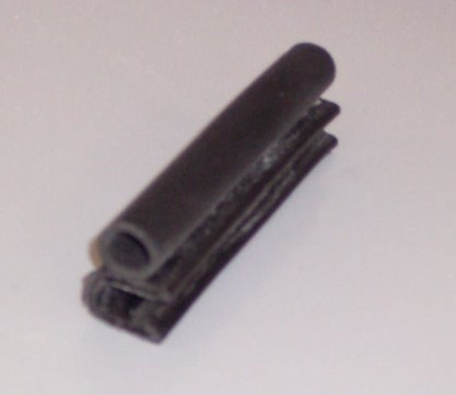

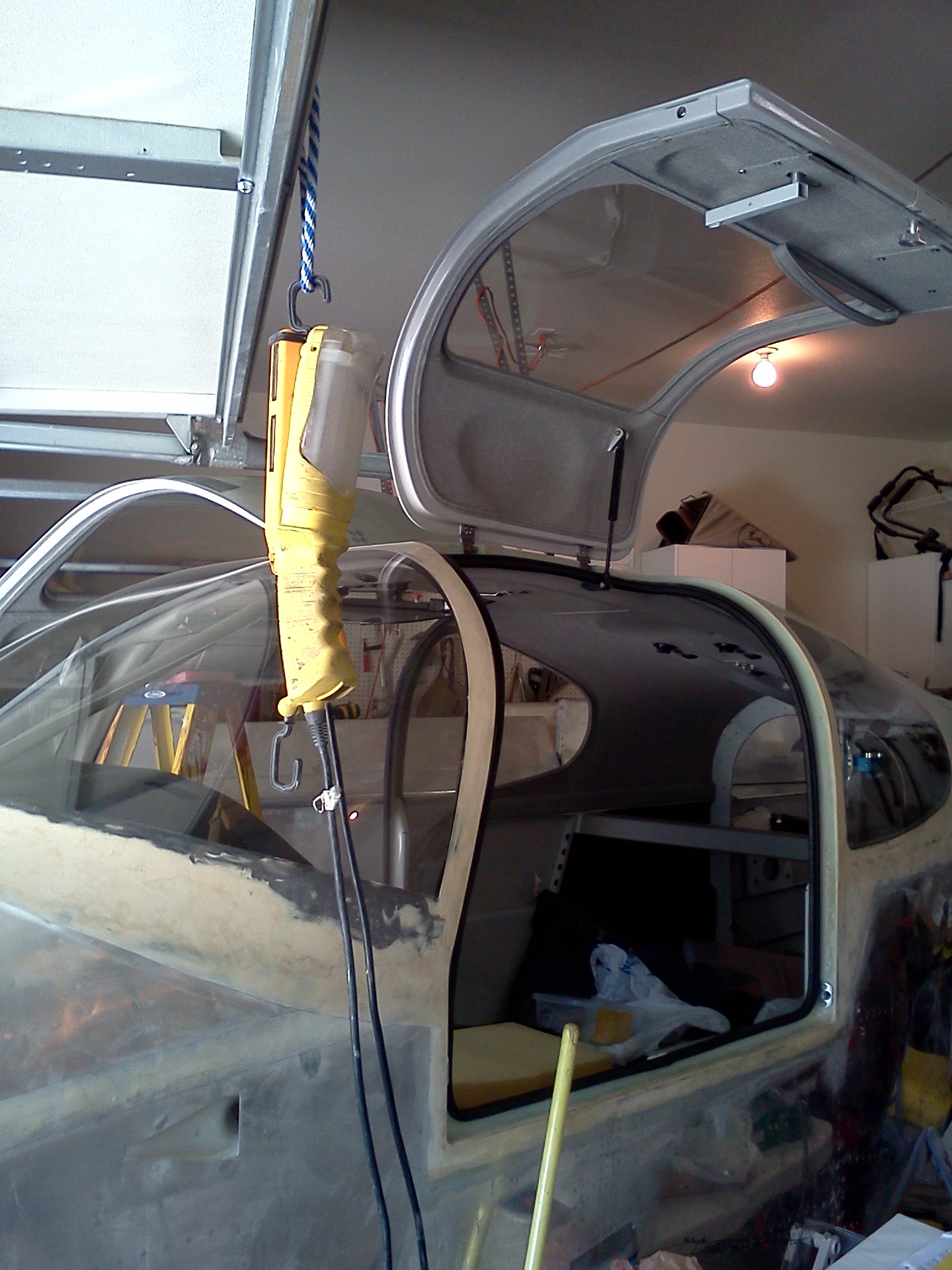

PostPosted: Mon Apr 09, 2012 6:01 pm    Post subject: Re: Door Gutter and McMaster Seals Reply with quote
Sean,
Part of installing the seal is to build up the area on both sides of the old gutter rail. Once you cut it flat it needs to be extended out and thickened both on the inside and the out. Ultimately, the seal will be about 50% compressed when you are complete. Here is how my seal fits.
 Filesize:  2.14 MB
 Viewed:  15956 Time(s)
Bill

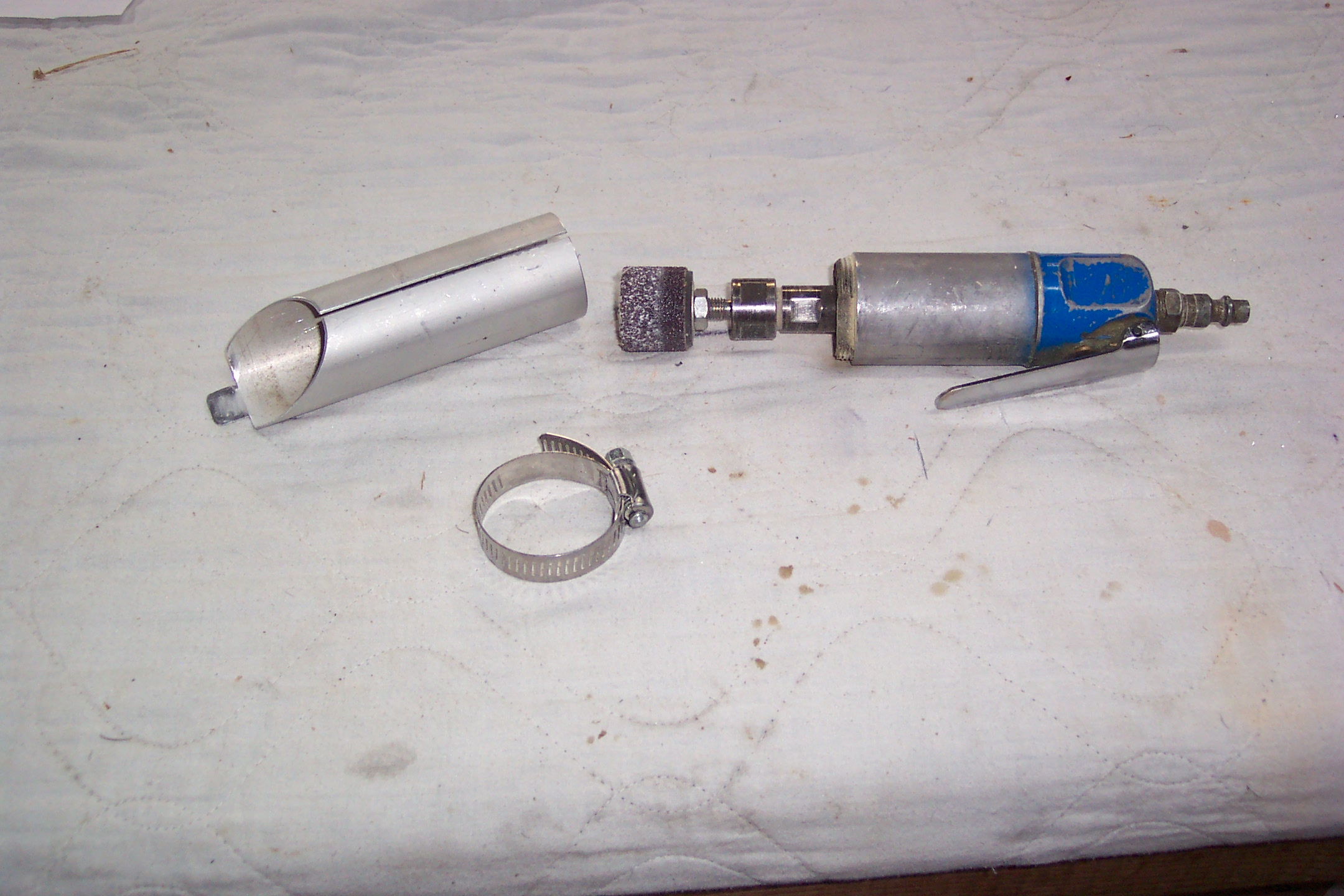

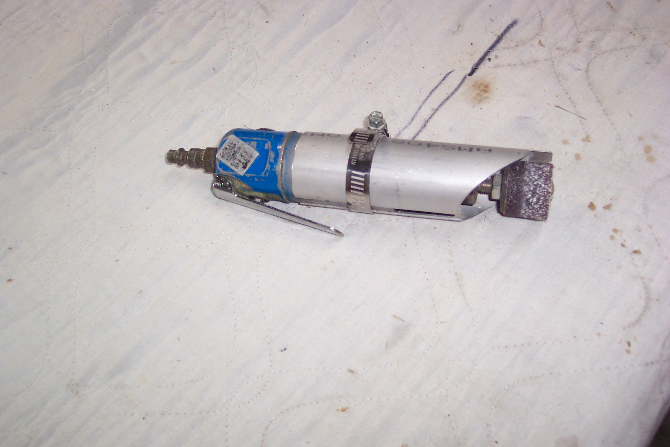

robin(at)PaintTheWeb.com
PostPosted: Mon Apr 09, 2012 11:12 pm    Post subject: Door Gutter and McMaster Seals Reply with quote
We were the first to use the McM seal. We started a grinder and added a spacer for even reveal. Seemed to work out well on the old top.
Robin

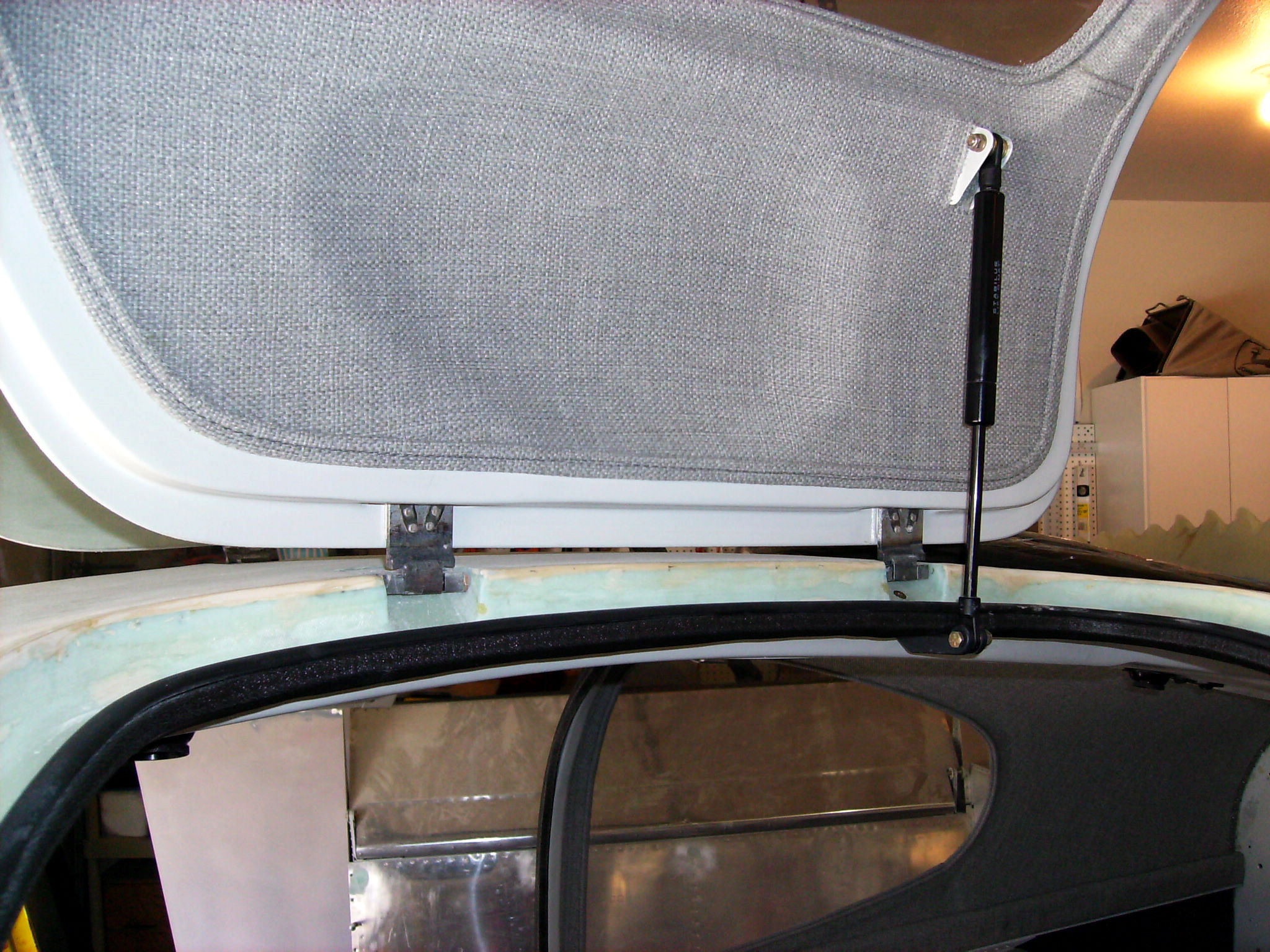

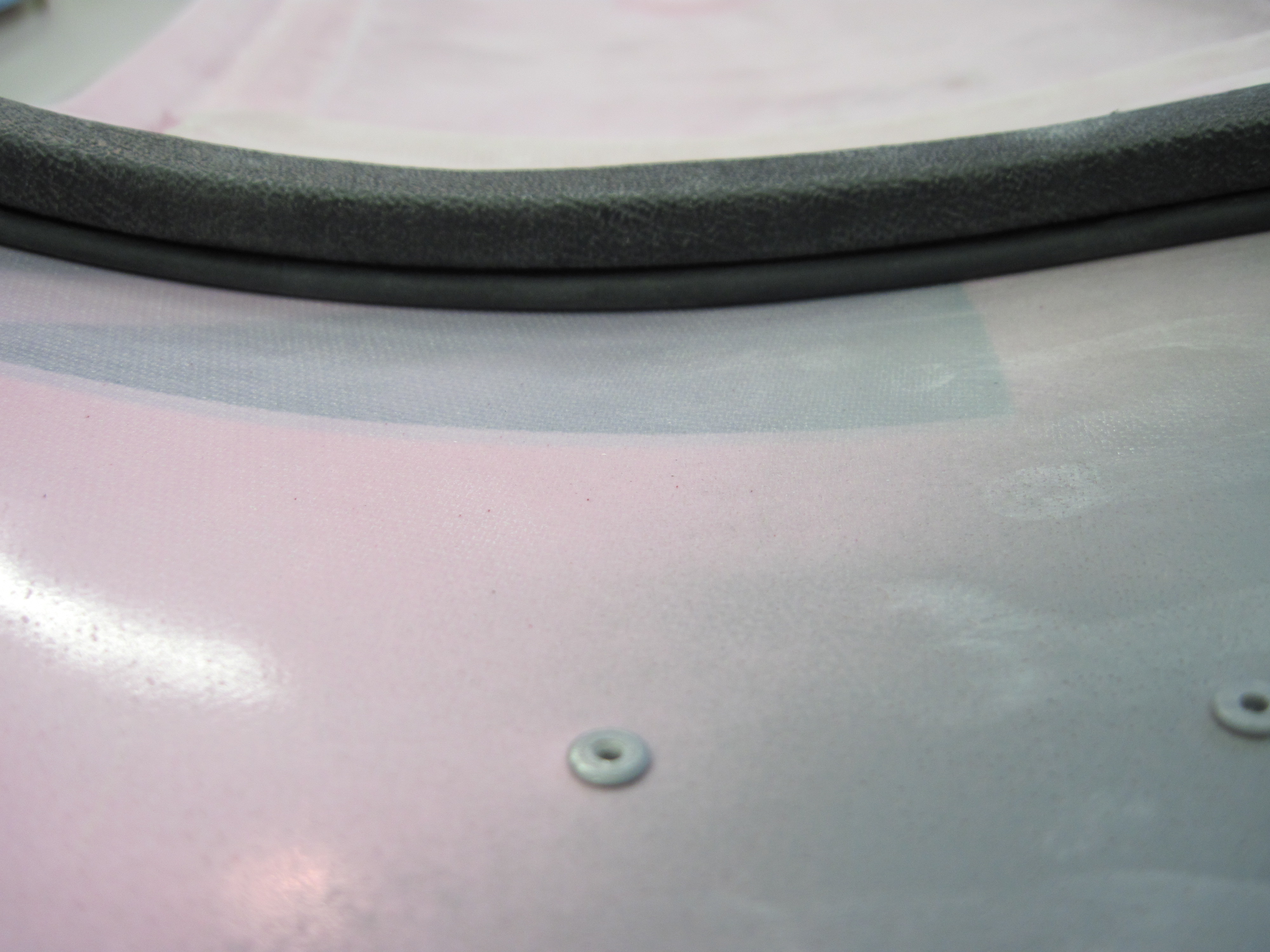

hotwheels
Joined: 01 Jun 2007
Posts: 240

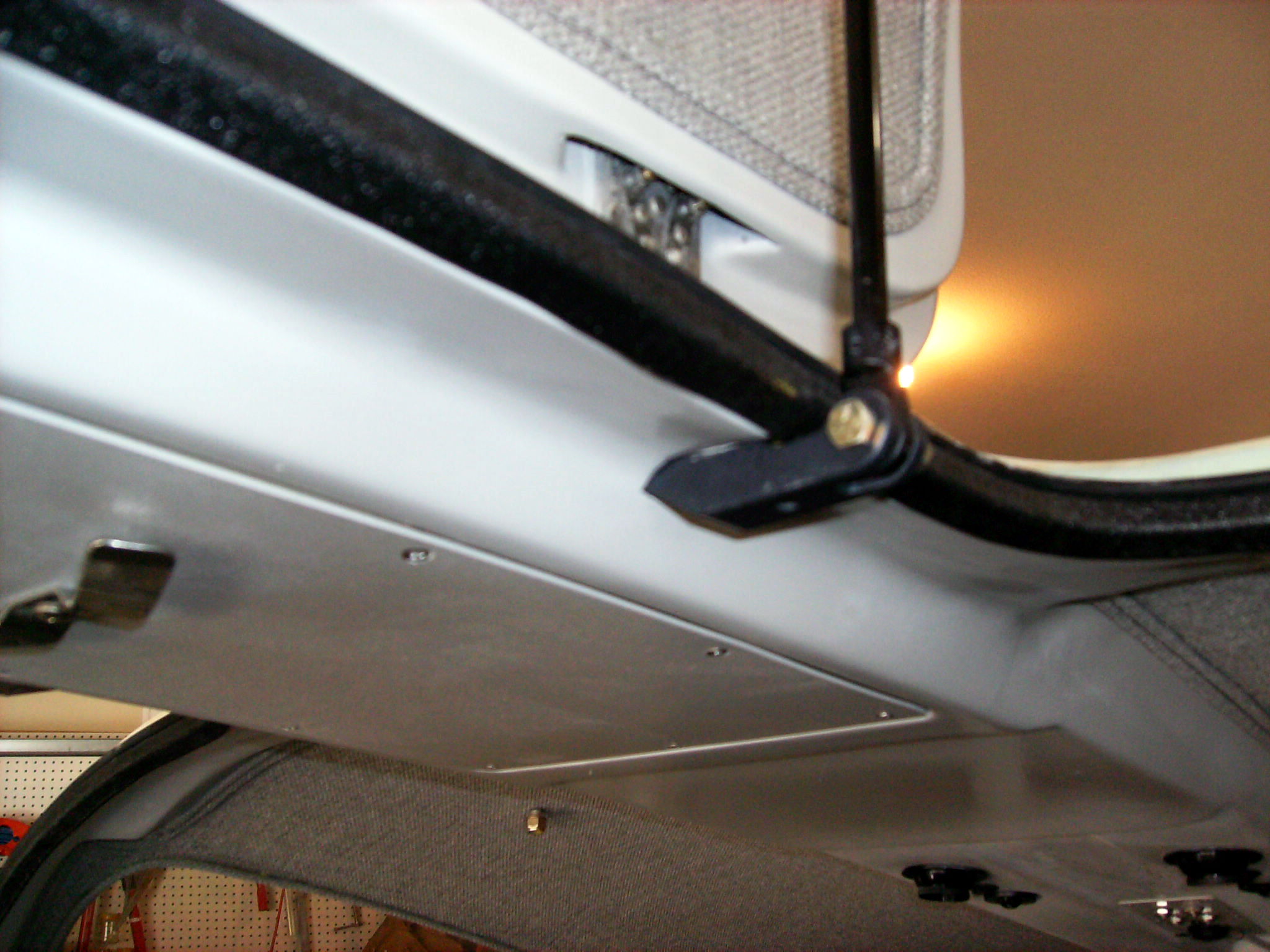

PostPosted: Tue Apr 10, 2012 5:33 am    Post subject: Re: Door Gutter and McMaster Seals Reply with quote
Maybe it's obvious, but maybe not... After cutting the door edges flush and sanding, I used an ~18" section of door seal as a mold. Filling each section with structural epoxy made for a really tight fit and minimal additional prep work to get the seal right. Just add cosmetic filler to blend into the cabin top and door edges. I bought lots more edge than required as it tends to get tired and look wavy after fitting lots of times (you can see some of that in the photos). Save the good stuff for the end.
Jay
