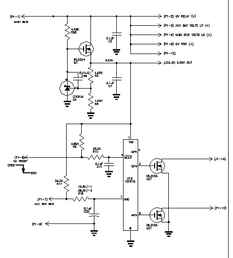

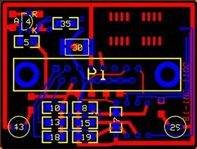

Okay, just for grins let's see how a pair of SO-8
chips goes into the space previously occupied by
three DIP4 chips and some do-lots components.
[img]cid:.0[/img]
Well, lookee there. Not only is there plenty
of room, we might even put one on top and the
other on the bottom so as to leave room for leaving
more copper on the board around the chip.
This exercise in cut and try on a four-cornered
envelope with the final confirmation or denial
of choice being a full power test in the temperature
chamber. I have one of those.
http://tinyurl.com/7yrrhhq
So fortunately, we have access to quite a bit
of experience to drive the corners of the envelope
toward the component of choice.
I'm pretty sure we can get a 5A switcher in
this enclosure with comfortable head room
for power handling. So now your schematic
looks something like this:
[img]cid:.1[/img]
When we went from do-lots to wig-wag, it got a lot
simpler. Two outputs driving power FETs, two inputs
to control for three states of function (OFF/WW/ON).
So, first cut at the design looks good. If you can make
the silicon sing, dance and do dishes, I'd say we're
50% of the way to having a useful product that meets
design goals and offers a user friendly envelope
and wiring interface.

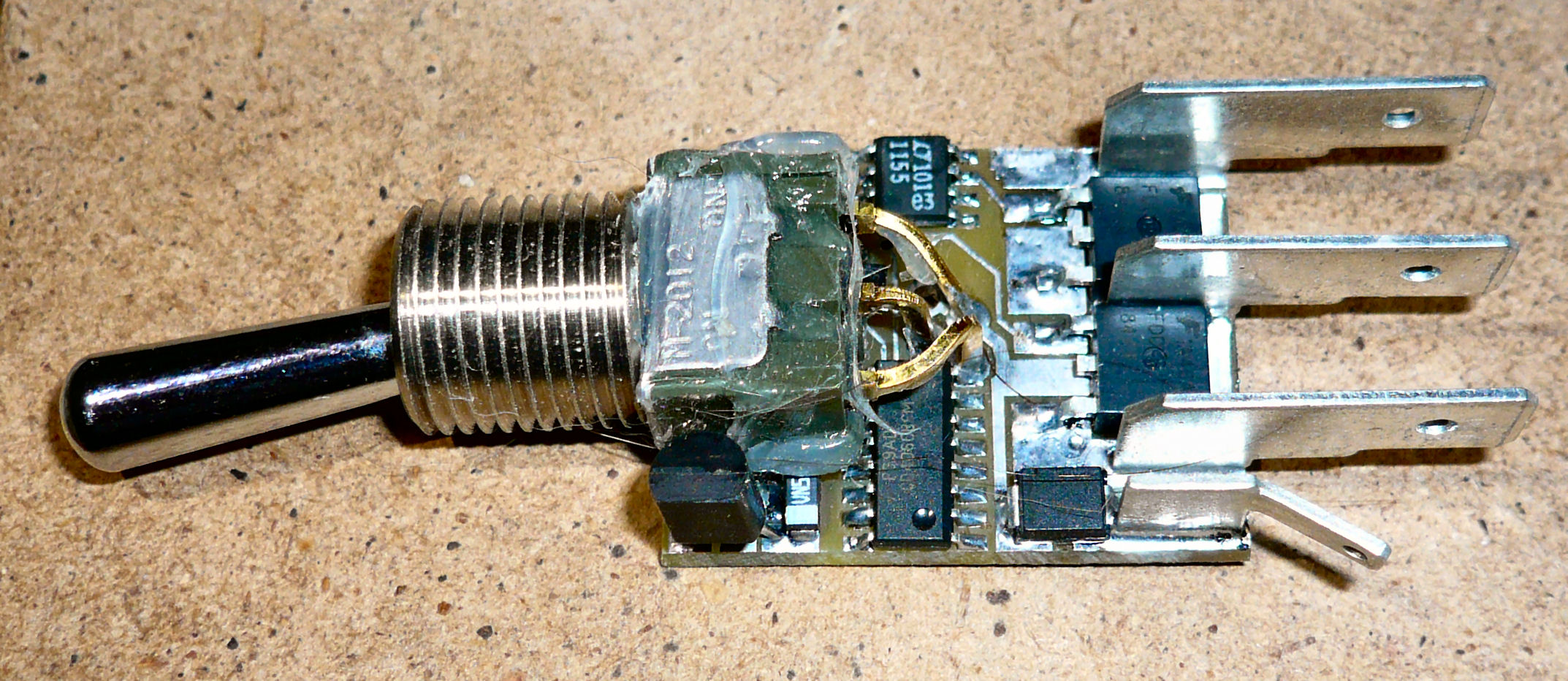

>One question I forgot to ask in the previous note. When I looked at
>using the Perihelion Wig-Wag for my LED landing lights I was
>surprised at the compact size and the capability to switch the loads
>on standard landing lights. Is there something unique about this
>design to handle the 250 watt load?
You'd have to check with Eric as to his
design philosophy but based on what is
generally known, getting the heat in the
FETs under control has two components….
Bob is right. The Perihelion Design Wig-wags use either an FDD6670S (30V) or an FDD8444 (40V). Both of these are “D” packages (TO-252) which are surface mountable and about 1/4” square. The mounting is done by soldering the package to the PCB which itself is designed for maximum dissipation. The Faston lugs themselves are included in the thermal calculations, as is the potting compound.
For this design I chose “high-side” switching, since the loads are remote and might be remotely grounded. The difference is that “low-side” switching would normally require an additional wire to the load. The wig-wag itself weighs less than the additional wire would. The disadvantage is that more a complicated driver for the FET gate is required.
Mosfets are wonderful parts for wig-wagging, where there is no need for an intermediate state, they just switch ON and OFF. But they have to be operated within their specified range. This was a problem when people applied these wigwags to HIDs. Most HIDs have an extremely high ignition voltage, then a high boost voltage to induce IR heating to the anode terminal of the lamp. The boost current is over 30A for a substantial fraction of a second. This would wipe out the FET. The solution was to supply a CL-11 surge protector and a Zener across the line for those who intended to wigwag the HIDs. Now they wigwag well.
But for incandescents (or LEDs), and using a surge protector, the wigwag will supply 20A per pulse. This is possible because the gate driver fully saturates the gate allowing the lowest possible Rds(on) resistance, and thus the smallest I x I x Rds(on) heating. For 20A, the heat dissipation is about 3.2W, split among two devices!
Early versions used a 555 timer and a mosfet driver. Later versions have used a small RC oscillator and a CD4060 CMOS 14 Stage Ripple-Carry Binary Counter/Divider. This would seem an unusual part for this application, but it simply divides the RC oscillation and goes tick-tock at the correct duty cycle and timing—it does all the work. The 555 was hard to make it do 50% (but it could be done with a few more parts) and the first pulse was always 1.5X longer than any succeeding pulse…which is inelegant and stressed the fets. I was never satisfied with the early design on this matter.
All parts are surface mount and are assembled under a stereo microscope. The entire PCB is 1.16” x 0.90”. Early on I got a note from a customer saying, “Okay, I see the switch, but where is the wigwag circuitry?” There are several styles of this wigwag, one with the switch WW(d) and one BYO-Switch WW(c) that allows all sort of switching configurations. I also make these in 12 and 28V and a special double rate for single head-lights (e.g. the Europa or Glastar). And I supply the add-on bits for HIDs.
But Bob's approach for flashing LEDs is good.
 Filesize:  525.16 KB
 Viewed:  18310 Time(s)

http://www.microchip.com/.
Okay. I I'll get the FAT fets laid onto the artwork, modify
the do-lots schematic to agree, and get some boards
ordered.

Bob,
Could you post a higher resolution version of the schematic that
you provided in a previous post. It is hard for me to make out
the details.
