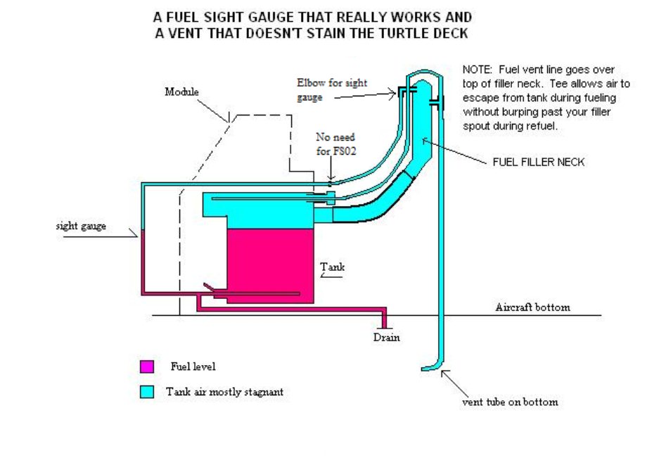

<?xml:namespace prefix="v" /><?xml:namespace prefix="o" /><![endif]--> [img]cid:01e201cd2022$79344ce0(at)adminPC[/img][img]cid:01e301cd2022$7936e4f0(at)adminPC[/img] Photo E-mail [url=https://skydrive.live.com/redir.aspx?cid=2161856909618aa7&page=play&resid=2161856909618AA7!238&type=5&authkey=!AP_XK1w434iOGtM]View slideshow [/url]| [url=https://skydrive.live.com/redir.aspx?cid=2161856909618aa7&page=downloadphotos&resid=2161856909618AA7!238&type=5&authkey=!AP_XK1w434iOGtM]Download images [/url] Max,
Please refer to my website for some details on the vent tube out the bottom and a sight gauge that works. The details on the website are general in nature. I have done many of these using the concept of the drawing below. It works, allows overfill fuel to drain out of the cobra, keeps fuel off the top of the aircraft and provides a very accurate fuel gauge. So much so I don’t need any other form of gauge or sender.
[url=https://skydrive.live.com/redir.aspx?cid=2161856909618aa7&page=play&resid=2161856909618AA7!239&parid=2161856909618AA7!238&type=1&authkey=!AP_XK1w434iOGtM][img]cid:01e401cd2022$79373310(at)adminPC[/img][/url]
I keep a short piece of 1/4 inch hose to allow me to assure accuracy in case fuel gets in my sight gauge vent line. If I overfill my plane and believe my sight gauge vent side is full of fuel, I simply put the 1/4 inch line on the inside the cobra tee for the sight gauge vent and blow into it until I hear bubbles in the tank. Sight gauge is accurate as it can be. Just make sure your sight gauge elbow or tee is the highest point in the cobra neck and your drain is lower.
Just an idea...
Bud Yerly
