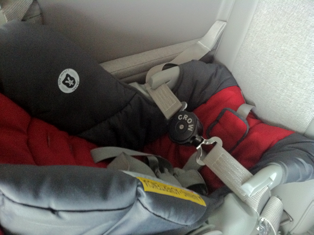

Just a few weeks away from our first kid, and I'm already thinking about flying him around.  I test fit our infant (rear-facing) carseat today, and am not happy with how the lap belt of my 4-point system secures the seat (see picture).  I'd rather not have the buckle in the middle.  Ideally I'd use the seat base, but my seatbelt doesn't get short enough to make the base work.  What have others done?
Thanks in advance for the help...
-Rob

For starters, I wasn't allowed to take them flying until age 1. Not my
decision, but that's about when we could trust them to keep the
headset on, so it worked out. By then we had graduated to the forward
facing seat. Still challenging to install with the standard Van's 4
point seatbelts, but not too bad. My 4 year old now uses just a
booster seat which is infinitely less effort. In the past it has been
a lot of work transfering the seats from the car to the plane to the
pilot car at our destination back to the plane... Looking forward to
leaving that behind.

When is the baby due? My wife should be having a little girl around June 19th. Not exactly our first, but precious just the same.
We have only had a baby in the plane once. We strapped in the infant carrier without the base. We have the standard Vans 4-point harnesses and it was adequate.

Thanks, guys... I may try getting the Van's harness to see whether it works better.  How short can you make one side of the lap belt?  Would prefer the buckle to be on the side, rather in the middle.
Baby is due June 12.  We're really excited.  When we do start flying, the plan is to have my wife in the other back seat with him.
-Rob
