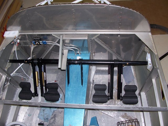

PostPosted: Thu May 31, 2012 7:32 pm    Post subject: Van's Rudder - Brake Pedals Reply with quote
I installed the attached pictured rudder pedals by Paul Grimstad of Control approach:
They are powder coated with non-skid surface on pedals.

Kelly McMullen
KCHD

I had a similar (shoe size 10and1/2 wide) problem with my RV6A and
also used the one side of weldment for rudder control. I am now flying
an RV12 and the rudder/brake pedal design on this airplane has none of
the problem mentioned. You might want to look at the 12 setup, and
consider adapting it to your RV. Suggest you discuss with Van's, of
course..

PostPosted: Fri Jun 01, 2012 10:17 am    Post subject: Van's Rudder - Brake Pedals Reply with quote
Kelly,
I Googled Paul Grimstad and Control Approach but had no luck finding any listing. Would you happen to know what the website URL is so I can see about getting a set of those pedals for my -9A project?
Jack Hilditch

PostPosted: Fri Jun 01, 2012 11:52 am    Post subject: Van's Rudder - Brake Pedals Reply with quote
I know Paul. Do you want me to forward this email to him?

paul(at)controlapproach.com
is the last email address I had for him. I don't think he has a website,
but maybe. I don't know if he produced any for RV's other than the 10,
although likely not much different than overall length of the bar.
Control approach:

I just spoke to Paul. He does not quite yet have a web site, although one
is in the works. The email address Kelly supplied is correct, so you could
reach him that way. Paul's cell phone number is: (503) 849-2123. He has
one pedal assembly ready to sell/ship, and is about ready to start the
production of 12 more. Make sure you talk to him about your application,
since these were originally designed for the RV-10.
