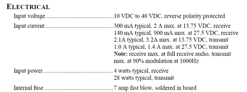

If it was me, I would change to the next larger fuse size (7.5amp). Transmitting is not a sustained electrical condition. The fuse is to protect the wire between the fuse and the radio. You may consider metering the actual draw when transmitting for interest sake. You may find that the draw is right close to 5 amps, causing the "nuisance" trips.
If the radio requires a certain amount of electrical power, and the voltage supplied by the ebus is slightly lower due to the diode, then the current draw has to rise slightly to compensate. Perhaps this is causing a slightly higher draw (amps) when operating on the ebus as compared to the main bus..

That is good logic in reference to the supplied voltage being a bit lower on the E-bus and kicking up the current. My D-100 is hooked up to the Main bus and my EIS (engine monitor) is on the the E bus. There is consistently about 1.5V lower being showed on the E-bus. I won't rule out the thought of the 7.5A fuse at a later date. I think I will see what happens changing over to the main bus.
Thank you for your input.

Probably way off base and a shot in the dark, but I discovered that it is easy to blow the radio fuse if the APRS transmitter broadcasts its periodic packet at the same time I press the transmit button. Separating the antennas solved the problem.

The 'low voltage=high current' thing works for AC induction motors, but I wouldn't bet too heavily on it being the problem in a DC circuit. If you look at the volts/ohms/amps formulas, you can see why.
One thing that *can* happen is the fuse will get hot if there's a poor connection anywhere in the neighborhood: wire to terminal, terminal to fuse, and back again on the other side of the fuse. Think resistance heater. If it gets hot, it's weaker & vibration will increase the odds of mechanical failure of the fuse link itself. Is it a glass fuse, or one of the newer automotive blade type fuses? (Blade fuses should be somewhat less susceptible to the high resistance issue.)
Can you monitor voltage at the power terminal of the radio, & watch the voltage when you key the mic & actually transmit? If it drops noticeably, you've got high resistance somewhere in the circuit, & the fuse would be my 1st stop, especially if it's the old glass variety.

Not off base at all...quite possibly a home run. I just installed an APRS unit and had it running. My antennas should not be an issue as they are quite a ways apart, however I can keep that in mind while at the field and turn it off until I get under way. Nice pitch, thanks!

You missed Charlie’s point, the voltage at the buss doesn’t tell the story of a high resistance connection at the fuse or in the radio wiring. You must monitor the voltage at the input terminal to the radio as Charlie indicated. This should remain somewhat steady before and during transmit if all is well with the circuit and it should closely approximate the buss voltage.

From the SL40 Installation Manual:
[img]cid:.0[/img]
The 3.2A max at 13.75 could be 3.6A at 12 volts. The radio
has a 7A fast blow fuse installed inside. So where is
the 7.5A fuse? If it's on your battery bus to protect the
alternate feed path, then this fuse would could be loaded
to 3.6 amps PLUS what ever else is on the E-bus . . .
need to know what all the numbers are.
