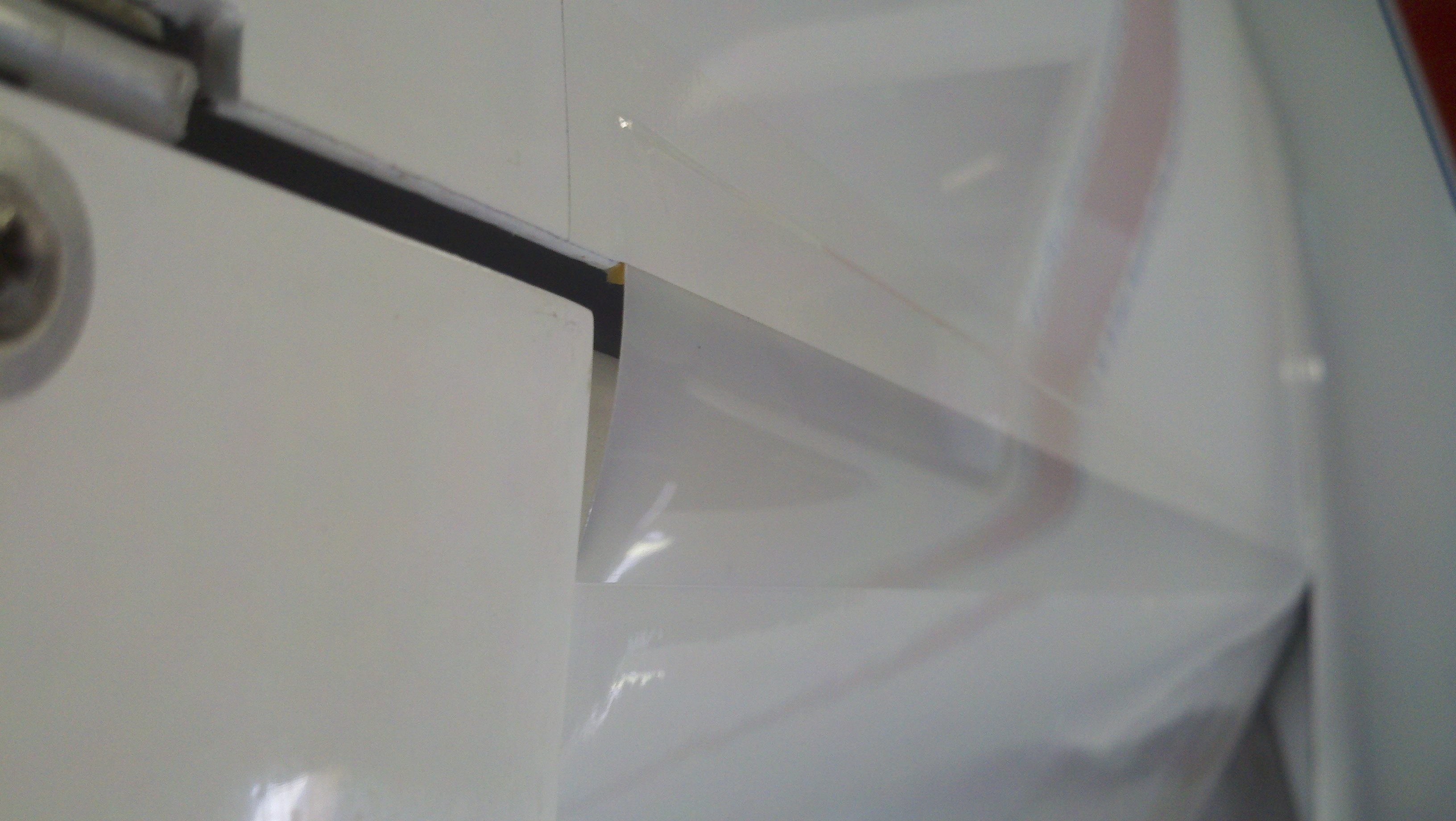

sstearns2(at)yahoo.com
PostPosted: Thu May 31, 2012 8:05 am    Post subject: gap seals Reply with quote
Hi Tim,
I just put tape between the hinges on the side with the hinges. I also had to trim about a 1/4 inch off the flap gap seal since the whistled with the flaps down.  I attached with gap seals with double sided tape and single sided tape running from the skin up over the gap seal as for anti peel. I just followed what the website said to do. I used the double and single sided tape from the website. Not the cheapest, but it is high quality tape. I attached a picture of the flap gap seal before I trimed them.
Scott

PostPosted: Thu May 31, 2012 10:07 am    Post subject: gap seals Reply with quote
Hi Scott,
I remember Vance Jaqua used to say the KIS had a distinctive whistle when it was in the landing configuration. He said you could always tell when a KIS was coming in for a landing. Your comment just reminded me of that.
Larry
