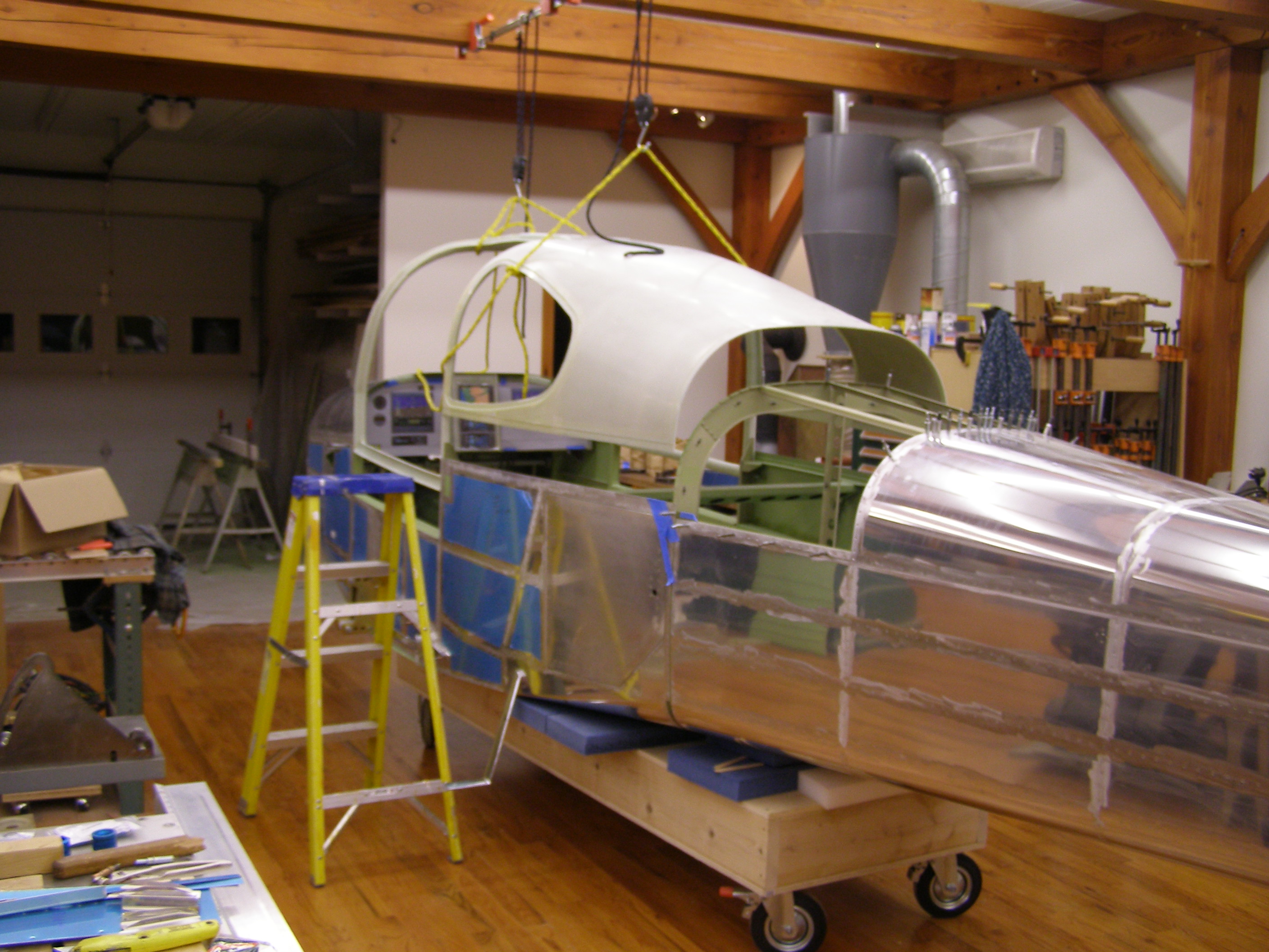

Carlos, I made a roll around platform from 2 sheets of (4 x 8 ) plywood screwed to a 2” x 6” framework, attached swivel casters to the platform. In the attached photo you’ll see the fuse sitting on the dolly.

just for clarity, 1 sheet of plywood, ripped in half, so final dolly size was 2’ x 8’.

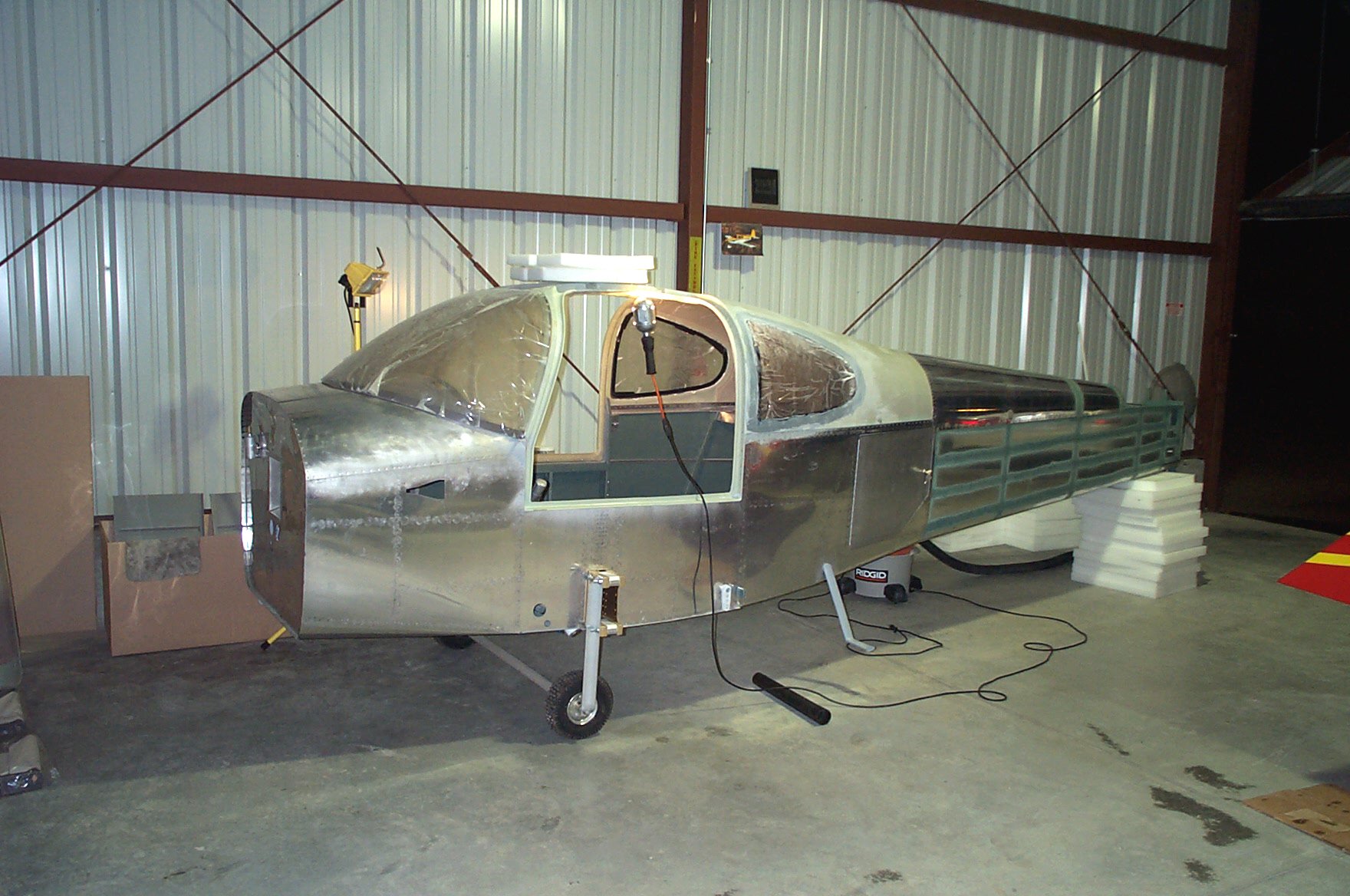

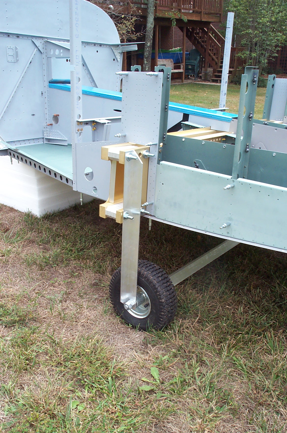

With regards to making a dolly to move the fuselage around.  I adapted some tires during construction to allow me to roll the fuselage around.
Pictures are attached.
Fuselage remained low to make it easy to work on and It was easily moved around.
