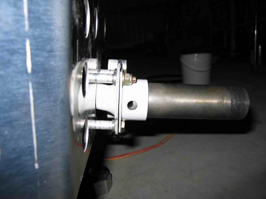

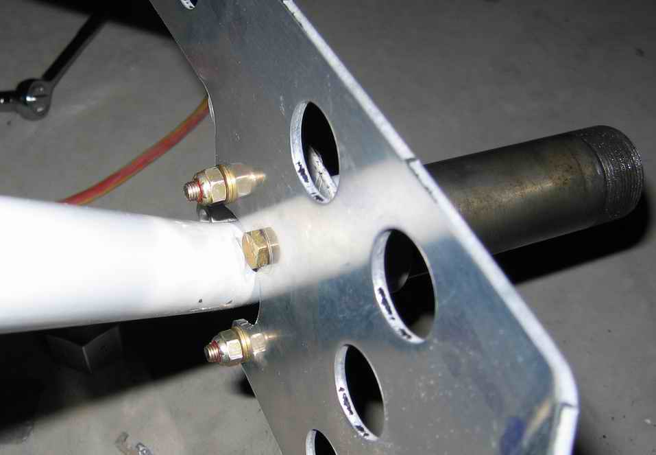

Has anyone else run into problems with their Brake Mount Assembly? This has been stumping me ( and others) for almost a week
I am referring to page 46-4, steps 5,6 and 7.
I fabricated the spacers to 21/32" width, as in the plans (see pic). However, when the brake mount assembly is mounted onto the gear leg, the head of the uppermost forward AN4 bolt (the one which is installed in a different direction to the others) impinges onto the gear leg, and prevents the U-1003 from lining up with the 3/8" hole in the gear leg (see pics). The hole seems to be off by approx 1/8". Both sides have the same problem
So I removed the offending bolt, and installed the wheel/tyre/brake disc assembly. There is approx 1/4" clearance between the brake disc and the U-1010-L/R bracket. This is barely enough, when the bracket is flexed from side to side.
I see the following options:
1) shorten spacers by 1/8" - but then risk the U-1010 bracket intermittently rubbing on the brake disc
2) Shave off some of the bolt head
3) Use a countersunk AN4 screw instead of a bolt.
4) dispense with wheel fairings altogether (and lose 5kts in cruise!)
I'd be grateful for the group's opinions and suggestions

One of the pictures shows the bolt hole that goes through the gear leg - that bolt being in there would change the total spacing - I don't know if it would fix your error though.
I know that when I was doing my 6A I had a similar issue - after I put it all together it fit better and the spacers ended up being almost perfect.......
Something to check.....

We had this same problem on the left side, but not on the right. I used option #2.

That's my problem - the AN4 bolt in question prevents the bolt holes lining up, and prevents the AN6-23A bolt from going through the gear leg.

Indran, I’d talk to Vans. They may have a dimension from the outside of the leg to the brake mount hole. This may be incorrectly drilled. Or the radius of the leg bend may be to far outboard, crowding the alignment hole. Just some thoughts.

I had the same problem on the right side, not the left.... I'd shave down the bolt. FWIW, on my RV-4 you had to shave down the entire side of a couple of the landing gear bolts to get them to fit. No worries, keep building!
