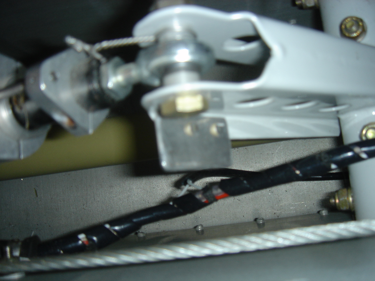

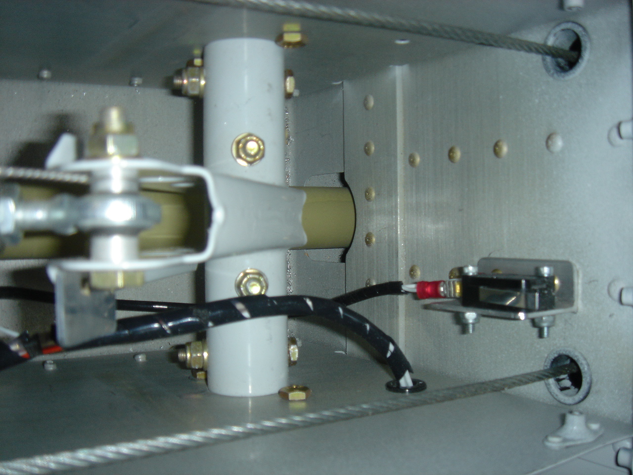

This is what I did. I riveted a tab on the flap mechanism and mounted the switch on the bulkhead behind the flap weldments (see photos).
