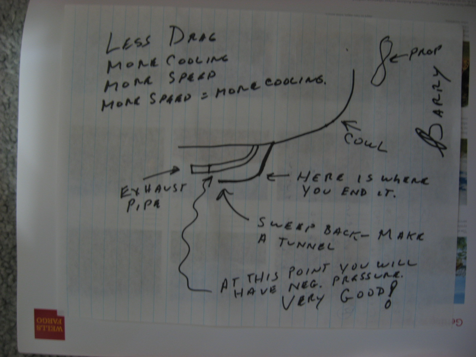

Jeff:
The hard and fast rule for forced air cooling is the EXHAUST area must be at least TWICE the size INTAKE area.
Another simple little trick in cooling is to create a negative pressure area directly at the ramp exhaust port(s).  This can be done with a simple piece of aluminum strip 1 1/2 to 2" wide and long enough to span the ramp area and bent lengthwise down the center-line at a 45 deg angle sort of like this
 --->  ___/  [But flip it so it angles DOWN]  Then rivet it to the edge of the air exhaust ramp.  Works great and you will NEVER notice any drag... Just lower temps.
Barry

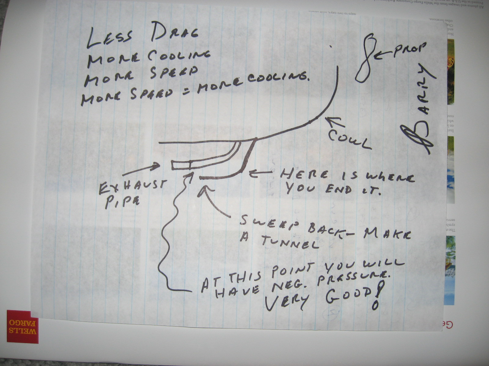

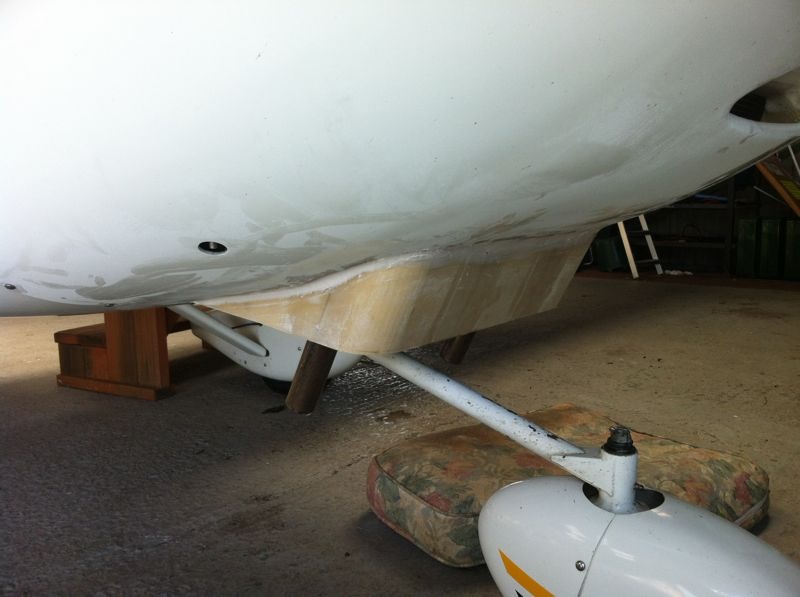

Here are some pictures:

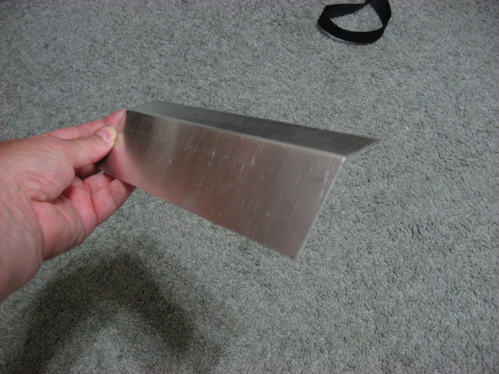

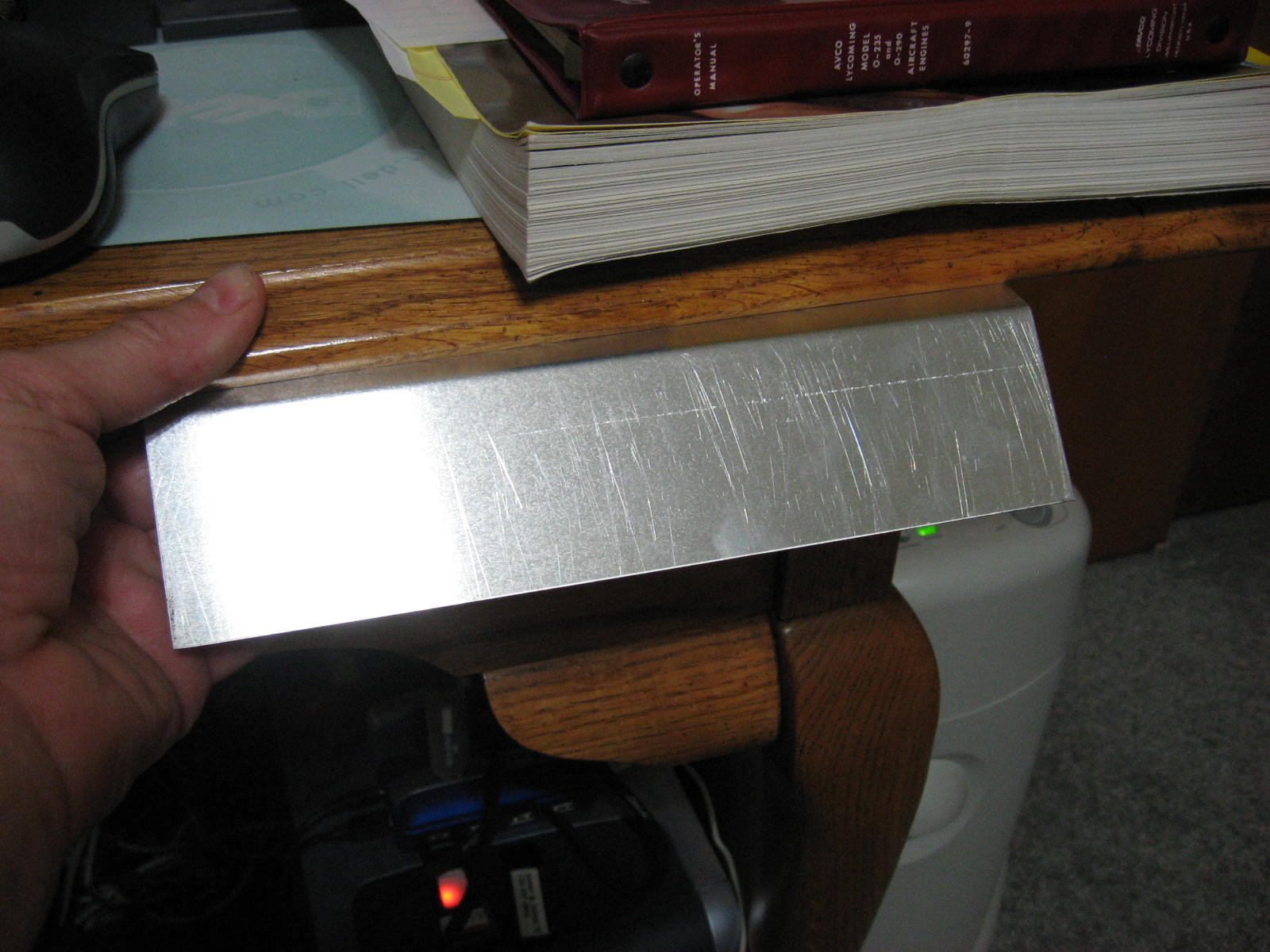

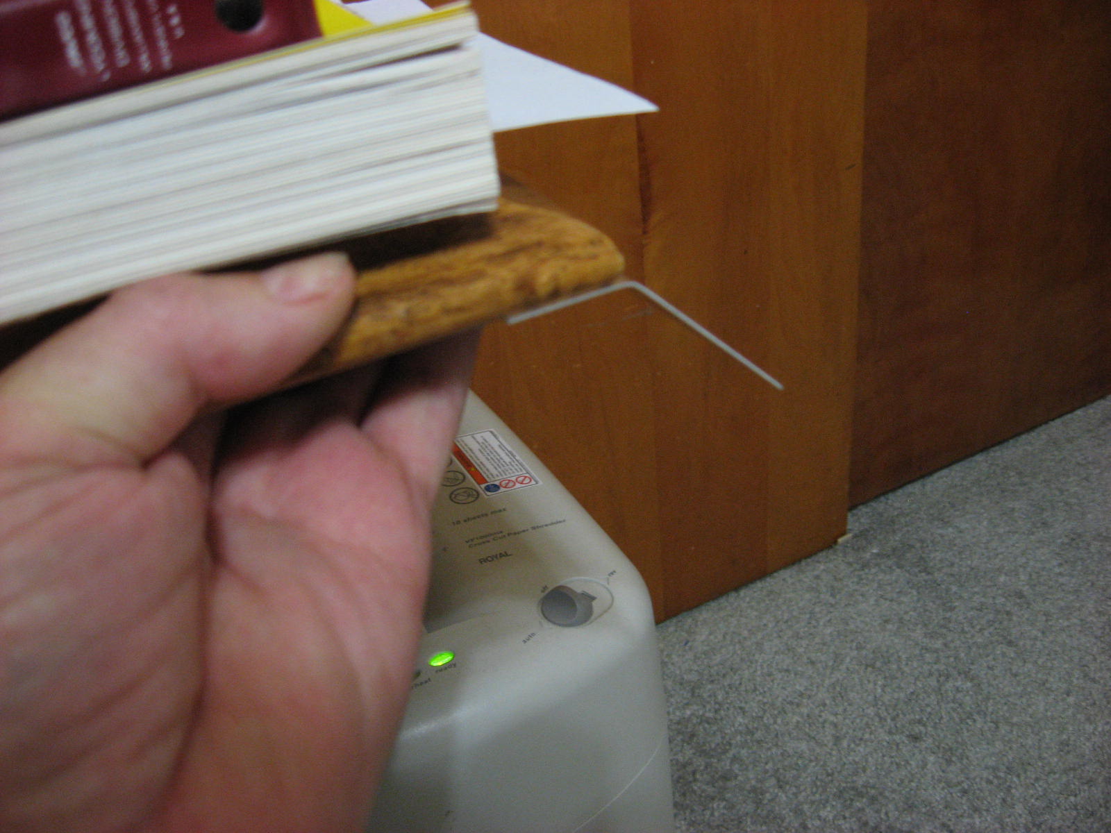

1 - Pictures 1 & 2 show a side view of what it looks like.  This flap is for a large plane with a hidden exhaust ramp for the out going air so I had it made 1" mounting lip and 2" of hang-down.
2 - Picture 3 is a isometric view.  The length should be so it spans from one end of an opening to the other.  DO NOT MAKE IT SHORTER THAN THE SPAN.

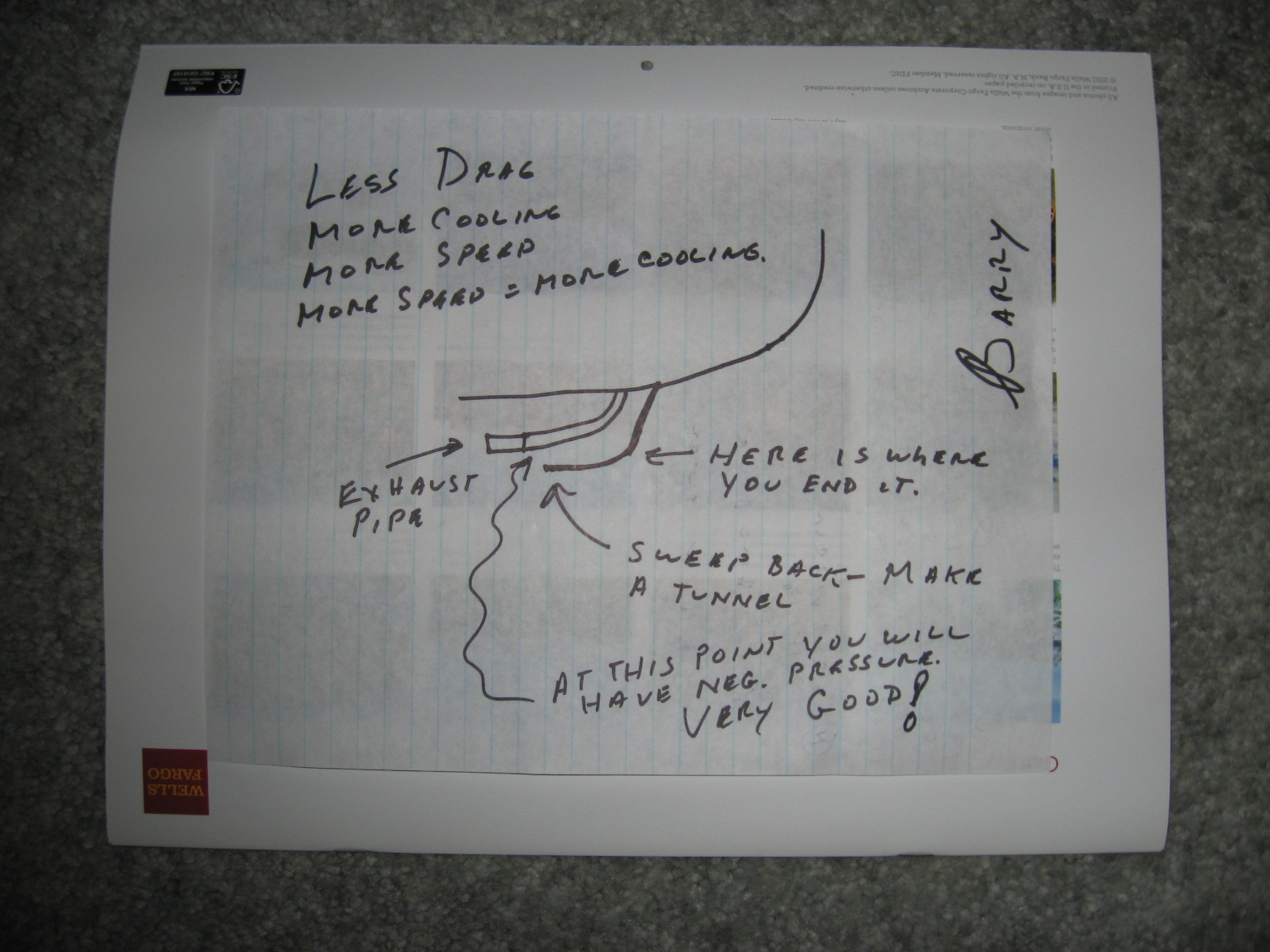

3 - Picture 4 shows it mounted UNDER the lip of a desk... NO!  The desk does not have a over heating problem EXCEPT around April 15th.  I mount it with the mounting edge INSIDE the exit ramp.  LQQKs better.

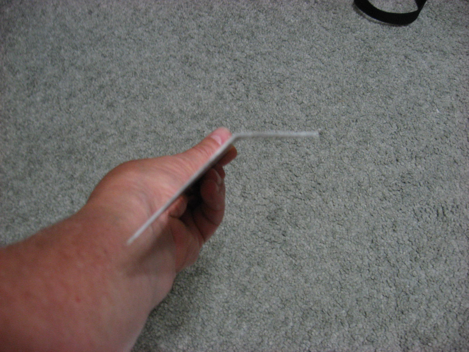

4 - Picture 5 shows a side view of how it should look when mounted.
Hope this helps.  It works GREAT on the applications I have worked on.
REMEMBER - Without a good exhaust of air flow there cannot be a good input of air flow.  Exit must be at least TWICE the area of Intake.
AND! ! !  You must - Have a GREAT seal around the engine with the baffling.
Every little hole you plug helps improve the cooling.

PS
Start with a 45 Deg angle and reduce it from there <-- Reduce it only if needed and if you wish.  I have never reduced it on any of the installs I have done.  DO not go beyond 45 Deg - Not needed - Not any better and at that point it becomes drag.
Same rules apply as for aileron trim tabs.

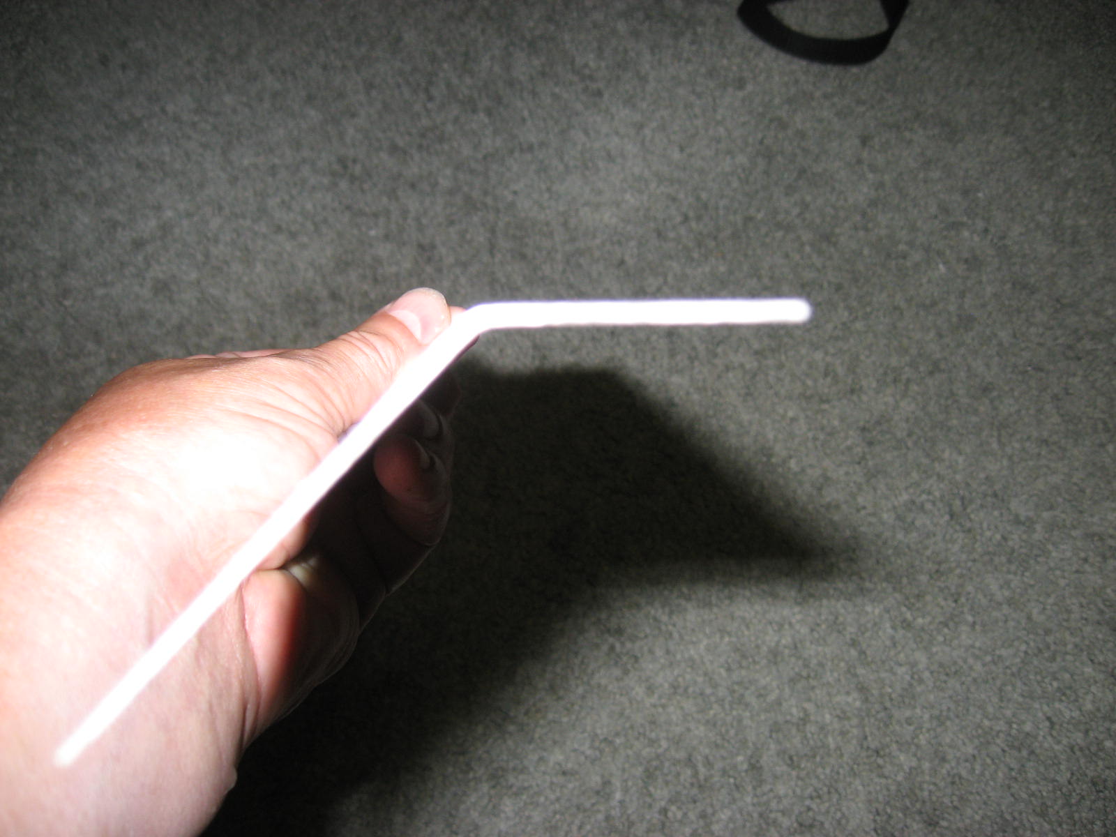

Yes, I received the pictures fine. I'm just trying to puzzle out exactly where the thing mounts ….
Attached is a picture of my new "lip"
-Carl.

Carl:
Did you receive the email and pictures? Wes, tells me that the pictures did not get posted.
Barry

Barry… I'm interested in your concept here, but I can't understand it. Any chance of a photo?
I'm currently working on cooling my Jabiru 3300 in the Europa.
I've put a 5" lip on the bottom of the cowl exit and this has made a big difference to temperatures in the climb, but it has highlighted uneven cylinder cooling - so my next project is to put some dams to force air between the middle cylinder, and also to route HT leads straight out away from air-flow rather than the bundle of cables blocking it all up.
-Carl.

WOW Carl...
That this is almost pointing straight down.  Isn't there ANY way you could sweep it back?  As I mentioned you do not want to have an angle there more than 45 Deg.  I would guess you are at 80 Deg.  This is a HUGE amount of Drag and a HUGE  LACK of flow out of the cowl.
Also, as mentioned - The exhaust area of a cowl must be at least twice the area of the intake - BUT - In your case the intake must also be increased because of the TURBULENCE and LACK of flow out of the cowl.  Now you have to FORCE more air into the cowl just to overcome the inefficient exhaust area.  This would be more parasitic internal drag.  Not what you want, not for cooling and not for speed - Which is also cooling.
If you can - Sweep the exhaust pipe back so it almost parallels the belly - Sweep the fixed cowl flap back.  IF you can not sweep it back ADD a backward curve to the exhaust ramp.  You want the exhaust ramp facing as rear as possible.  Better a tube than a wall.
Attached are pictures of a rough sketch.
If what Carl has is the same as what others have that is the #1 cause for high temps.
Barry
